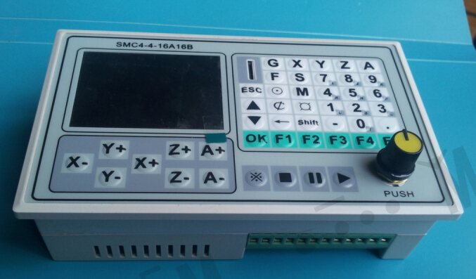

    All these controllers are stand alone, no PC, no Mach3. It seems they accept standard G code, so no special post processors. That must be proven though by practice.
    lets resume:
    -there is this controller smc4-4-16a16b . Here is the manual I looked at it but it seemed too slow for my machine. It seems most people use this one as it came earlier.
    -DDSCV1.1, 3 and 4 axis.
    I bought this one before 2 days. Mistakenly bought the 3 axis version / if sb wants that one , PM me, i will give it 20$ cheaper to you/ . Anyways, it seems on paper and from what i have seen a better choice than the previous one. When it comes at home, i will know more. I have read the MANUAl from page one to end very carefully and apart from some small questions all looks well.
