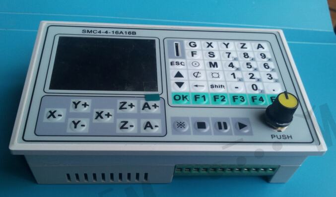

    -there is this controller smc4-4-16a16b . Here is the manual I looked at it but it seemed too slow for my machine. It seems most people use this one as it came earlier.

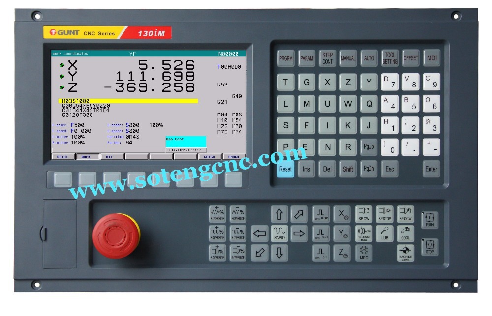

    you could find them at aliexpress using "offline cnc control" or " panel cnc" . John pointed them to me, he is playing with some 2 axis one for lathe, so he should know better #4 . I found this site http://www.cncmakers.com/cnc/control...roller_System/ where you could better see all their reincarnations.
    Now the problem here lies to find who makes them / as all sell them like they make them but that's not the case/ , the manuals and eventual support. The link above has somewhere the manuals so next step for me would be to read the manuals themselves and buy one controller.
