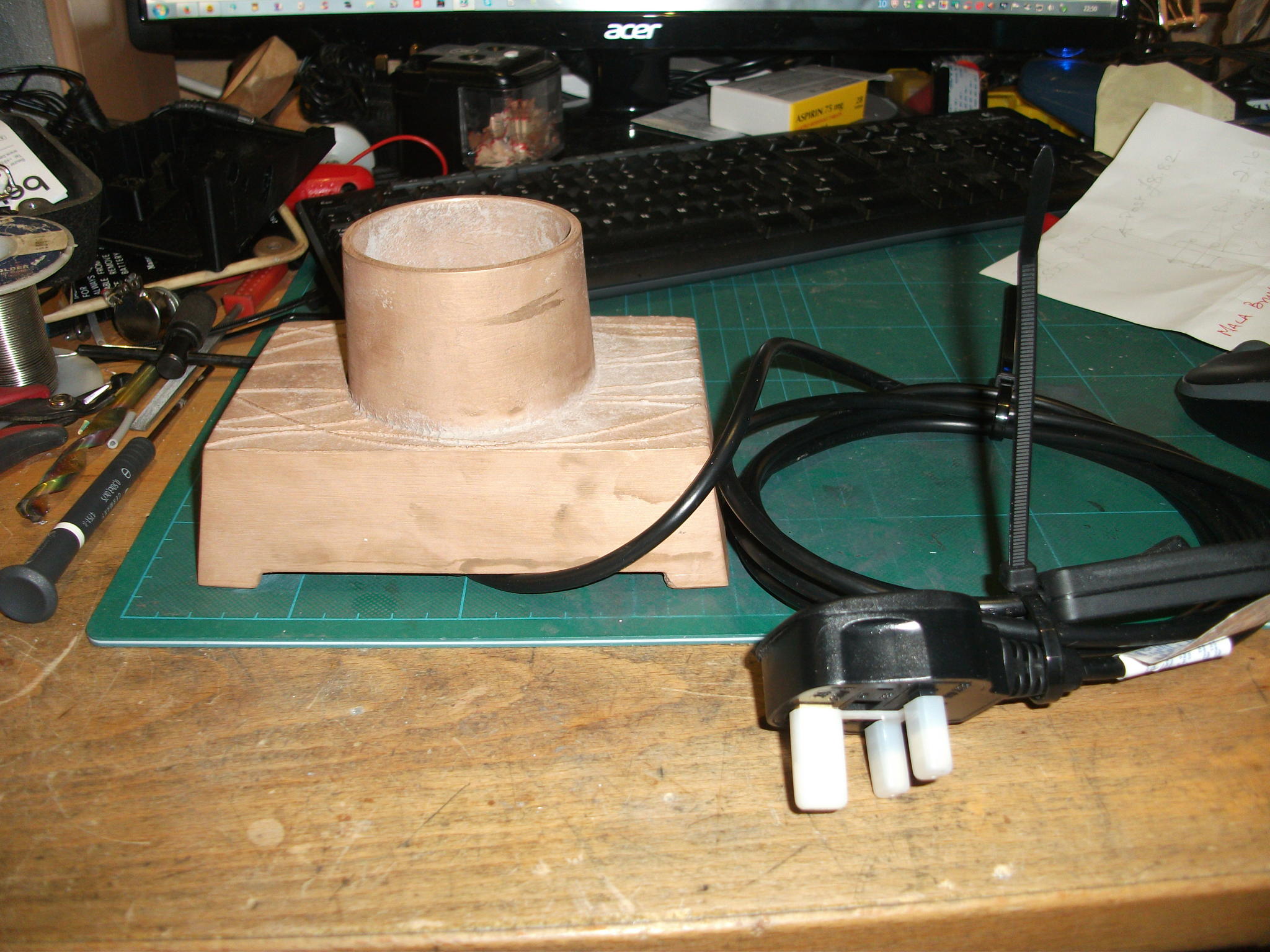

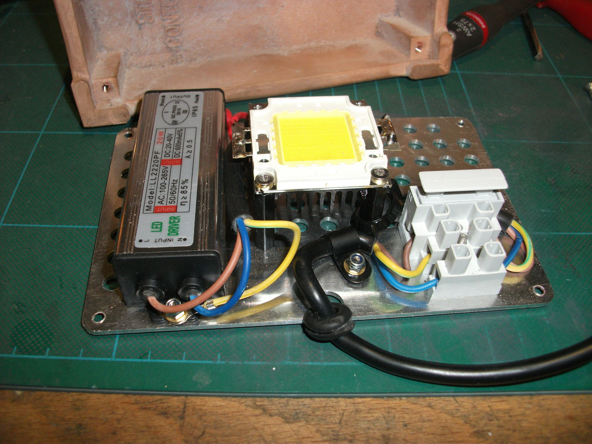

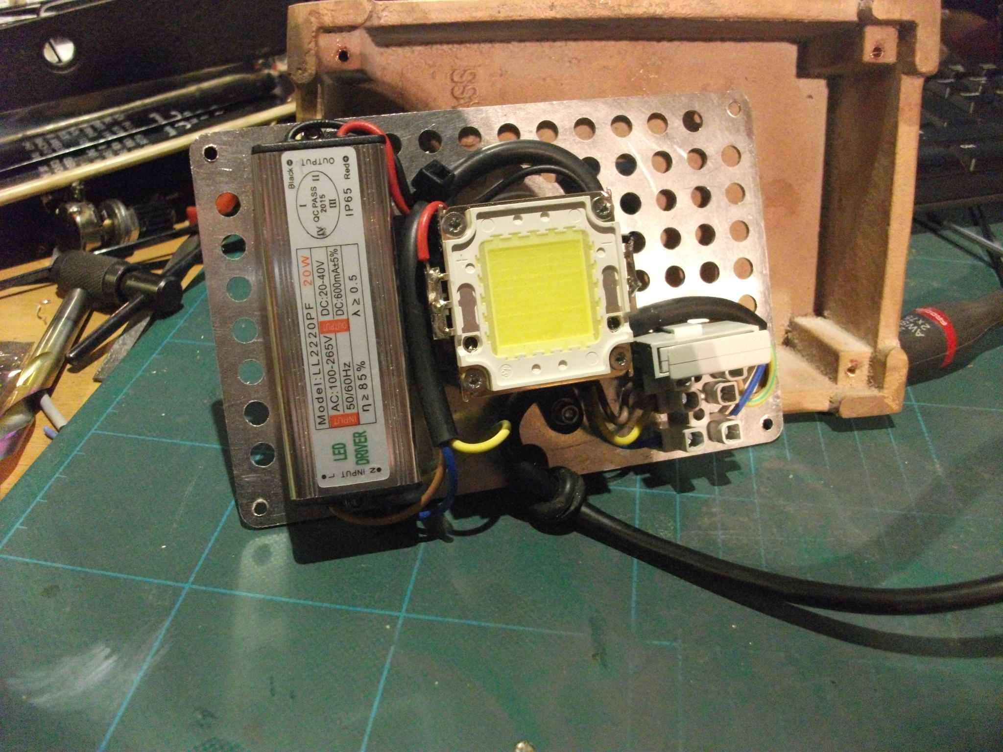

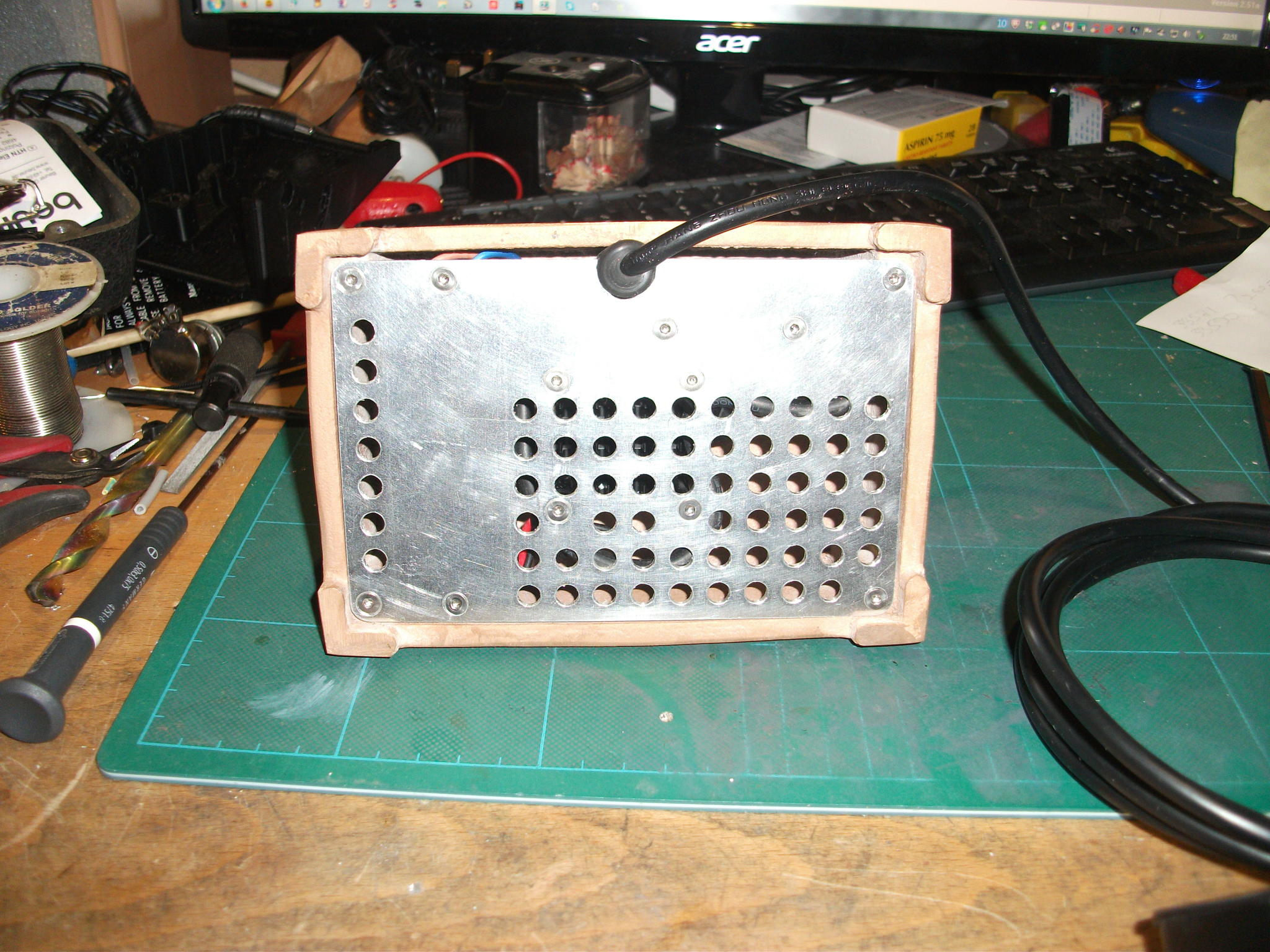

    Here's some pics of the lamp base. Don't forget that is only a prototype to test the idea out, nowhere near a finished product, so if you see anything that needs to be changed, please say.
    My desk isn't normally like that, I tidied it up to get some space to take the photos

    Having looked through the photos, I can see one thing that needs attention - the mains wires input to the driver !
    Cheers,
    Rob

    Rob I am not an expert But I would put some mica or other suitable material under the mains choc block so as to make sure no strands of wire will touch the ali base.
    You are right, the mains shrouding will have to be attended to. All things electrical have to be quadruple safe, just to protect yourself from twats. I hope the sculpture itself will be expensive enough for owners to keep brats with paper clips off it. But you k-never k-know. If people are daft enough to try and dry off a poodle in a microwave and then successfully sue because the manufacturers instructions didn't say not to, what hope is there for the intelligent world ?
