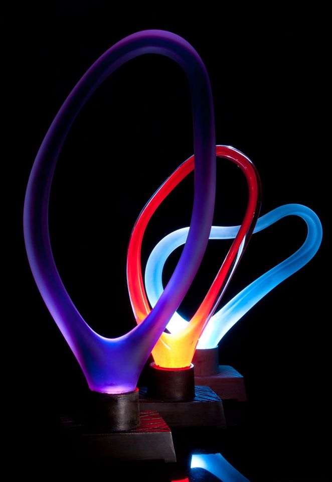

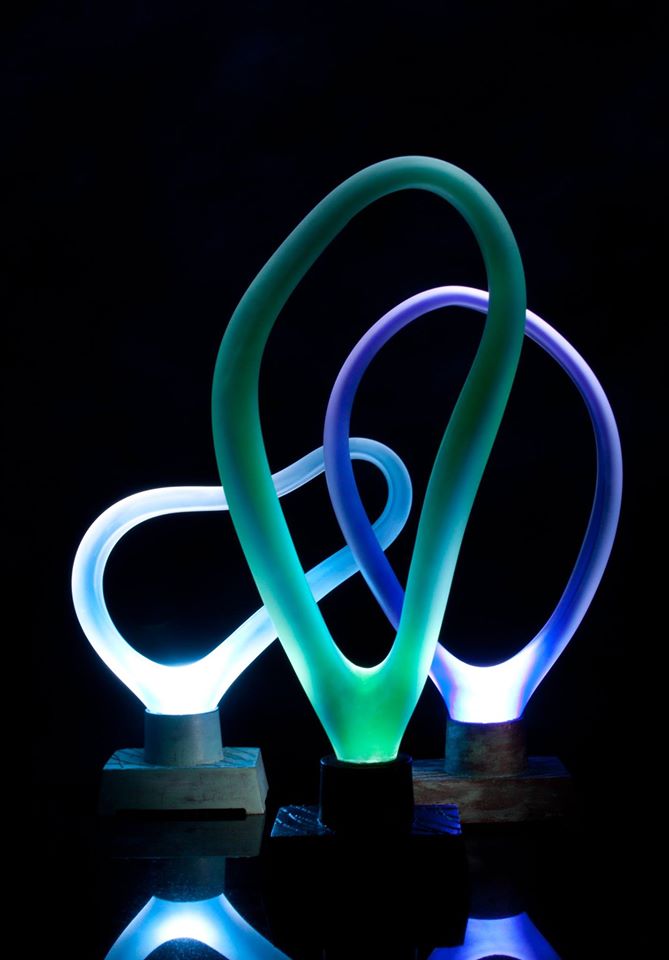

    Just to let you see the quasi end results.
ID:	19252Click image for larger version.
    We still need to pursue the external power supply idea, but these are the demo pieces for the craft fair starting tomorrow at the old Truman's Brewery, Brick Lane EC1.
    Even before the exhibition starts, we have had a lot of interest in these pieces.
