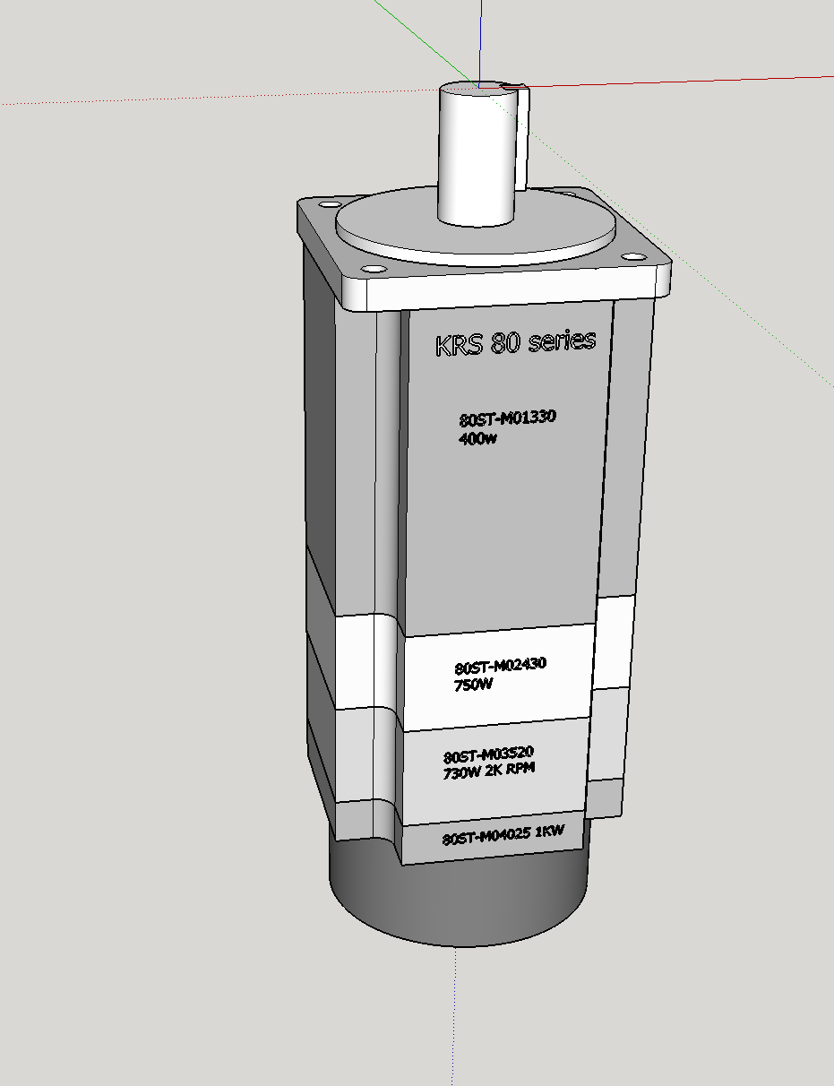

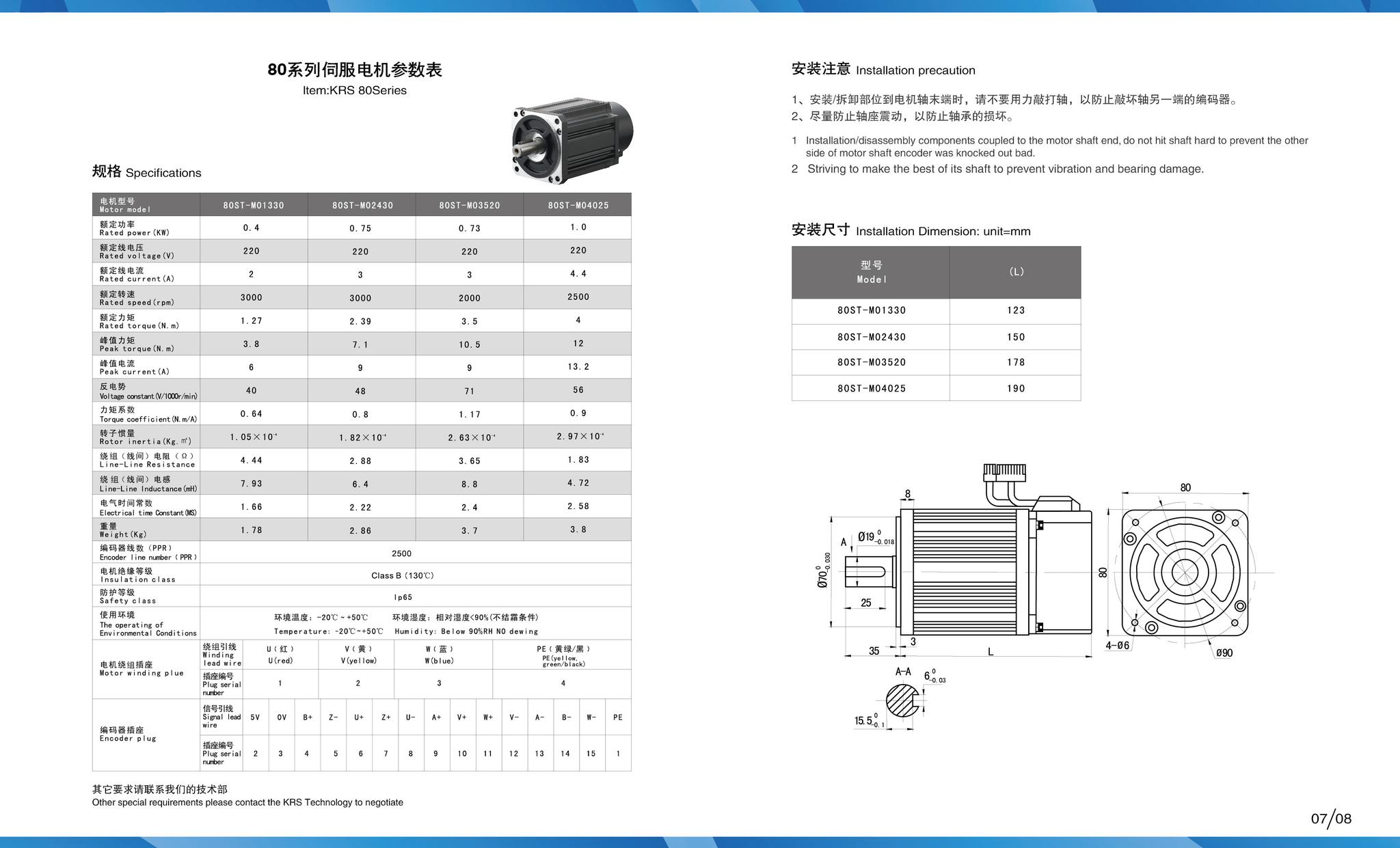

    Had to draw now for a client's machine in Sketchup , so why not post it here for all to use. This is the motors BST sell and generally the cheapest 220Vac servos.
    The round part is the encoder / not sure the exact size but judged from other servos i have. Just add or take away the parts in order to form the necessary servo motor, all else is same, only length changes. Otherwise shafts and so are correct as per specs.
    Hope that helps somebody spend the Sunday afternoon resting instead of drawing :-)
