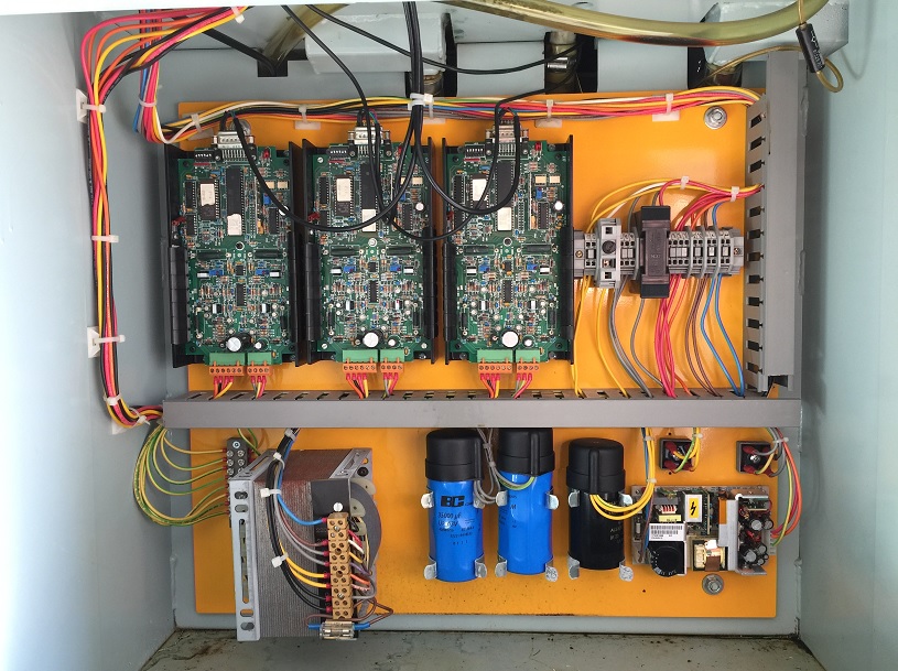

    I am about to rip out alle the electronics, steppers, spindle and PSU on my Boxford VMC300, and convert it for Mach 4 software.
    My intention is to keep the orgiginal ball screws unless somebody here had some poor experience with them.(Plan is to change the later on).
    The plan is to make use of the KL34H295-43-8A 906oz, Nema 34 stepper motors from Automation Technologies, with the KL-8070D Digital Bipolar Stepper Motor Driver-32 bit DSP Based from the same company for X/Y/Z axis.
    As i plan for a 4/5th axis cradle, i have planned the KL23H2100-50 570oz Nema 23 stepper motors from Automation Technologies, with the KL-6050 Digital Bipolar Stepper Motor Driver-32 bit DSP Based.
    570oz for the cradle might be a bit overkill, but i worry about the holding torque when the chips start flying.
    The choice is based on me having experience with only these steppers and drivers from my previous BF25 conversion to Mach 3.
    All axis will be driven by toothbelt and slightly geared.
    Originally, the VMC300 is equipped with Ametek MAE HS200-3424-0170 Nema 34 steppers at 212,4Oz/Inch(from what i can see), and SGS Thompson GS-D500A drivers delivering 5 Amps peak at 92V.
    I am also planning on replacing the origial RS520GR1000 spindle and driver to a more powerful spindle to increase the milling speed.
    PSU... Yeah right.. What to choose.
    Should i keep it at 24V industry standard to reduce possible noise, or increase it to 36, 48 or even higher?

    Budget? That will guide what you do with the machine.
    If you can afford it, get the CS Labs IP-S unit and go from there. Its not cheap but it is better than your average parallel port option and you can use newer hardware as the CS Labs is connected via a TCP/IP network, not directly with the port itself.
    24V is good, its been the standard on my Denford and my Emco CNC lathe. CS Labs is also 24V for the logic / power.
    You can take a number of inputs / outputs into and out of the CS Labs unit to allow you to then control the ATC via macro / code in Mach 3/4.

  12. #10
    Or you could be our guinea pig and try one of the standalone 3- 4 axis chinese controllers. I will point you from where and which one exactly, if interested. Around 500-600 euro. means 300 euro cheaper than CSMIO and mach4 is another 200. I will buy it off if you are not happy. Just i don't have physical time to do all i want to, and one of these things is test said controller.
    Boyan That's little out of order to me and not very good advise for someone who's stated got no experience and who's wanting to convert a mill with full ATC.
    The work involved just for the ATC is enough to make experienced user shy away and that's with mach3/4. So with Chinese controller that very few people know anything about with Chinglish manual that's about clear as mud isn't some thing I'd be recommending any new user to get into.!
    Proteus you need to think long and hard how your going to tackle this and what hardware your going to use other wise you could cripple or spoil very nice machine.
    Don't let all this talk about Offline controllers scare you away from PC based controllers because they work fine and have massive user base which can help you no end. Esp with bespoke ATC setups etc.
    The same can't be said for the offline controllers and the jury is still out and will be for very long time untill they become more common.
    Also I'm pretty sure they won't be simple to setup for anything but basic ATC setup. You will be required to write macros or learn some form of ladder logic for more complex ATC.
    The same is true for Mach3 or Linux etc but with the difference that many have already done it or will be able to assist with macros etc.
    Good luck.
