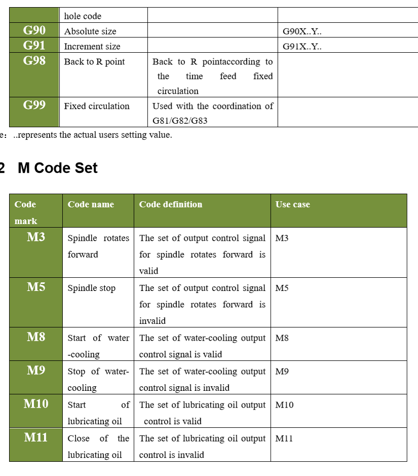

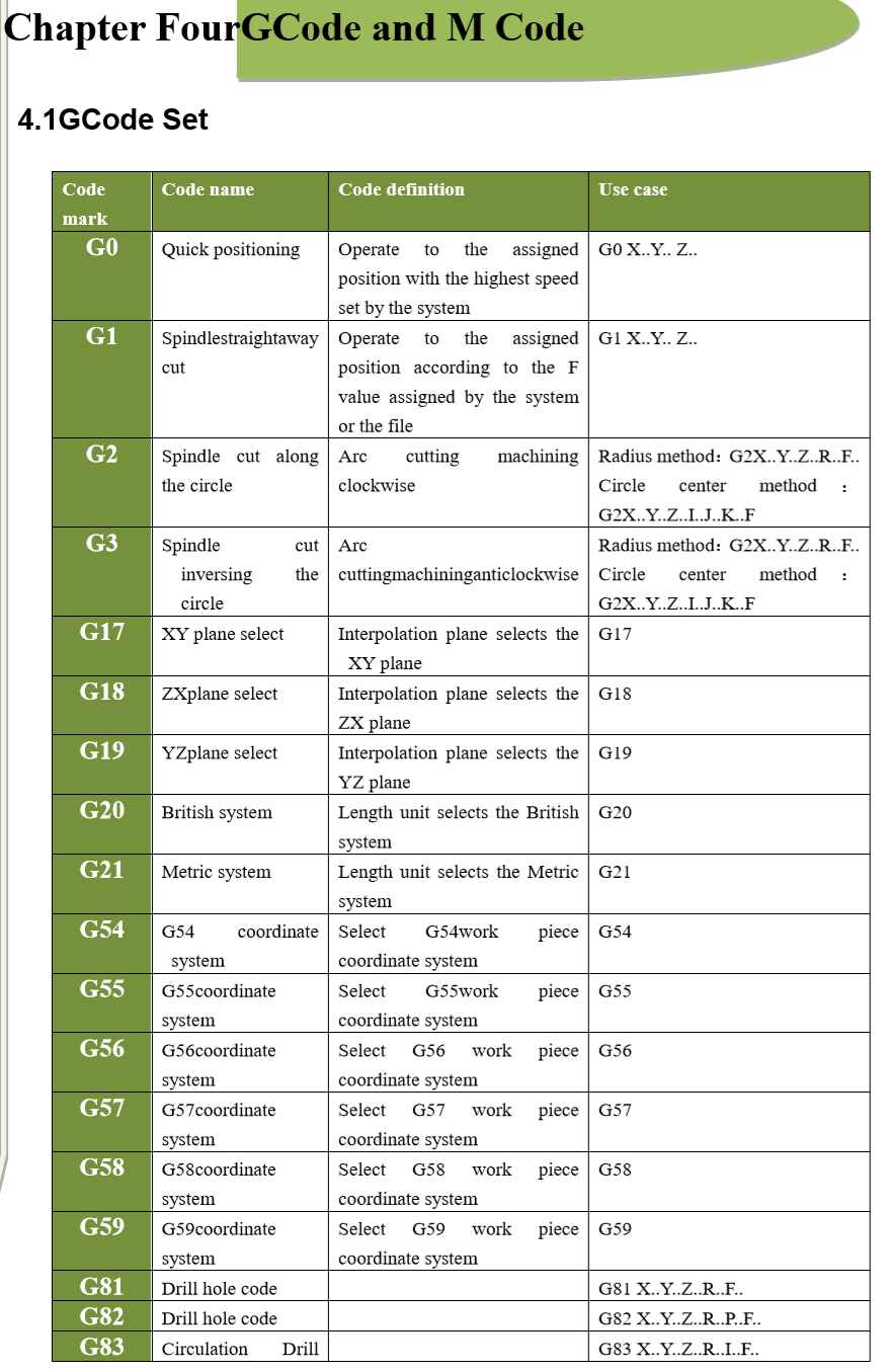

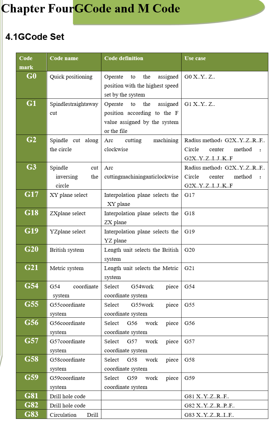

    funny, i see now that it supports G20 and G21 but when i was testing it ?, so maybe i made a mistake somehow with the file. Will check again
    That's what it supports.
