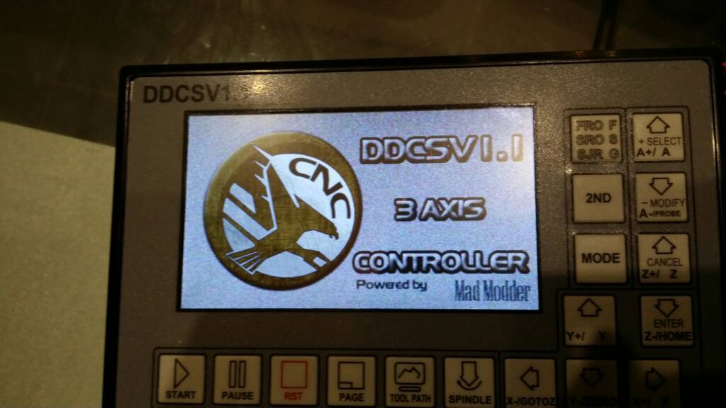

    What about this one guys? Soon this controller will have a new look and setup!! (this is just a quick screen to try the colorsClick image for larger version.

    You've replaced a graphic with an alternative graphic?
    That's "Modding" alright!
