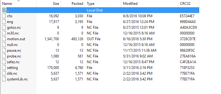

    I have 2. The one on the controller i got from Joules, i have one also directly from the manufacturer/ ok, from the agent who contacted the manufacturer for me/. If it can help i will send it to you. That was obtained 2-3 weeks ago.

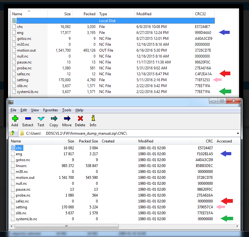

    Hi Boyan, thanks for the file information. It seems that your 4 axis files (most likely located in the /mnt/nand1_1 folder) seem to differ slightly from the ones I've found on MadModder member Benedikt M's firmware dump collection. Especially the files "safez.nc" and "systemLib.nc" seem to have some content in them, in the dumps I've seen these files are empty. Also the translation file "eng" and the "setting" file seem to have a different content, based on the different CRC checksum.
    I guess you might want to send both your 4 axis software install packages to Benedikt, it would be extremely interesting to see the content of the differing files! And to see if there's any chance to upgrade the 3 axis box to having one more useful axis... :)
