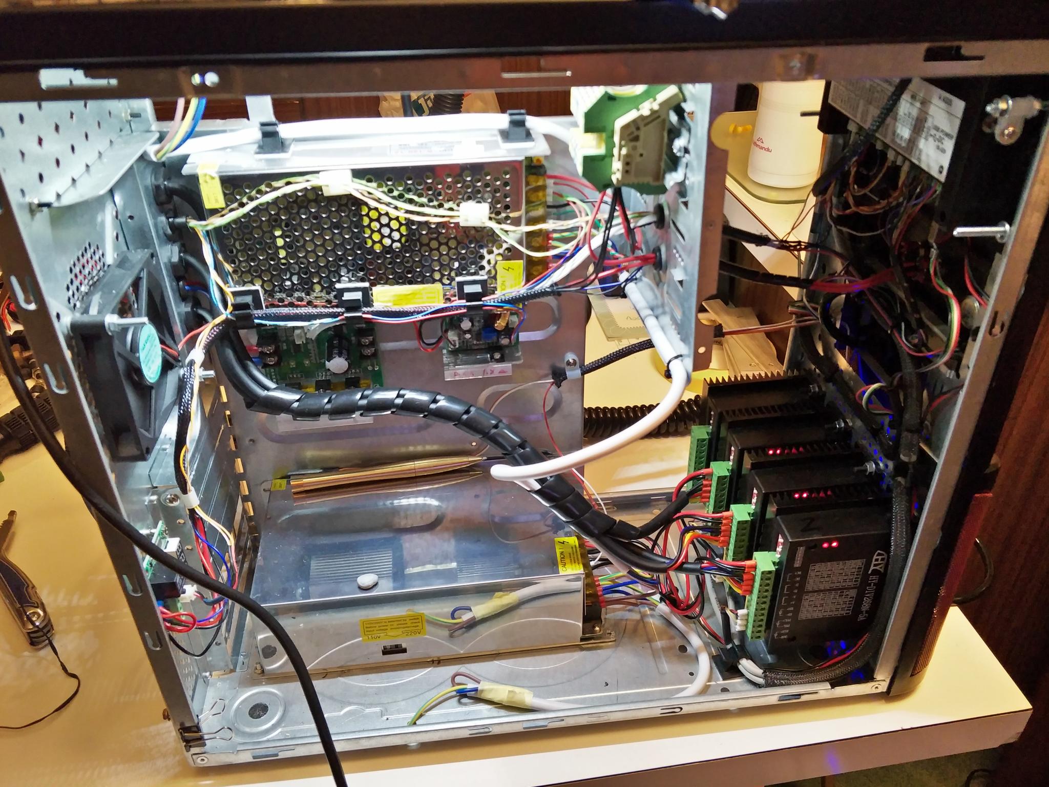

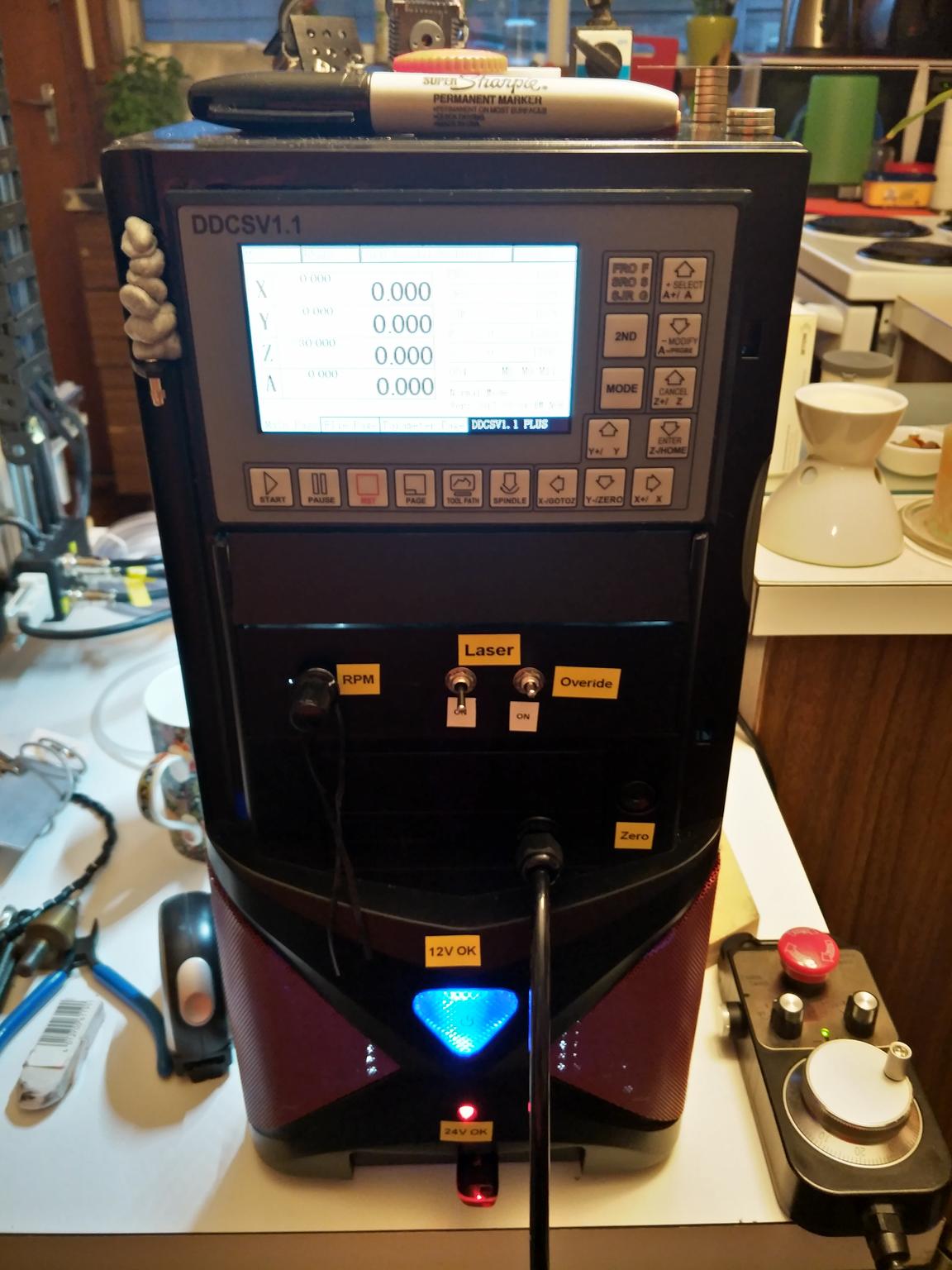

    Been working on this for a few months now. Trying to find a nice way to mount the controller. Didn't come up to bad albeit with a few mods to the PC case.
    There's one more power supply to go in for the spindle motor.
    Once that's done i'll be up and running :)

    Not bad. Very nice!
    What drives are that? Do you have cooler in front of enclosure near them ? Or just the enclosure other coolers?
    project 1 , 2, Dust Shoe ...
    Thanks Boyan,
    The drivers are just generic Chinese brand set to half step.
    At the moment i only have one fan at the rear blowing in... i will replace this with a bigger fan soon and would like to use some smaller ones near the drivers. This is still a work in progress.
