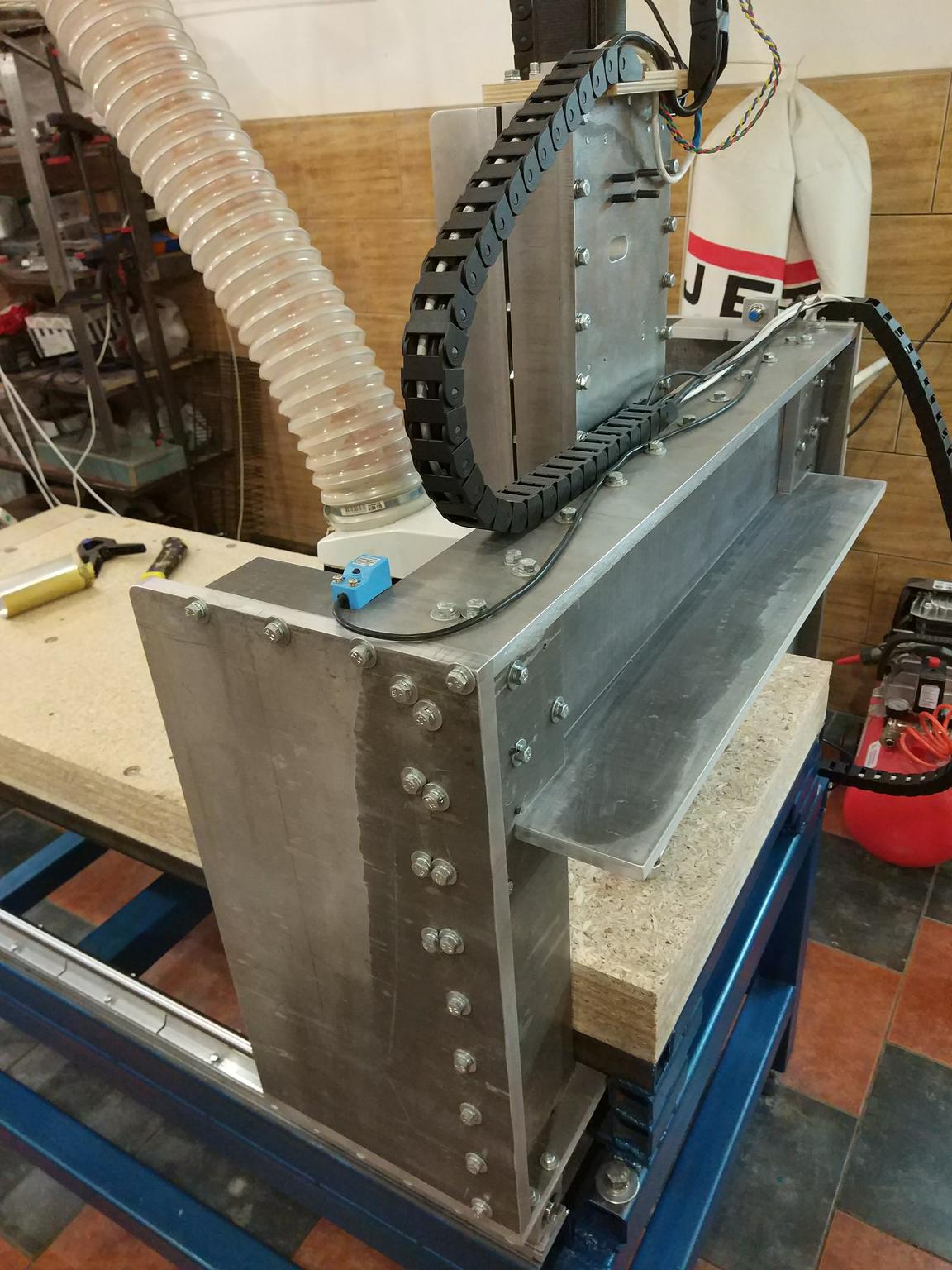

  2. Click image for larger version.
    Here on this machine I have a problem with the perpendicularity of the x and y axes. On some tasks this did not suit me. I solved the question in a minute, in the mach3. And with the utmost precision. I do not imagine how much time I would have spent on the alteration in order to achieve the desired perpendicularity of the x and y axes.

    Does the controller in question handle master and slave drives on a single axis? Can it use a homing switch on each of these with defined offsets to allow the gantry to be re-squared each time you home it? That seems like a better approach which allows for the possibility that the perpendicularity is not built-in when you have a moving gantry with separately-driven ends. I agree that the ideal, and certainly in the case of milling machines rather than routers you would expect X and Y axes (and Z, of course) to be built perpendicular.

    I prefer an extra day to solve the perpendicularity of my machine, that to mess with the software. After all i spent 1 week mounting the 3m long square rails on my machine and had to dismount them a couple of times to correct parallelism. Not to speak of the 3 times pouring epoxy until i learned to control 100% the process . Each pour was around 150euros in epoxy.
    That was solving the parallelism. But perpendicularity? i would say all i mount is less than 0.01mm in perpendicularity. Facts speak that i did not have to tram spindle at all when i finished my machine, no need for dial indicator after mounting all just using some thinking, straight edge and 2 precision squares.
    I have to check the manuals of the expensive chinese controllers. But i doubt that, as any would expect from a milling machine to be build 0.000 not 0.00 straight
