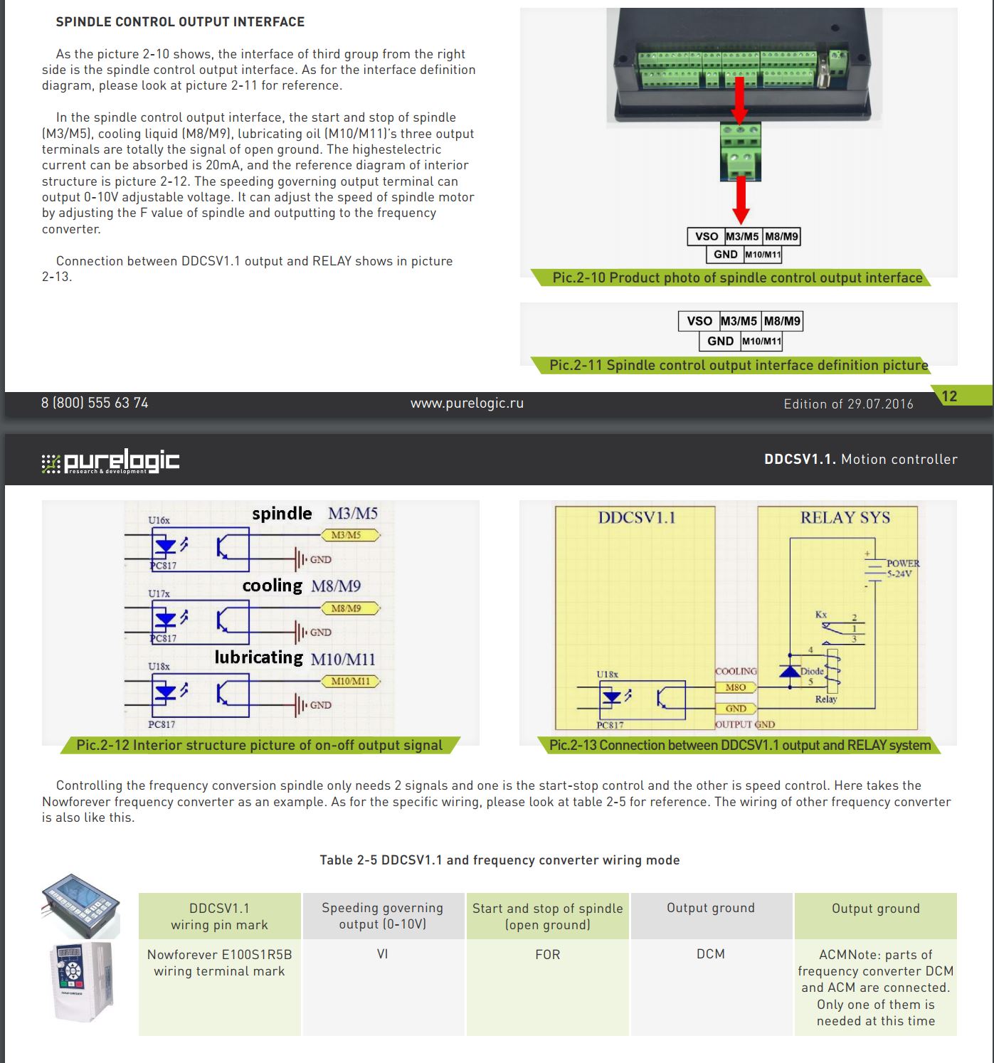

    Ok i am really struggling to get my DDCSV1.1 to activate my spindle Via the Huanyang VFD, has anyone on here already done this successfully? I'm not sure on, and cannot seem to find any information about what signal the VFD is expecting on the FOR terminal in order to engage the spindle.
    Any help would be greatly appreciated.
    Alex
    I think all is self explaining from manual:
Name:	Spindle connect.JPG
    Only 3 cables you need. Ground is connected in the VFD as far as i remember

    Yes i figured it out. You have to wire it as the manual, however the VFD is slightly strange as you have to ground both the ACM & DCM (Analogue & Digital Grounds) to each other. A bizarre occurrence to me, not sure what the Chinese logic is behind it but it works. I can now control the M3/M5 commands and set the speed from the DDCSV1.1.
