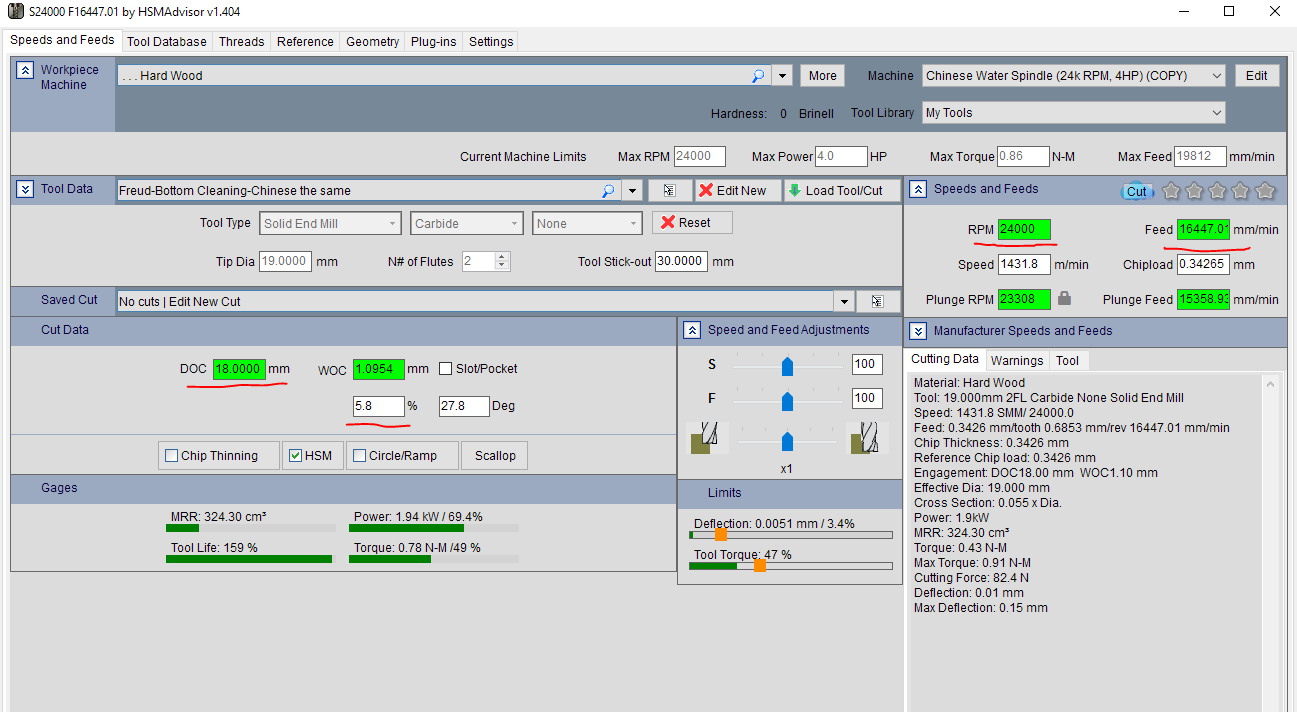

    Hi folks,
    Today i managed to make a short video of very interesting combination. DIY CNC +ESTL CAM trochoidal path + HSMAdvisor + DDSCV1.1 motion controller .
    Mind me that it's first the time ever i use trochoidal toolpath, am testing the vacuum fixture and the board at the same time. So i was a bit afraid and limited the plunge rate, so i could react, cause i had the camera at my left hand. Thats why at the moment of entering the program i was trying to make sure i do not make a mistake.
    All was perfectly calculated by HSMAdviser and executed by ETSL Cam. Thumbs up to the makers of these 2 programs. Look at that nice chips. So CAM +motion control here together cost less than 200 euro. At the moment ESTL cam starts showing properly the toolpaths as a list - as any normal program, I will be extremely happy to say:" Why pay more for Vectric?" . Even so its an excellent program. If only for the V carving and the Trochoidal toolpaths.
    So i am more than happy. Freud 2 flute 19mm bit, 11mm depth pocket, then full depth 19mm profile . Both at 16000mm/min feed 5.8% or 27.8% degrees HSM width of cut
    I was really excited to see the machine move and cut so smoothly at 16000mm/min, i dont know if you will get to feel it from the video, but it was super smooth. Mass of gantry is around 200kg!
    OK. here is the video. I show how the board copes with probing also. Lower the volume and enjoy, when you feel bored from watching the pocketing, at min 7:15 start the slotting at full depth:
