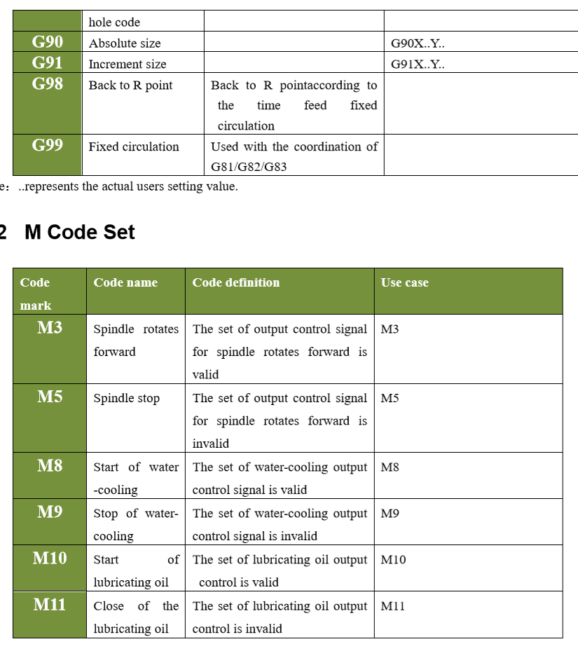

    That's the big question before jumping to conclusions
    What i found till now:
    - Post processor for mach3 definitely does not work, as you could see in second video it runs away from the job coordinates. Who cares, me not. I could save my programs again in the proper format
    -It doe not recognise manual tool change code also. So jobs have to be split. Not big deal
    -Does not recognise G20 and G21, so program must be in mm to begin with. No problem so far.
    -Will run properly G code as of the Gcode and fanuc output from Aspire. Though program was simple. / See video2/ .
    As i have not connected it yet to a machine i can not say more. But there is a good chance that all goes fine.
    project 1 , 2, Dust Shoe ...
    Does it support a Tool Changer/Turret etc. ?
    This is a basic controller. The much more expensive Chinese controllers not only do all but close the loop also, at least the most expensive ones, which makes them really industrial
    funny, i see now that it supports G20 and G21 but when i was testing it ?, so maybe i made a mistake somehow with the file. Will check again
    That's what it supports.
