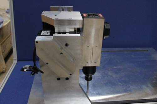

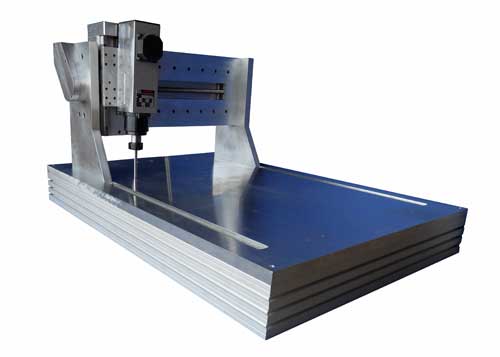

    This is an image of the machine as we are offering it at the moment, but this is the bare-bones option with a lot of other options available, like axis covers, hood, mist, cold-air cooling, flood, atc and so on.
ID:	18719Click image for larger version.
ID:	18720Click image for larger version.

    Ok, so this is the specification.
    Model 10060
    Work areas X/Y/Z (mm) 600mm / 320mm* / 115mm (400mm without covers)
    Bench clamping area W × D (mm) 590mm x 1000mm
    Space under Gantry (mm) 124mm
    Machine Dimensions WxLxH (mm) 745mmx 1060mm x 600mm
    Linear rail types Precision grade profiled rails on all axis (20mm on X and 15 on Y and Z)
    Processing speed X/Y/Z max. 800mm/min*
    Repeat accuracy (mm) ± 0,01*
    Drive motors Stepper motors, Closed Loop Stepper motors or AC Servo motors
    Drive elements X/Y/Z C5 Ballscrews or C3 Ground.
    Controller CSMIO Motion Controller working With Mach3 or Planet CNC or Eding CNC.
    Weight (kg) approx. 200 KG
    Software Needed Mach 3/4, PlanetCNC or Eding CNC
    * Depending on options selected
    Options
    • Mist system or cold air gun options.
    • Selection of spindle motors including ATC, Air cooled spindles and 80mm round.
    • Tool height sensor
    • Servo or stepper motor systems.
    • C5 ballscrew as standard with options of C3.
    • T-slot table for easy of clamping of workpieces.
    • Vacuum bed.
    • Concertina bellows for added protection.
    • Available with or without hood.
    I know a lot of people like a long Z axis but we have decided to go for something that gives you about 115mm to keep the rigidity to the best we can, and i would also point out that over the months that we have used it, we have never needed anything more.
    The X axis has two ballscrews (R1610) and 20mm profiled rails, the Y axis has a single ballscrew and 15mm profiled rails and the Z axis has R1404 ballscrew and 15mm profiled rails.
    all of the ballscrews are C5 and the profiled rails are precision class. We also have concertina bellow covers for the Y and Z axis and are working on a cover system for X axis, but this axis is already quite protected because all of the linear motion parts are under the machine.

    Don't know what you mean.! . . . Need to see more before passing comment but looks ok so far. BUT then we need to know the all important £££££.

    Well it's seems lot of money for self assembly KIT that still requires belts, motors, drives etc but got say it's very well spec'd and on first inspection looks capable machine. I see things that wouldn't consider ideal but nothing too serious. For first attempt then Gary and lads look to have done a good job. .
  10. I knew price would be the first thing that same up, but with all things they can be refined. The issue is setting the price right when there is not a lot on the market to the same specifications. We have not skimped on anything and all the linear motion parts are high end to get the specifications we wanted to achieve.
  11. Jazz, if you see something that is not ideal point it out.
    I want to know so if it is possible we can change things.
