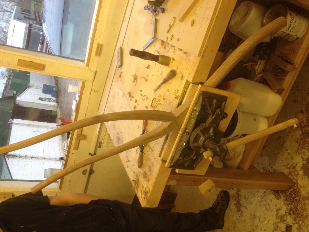

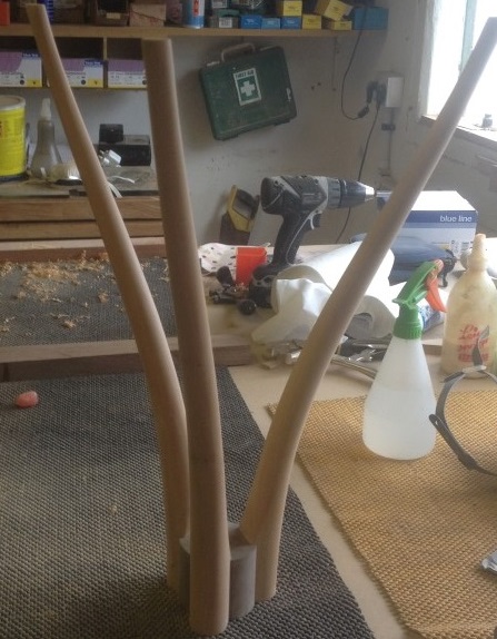

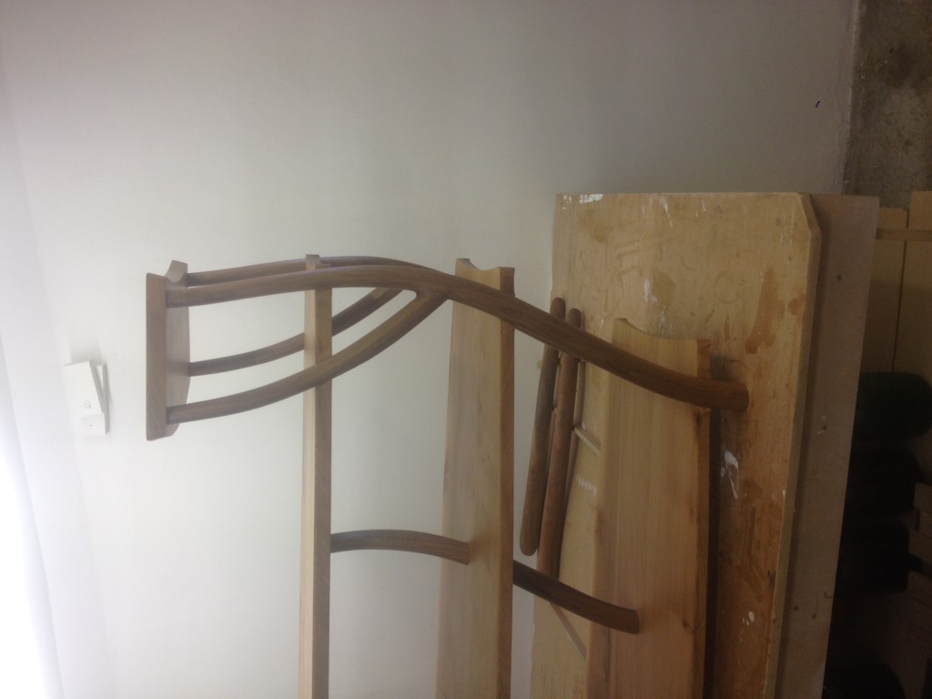

    Some of the 3D parts I would like to machine.Click image for larger version.
Name:	IMG_3886 (Medium).JPG
ID:	22807Click image for larger version.
Name:	IMG_3837 (Medium).JPG
ID:	22808Click image for larger version.
Name:	IMG_3967 (Medium).JPG

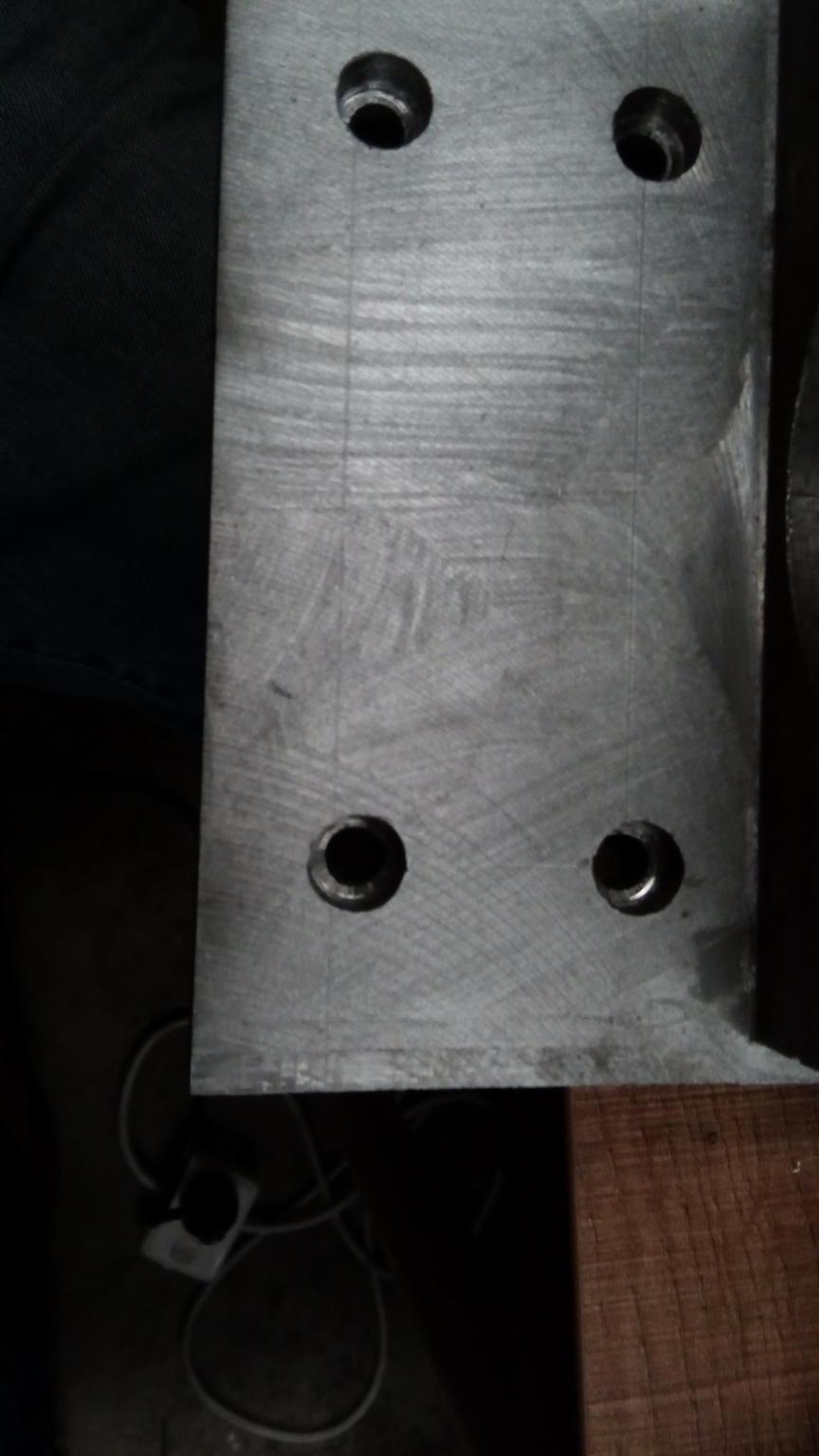

    and then it will still probably have a twist in the frame and nothing will be trammed so you will have to take it apart and try and figure out how to fix it and that's before starting on redoing the electronics. I battled with some ones china cnc for 6mths over in aus, in the end I gave up trying to fix it and just accepted it for what it was and that you couldn't really do any of any size with any accuracy. I mean when you see holes drilled like this on the spindle mount what can you expect. Click image for larger version.
