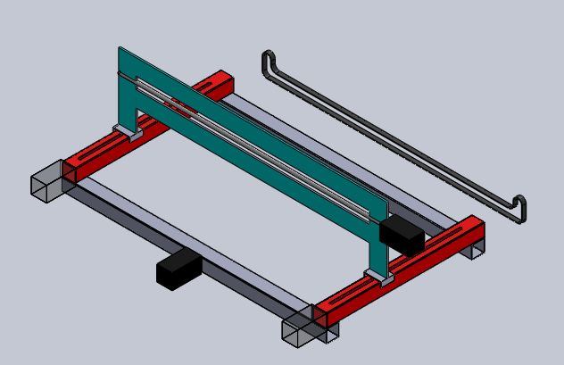

    Don't use twin motors drive the screws with belt drive connecting them together. Saves on money and much more reliable, completely removes any chance of racking.

    your suggestion on the belt driven x axis is interesting, didnt really consider this becuse im afraid of getting it wrapped around my fingers or even my face! also the design scope doesnt allow for this unless i change direction using pulleys at 90degrees directly below the screws which incidently will take care of the belt timing.

    Regards fitting then can't say unless you show the design. Not sure what your meaning or thinking by belt timing.? There is no timing invloved.

    yeah your right jazz, its hard to visualize your dead right there, so im gonna get some drawing program and get it down on paper.
    looking at your recommendations has given me a bit of a reality check, its gonna cost more than 50 bucks and a few lengths of steel anit it!!!
    well someone gotta keep them in business.
    drawings to follow up........
    soon........
    ish........

  8. #6
    how do i get this picture big enough to see???????????
