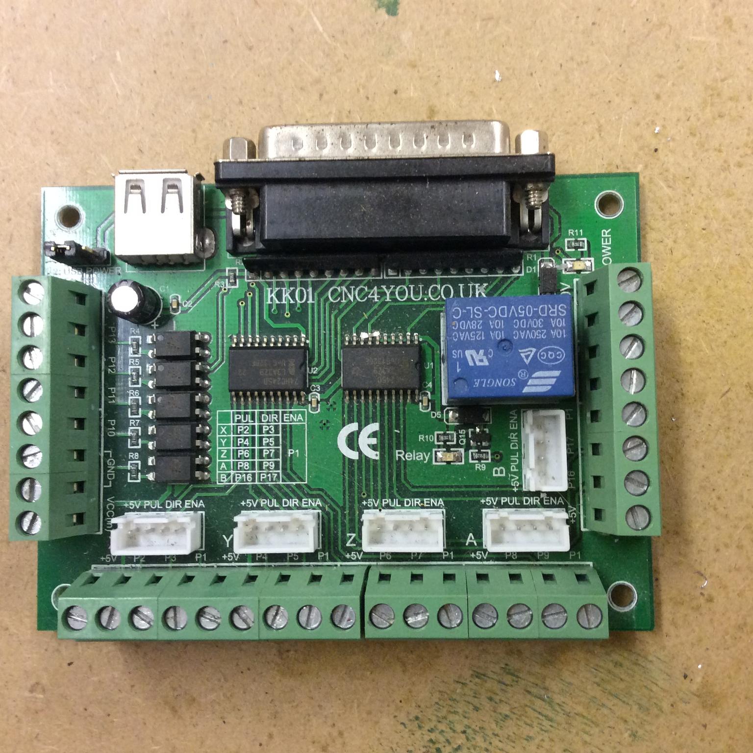

    i also have a number of other bits, off a machine I am refurbishing, with guidance from Dean. I am basically replacing the controllers and motor drivers, I have 3 gecko G201x drivers and some cnc4you controllers if anyone's interested to.

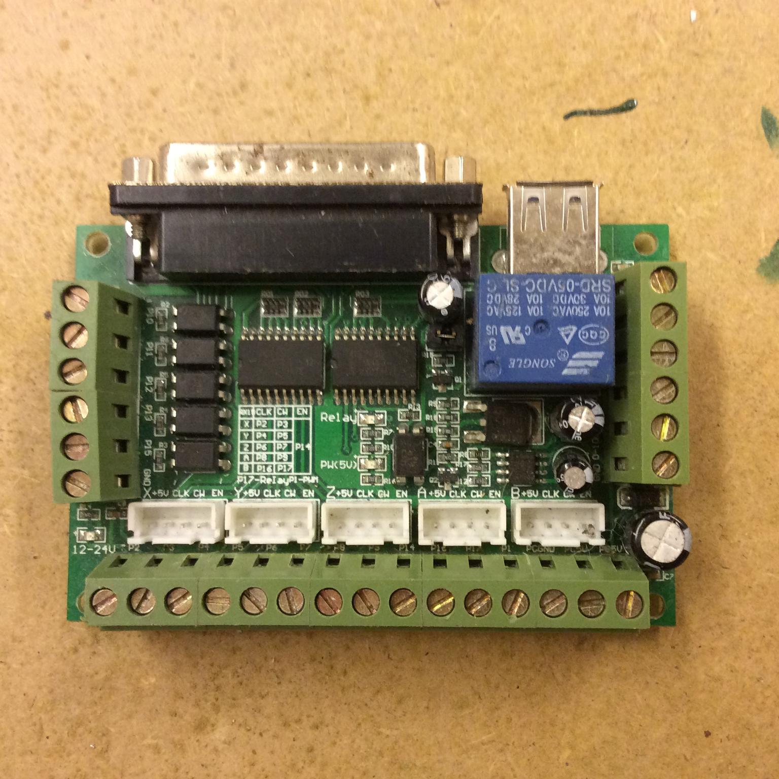

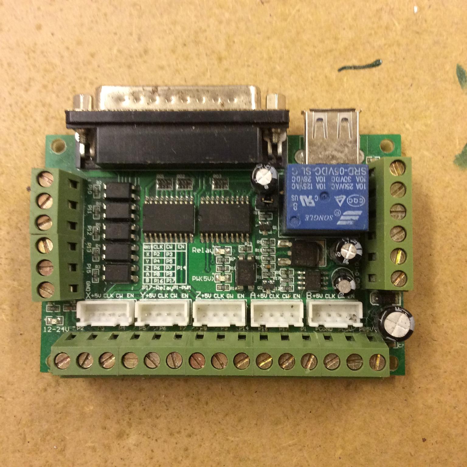

ID:	19372Yes I still have the boards, see pics attached. Price say - 50% of price new including postage, so £16 for the cnc4you one, and £5 for the mach3 interface board. PM me details if interested.
