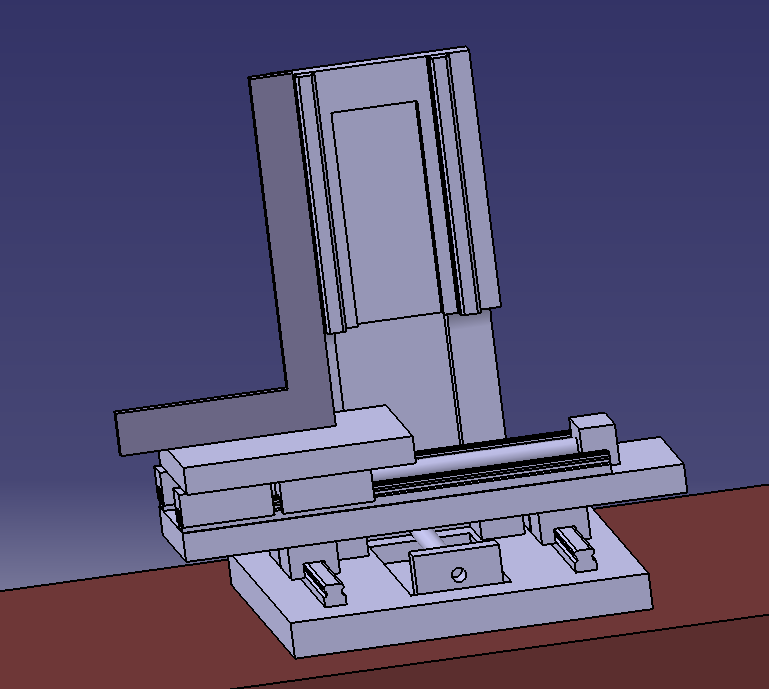

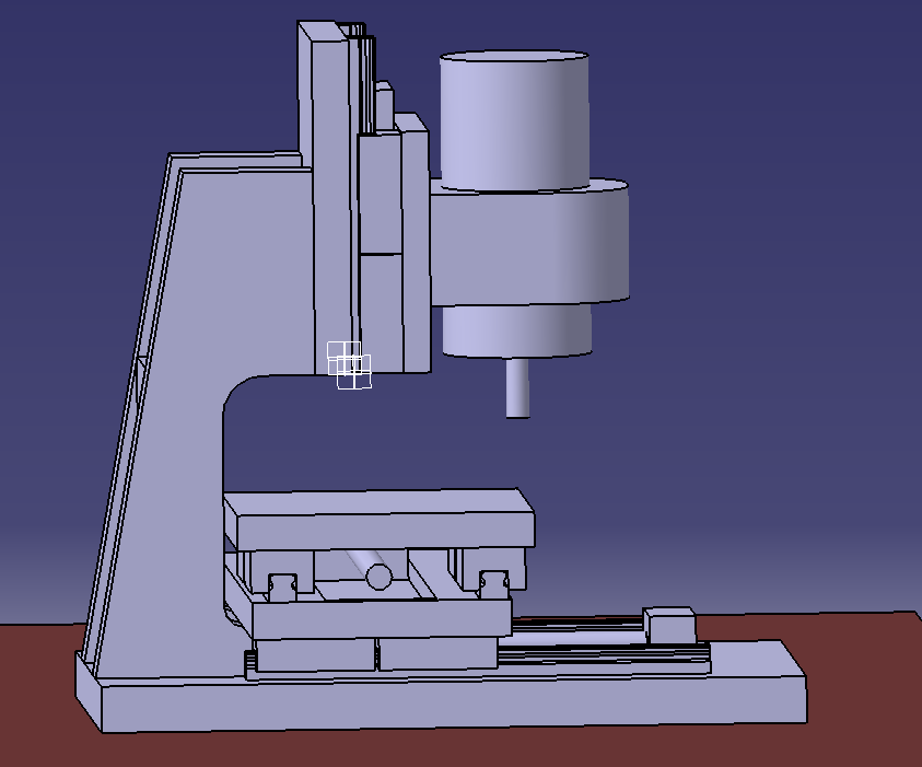

    Hello everyone,
    Most of the projects i have seen here are mobile gantry so i guess my machine will be uncommon due to the small size. I am completly a begineer so feel free to shout me if you notice something shamefully wrong, i appreciate any advice.
    I wanted to build a machine for 3D work, mostly propellers and parts of small RC planes ,and maybe jewlery and engraving. So these are the constrains and requirements :
    -Small cutting forces due low deep steps(400-800w spindle) ,
    -High accuracy and no backlash
    -Not any speed/aceleration requirement, not a problem if a job takes 8h or 20h .
    -Weight that allow to move it with the table (no frame, clamped on table) withouth a lift machine or disassembly the stages.
    -Arround 170x120x52 mm workspace
    -Easy alignement or low amount of tooling required

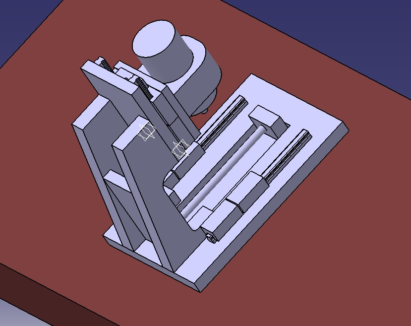

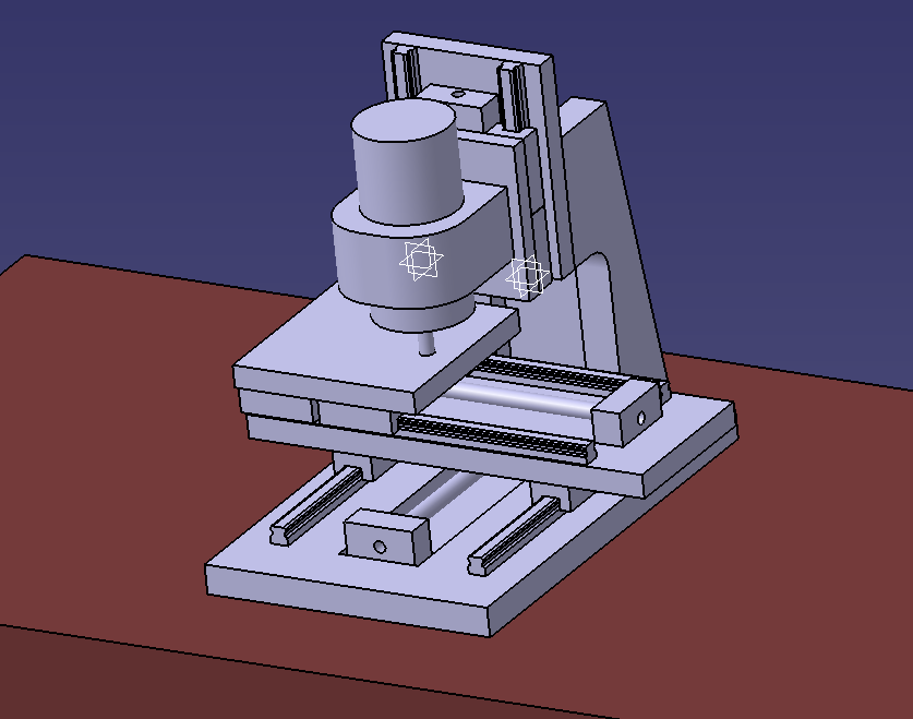

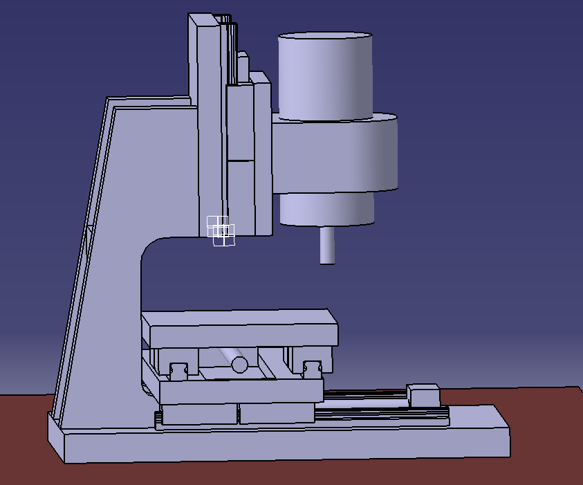

    This is the preliminary design (although the aluminum of the plates of the Z column is not ideal due to the fatigue problems of bending in a few years, my concern is more about the rigidity of the design ):
ID:	19254Click image for larger version.

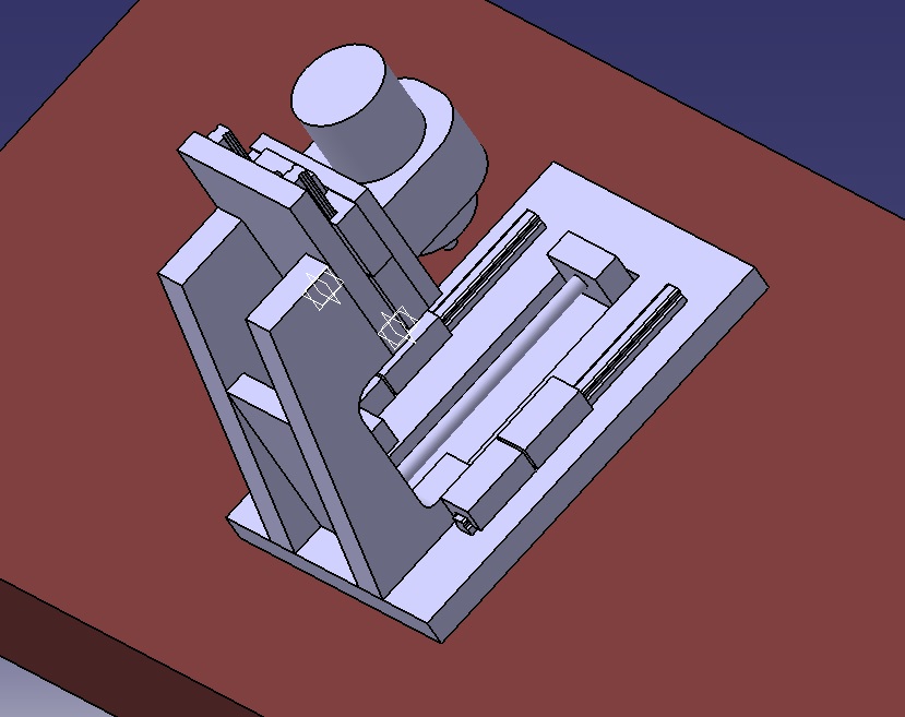

    It has profiled rails Hiwin HGH15 , and ballscrews 1402 or 1605 L160/250/300mm, Nema23 , both ends fixed although i didnīt draw because i still have to choose the exact end fixing, nuts, motor support, pocket dimensions etc... But the thickness of the plates of the column is 30mm and the basement of x stage 25mm, total weight arround 25-30 kg withouth motors/spindle.
    I have some doubts about the alignement of the stages:

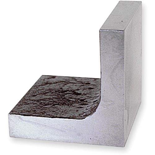

    -For the X and Y squareness i found a video that does the same steps i am going to follow https://www.youtube.com/watch?v=UETVKpmWTL0
    My idea using a combination of machinist square and gauge block to square the X rail to de Y plate, instead of the ground angle plate he is using because it doesnīt seem to me enough accurate those that i have found.

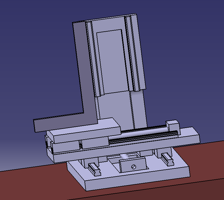

    -For the Y and Z squareness i have thought this, and i wonder i the machinist square is enough straight to alignement of the rail as a straight edge
    HI Yasu,
    My advice:
    -use 800w water cooled spindle, it won't waste too much electricity and is powerful enough for serious aluminum jobs. Even steel with miniature bits.

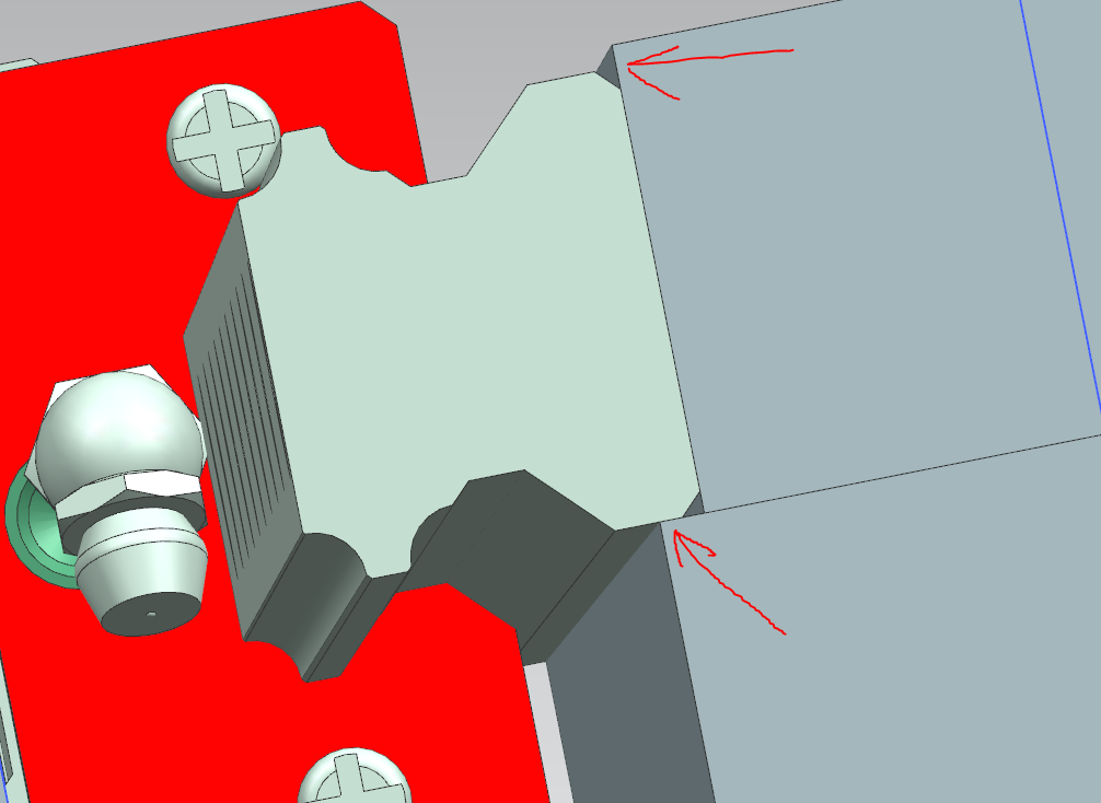

    -if i am to machine the parts, as we spoke in PM , better design it so that the rails are say 2mm deep in a channel which is wider 2mm than rail. So when i machine all parts, you will not even need a square, cause you could align the rails to the edge of channel. Just check how deep they must be so nothing interferes / the carriage/ and have in mind the edge is beveled so check that out too, for the depth i mean.
    Also when you draw the holes have in mind how rails are cut / both end equal spacing to first hole/
    By the way i have somewhere here 2 aluminum mounts for the 800w spindle.
    Thats what im refering to:

    Thats a great idea. I have intention to order some tooling that i could use for part of the alignement like a dial test indicator of 0.002mm and a precision machinist square but this simplifies the alignement by a lot.
    But i have more doubts now. It wouldnīt be more hard to machining all these channels edges to tight tolerances of straighness same as a straight grounded edge?
    Another question is what happen if a channel is a bit higher even if is 0.01-0.02, could it cause tilt? or it is removed by machining the sacrificial surface the the machine is assemblied?
    The x and y alignement i have clear now but the z alignement not so clear.
    I have seen a method of how a DTI is placed on the spindle and with the readings there are some shims put on the z plate to alignement. That way is it relevant that the column of the Z axis had to be machining to square tolerances and also the base plate to surface tolerance where it sits to have paralelism with the surface where it sits the rails? or it doesnīt matter and is just shimmed later?

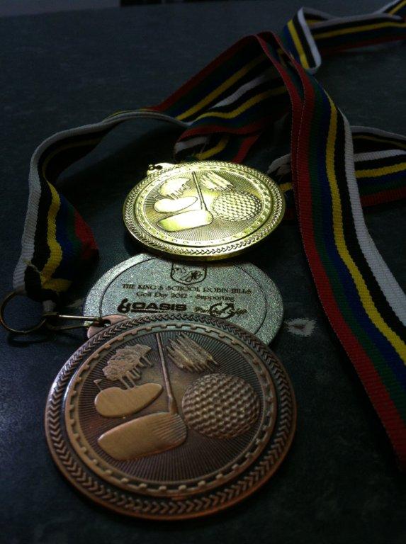

    For engraving and 3D small propeller parts
Name:	Golf Medals email.jpg
ID:	19328Click image for larger version.
    On my CAM simulations the surface finishing of the propeller to be accurate needs like 0.01-0.02 mm of resolution
    Those are some jobs i would perform

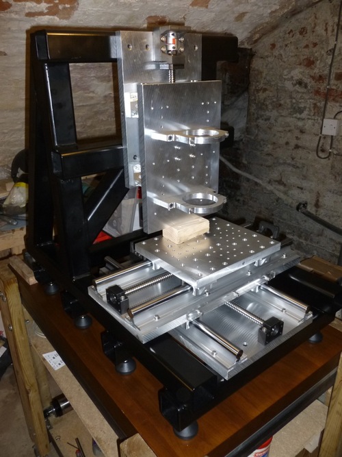

    Sounds like a cool build. I made something similar, but you're starting from a better place by opting for the profile rails (I used the TBR20 supported rails). Here's a 3D vis of what mine looks like:
    ...and a pic of how the stages looked before the build was finished:

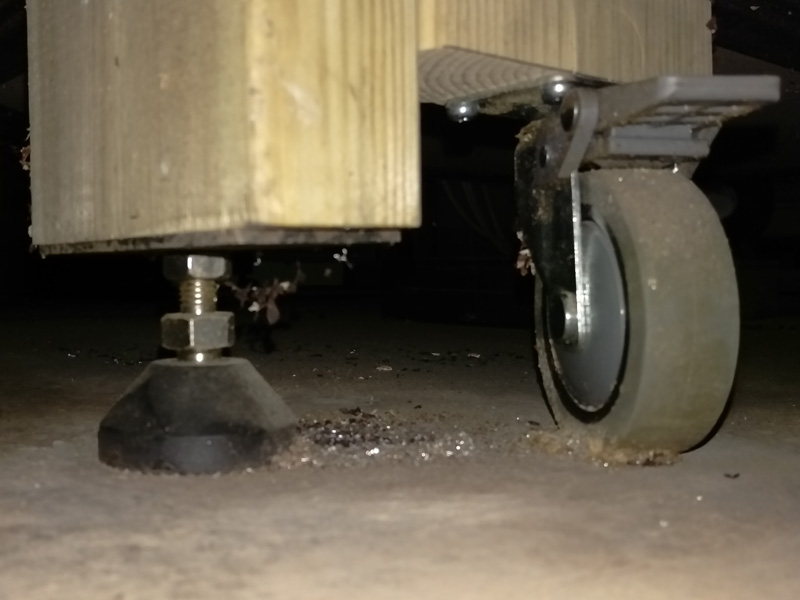

    As you can see, I used 20mm eco-cast plate (this means that it was machined flat and the surfaces were parallel) which was bolted to a welded box section (60x60x5mm) frame and yep, the 'squareness' was shimmed in. Compared to some of the master-pieces that have been built by folks on here my build's a bit agricultural, but hey, I had to start somewhere!
    What I will say to you at this early stage (and it might not matter to you) is that you could buy yourself a slightly larger work-space by swapping your machine table (the bit that you fix the work-piece to) with your Y-axis stage. ie. make the machine table the long plate and mount the rails and the ball-screw supports to its underside and fix the pillow blocks it rides on to the Y-axis along with the ball-screw housing. I dearly wish I'd done this with mine for the extra travel/work area..! One possible disadvantage here is that it could be a more complex assembly and the motor will be mounted to the underside of the machine table which may introduce extra unwanted resonance (could be an issue for a lighter machine). I say extra resonance because with a machine this size/weight you will already have some resonance which could potentially create ridges on your surface finish that exceed the magical .01mm resolution you have in mind... A good way to combat resonance is to increase machine mass, although at this scale I doubt it's all that beneficial and I appreciate that you're trying to keep the weight of the machine down for the sake of portability, which leads me to my next bit of advice...

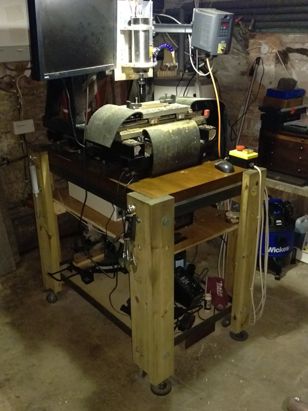

    I built a bench for my machine and included adjustable feet and castors on each corner (see pics below), when the bench is in position all the weight is borne by the feet (the loaded bench is IMPOSSIBLE to lift) if I need to move it I retract the feet so the castors take the weight and let me move it to where it needs to go.
Name:	2016-09-26 23.22.39.jpg
ID:	19339 Click image for larger version.
Name:	2016-09-26 23.18.40.jpg
    Good luck with your build, ask plenty of questions - there's a wealth of knowledge and experience to tap into here! Looking forward to seeing it come together.
