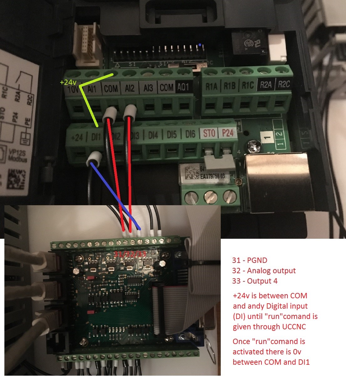

    Hi again :)
    So finally I got additional information, here is photos showing how spindle is connected:
Name:	Spindel connections.jpg
    And here is the video showing the problem:
    I have measured voltage between GND and Output 3 - it shows approx +24v when spindle is in "rdy" mode. Once I hit CW rotation in UCCNC voltage drops to 0v and as you can see in the video I receiving message that UC300 have been disconnected.
    Should the voltage be 0v at idle and +24v when spindle starts to run ?
    Lee, thank you for your advice reg. USB cable. Tried with shorter one - same results. I have added ferrite rings on the both ends of USB cable - no luck either :/
    Any thoughts ? :)
  3. #23
    I think that I might have found the problem. Altivar installation manual, top of p48. "If using Sink Int do not connect 0V to ground". The manual is not consistent but I think that they use "0V" and "COM" for the same connection. Unfortunately, the HDDB2 has one side of its output connected to ground, so that this connection breaks the Altivar connection rules.
    I think that the easiest and safest way to connect the two devices is to use an external relay between the BOB and the VFD. You can then use the Source mode on the VFD, which allows you to connect the analogue ground on the BOB to COM on the VFD (as far as I can see - but I have not read the whole manual!). If you use 12V relays, then you already have 12V available from the BOB. Connect relay coil between 12V and BOB output pin, and connect the relay NO contacts in place of the switches shown in VFD installation manual p48, first diagram. This is an example of the kind of relay that you could use although I do not know what is easily available in your country.

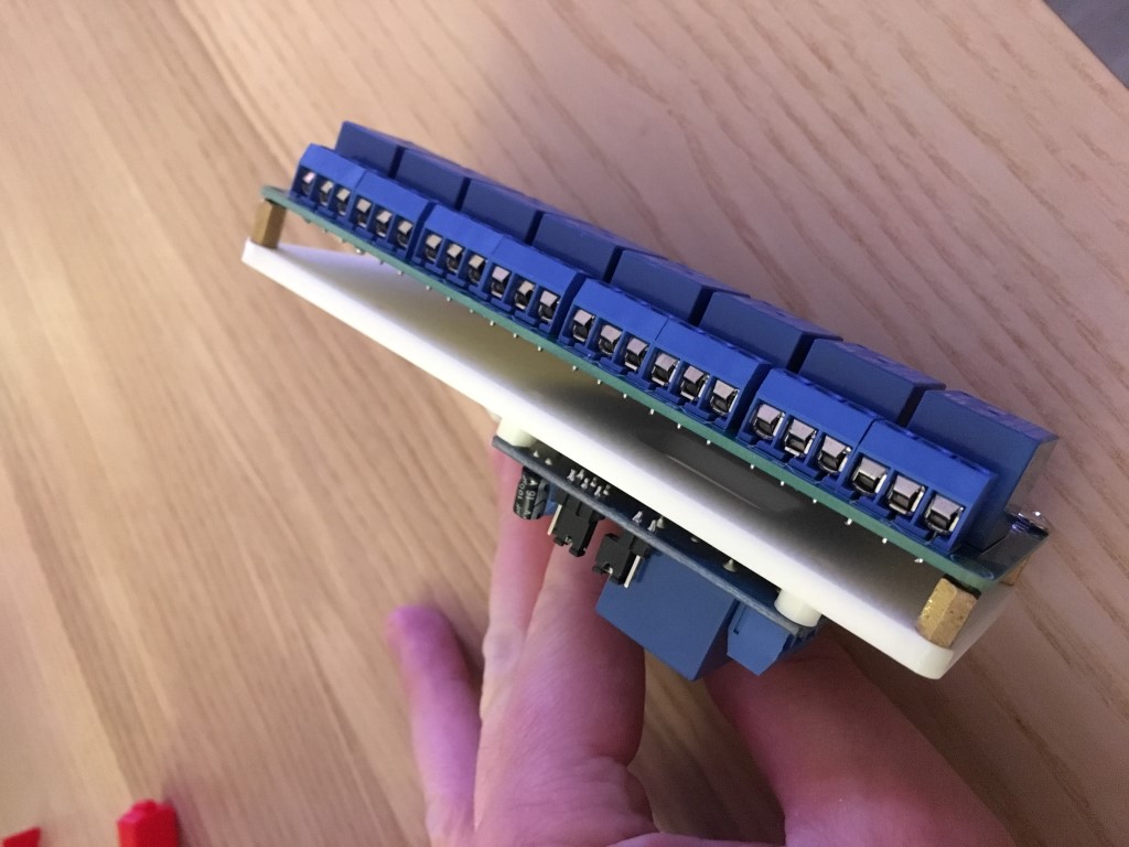

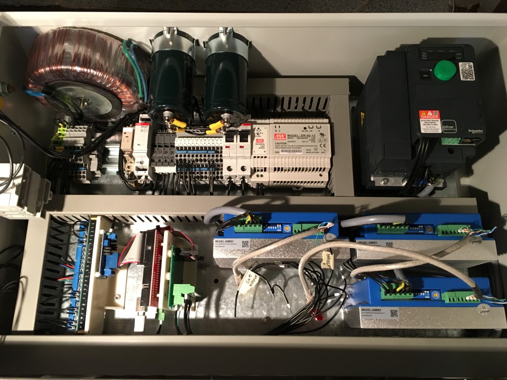

    Hi Gents,
    I finally received relay array (8 ch). While I was waiting, reassembled all electronics to proper enclosure:
Name:	2016-10-04 22.05.13 (Medium).jpg

    While connected only power source, I have wired BOB power inputs (12v) and tried to power on and see if all is good. And my BOB gave some flash and smoke :

    I'm not sure how this happened, but I only see that the bolt I have used, head was too big (even before it was ok..) Anybody see other issue here ? I hope that new BOB will no act same...
    Now I'm waiting for the new BOB to arrive and hopefully get everything going...
  12. #30
    Where did the magic smoke appear from and exactly how did you connect it up.
