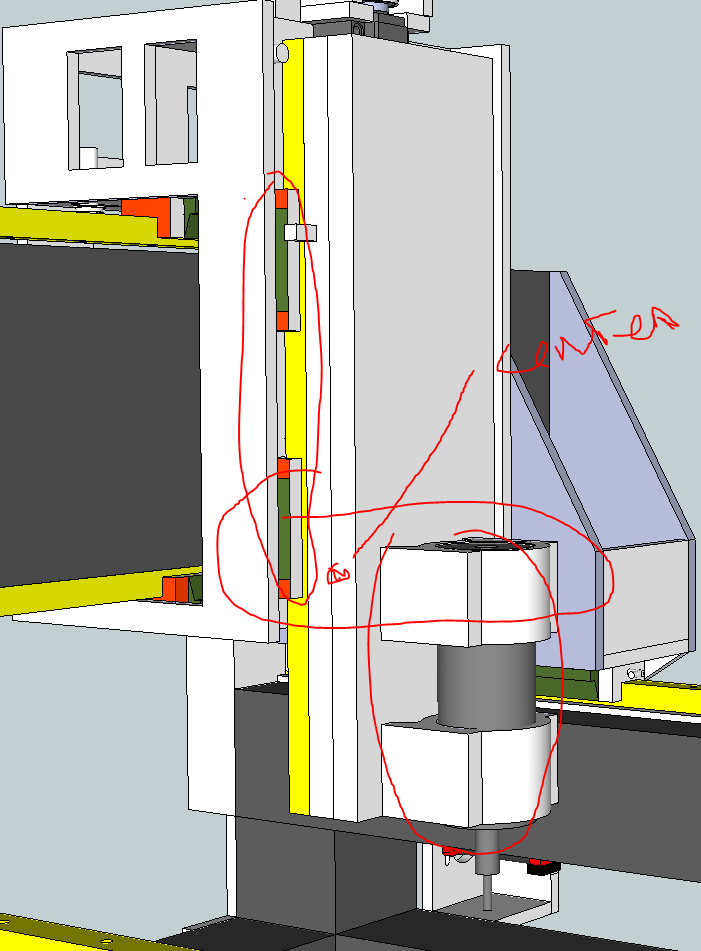

  3. #23
    update :)
ID:	19349Click image for larger version.
ID:	19350Click image for larger version.

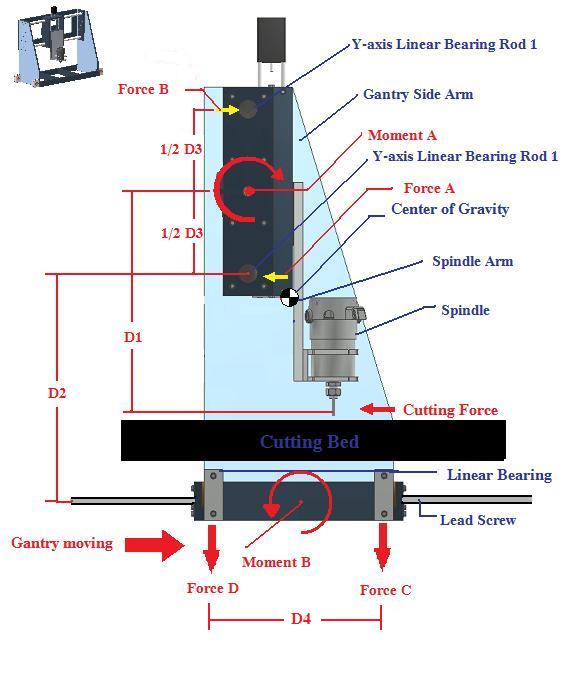

  5. #25
    Or all this is just an indication that at the end you fill finish with too much spindle Overhang on gantry. My criteria is that in a good design, when looked from side, the bit should stay in the bearing spread or the sall called gantry side legs. Or at least not be too far in front of it. I don't see what you will be saving here? 5cm of rail?
    project 1 , 2, Dust Shoe ...
  6. #26
    you mean keeping spindle bit more or less as centre to the bearing blocks or centre to the side plates as much as possible?
  7. #27
    I mean D4 to be so long /260-300mm/ that router bit stays inside it. Its called -overhang/ how far from X rail is the spindle nose. There is center of gravity also. The nearest the bit to the center of gravity, the better. Ideally all should be designed so that is perfectly balanced .
    you could read basic info about forces there http://www.cncroutersource.com/do-it...NC-router.html
    But you could do it out of this concept as you like, if using Hiwing 20 rails and carriages. They are so strong that overhang is not a problem. Just i like things to be perfectly balanced and engineered

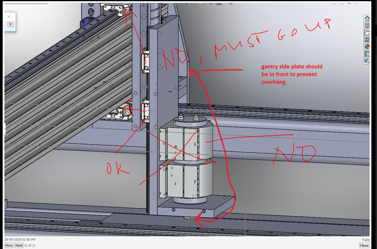

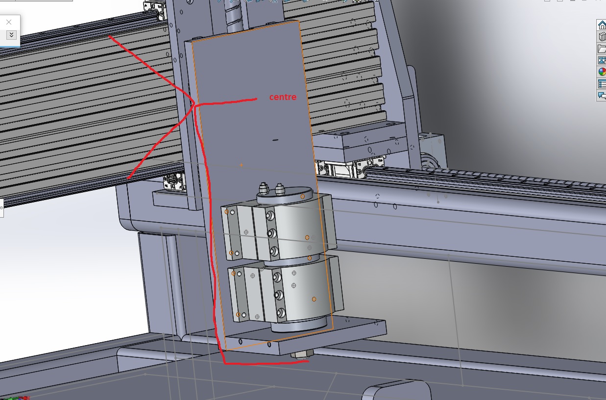

  10. #29

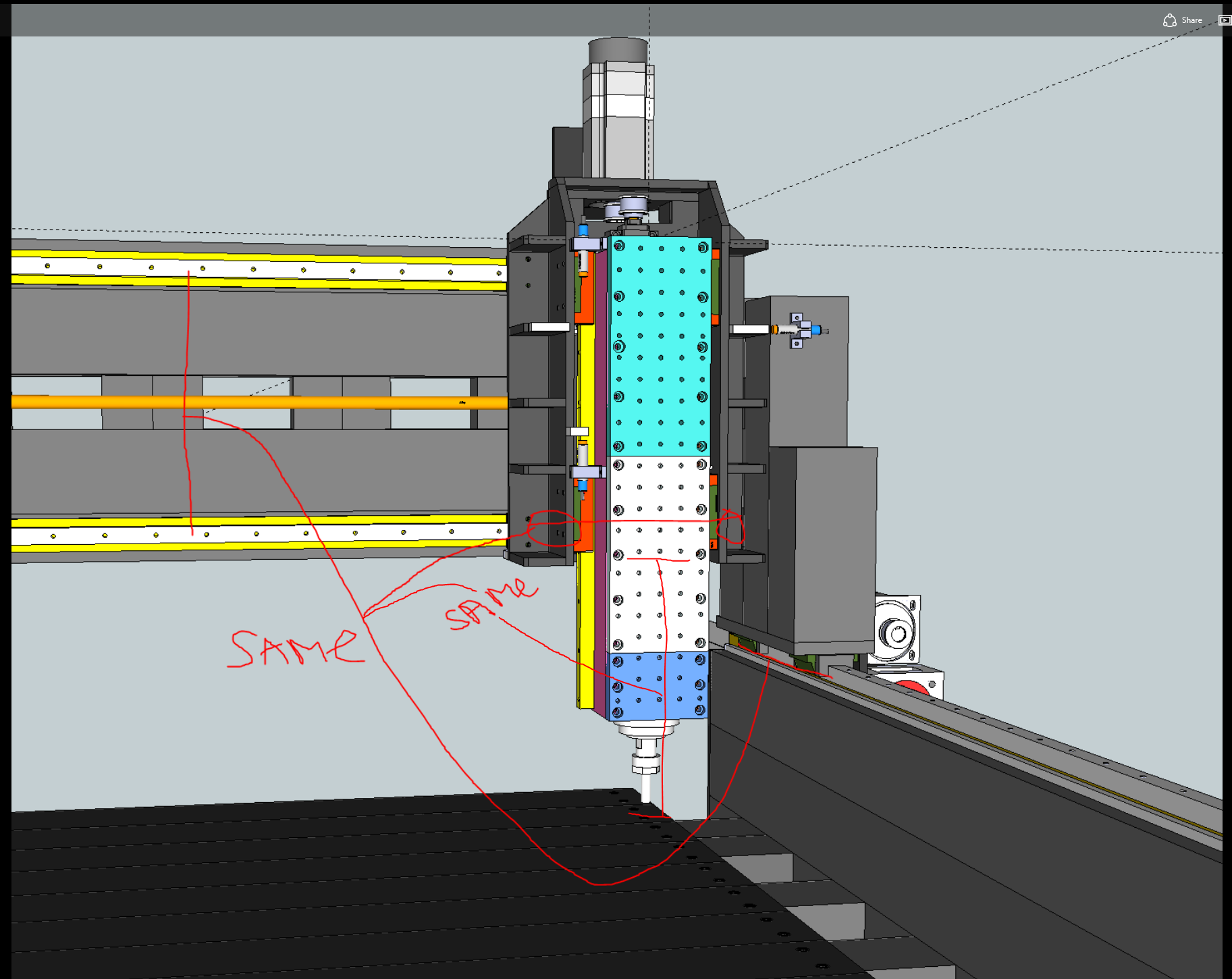

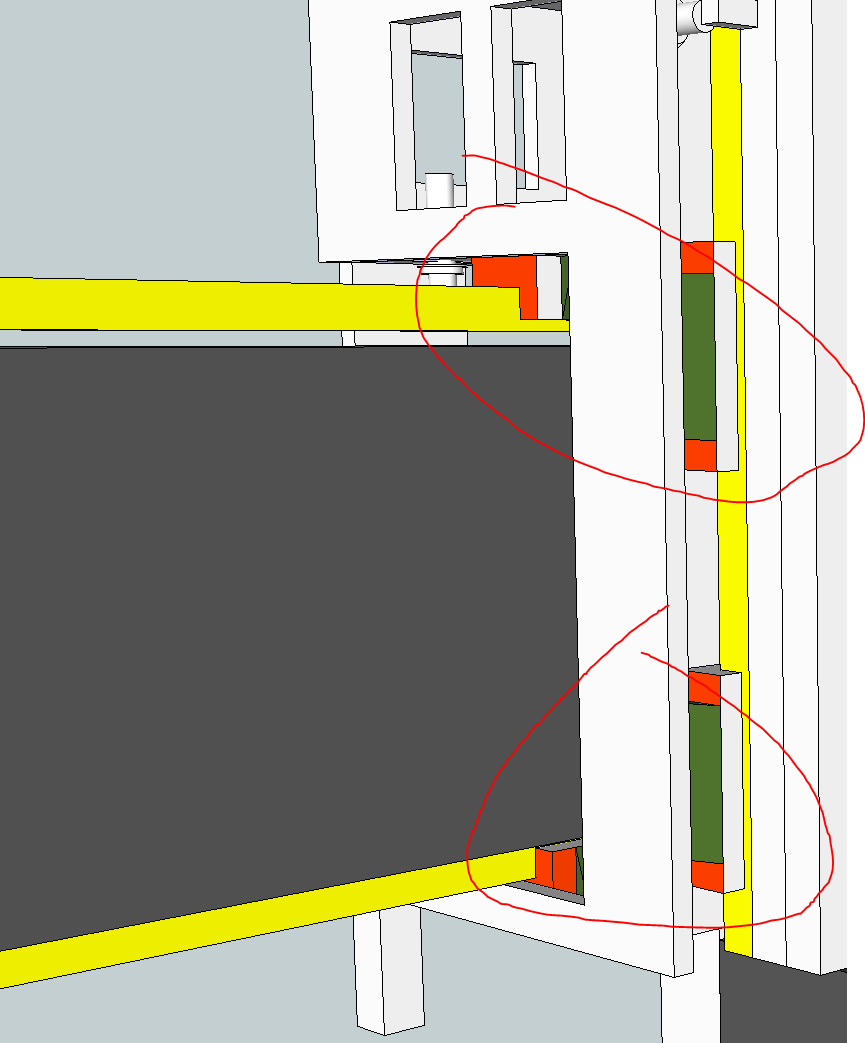

    im hoping im slightly correct but are these images right?
ID:	19369Click image for larger version.

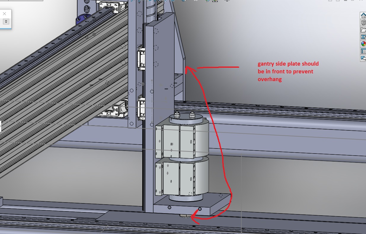

  11. #30
    Hi, just answered your PM but could not upload pictures there. Just saw what you have posted as images .
    In short - NO. Dont despair, but this is not right. You will figure it out :-).
    Lets see:
    This is how its the right way:
Name:	the right way.PNG
    Look at the ideal/ my machine is on the extreme side so not necessary so much / but hence is nice for illustration:
Name:	same distance.PNG
    Also this is the correct way, i would say the perfect way for the Z plate, so its naturally reinforced by the rails and the plates at the back and
Name:	cnc 100x100x3 profile x400y1000z200 z axis plate.jpg
    And finally, design so much travel and space brackets so that at lowest position of Z axis the spindle still reinforces the Z plate. Ignore that the spindle is small , because its small one 0.8kw and Z axis real travel is 180mm . NOrmal 2.2kw or 3kw spindle is much longer. This just to illustrate eventual max. Position:
Name:	max Z down.PNG
