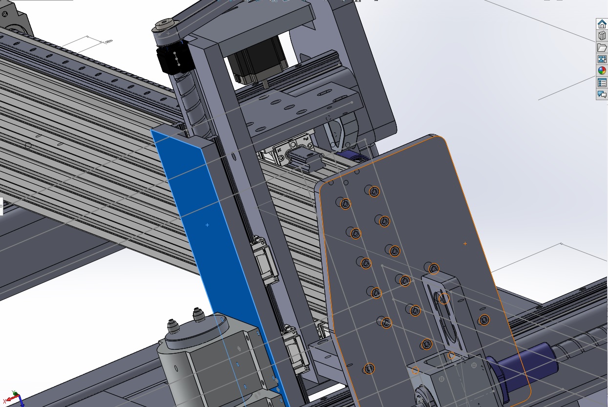

first of i would like to thank you guys especially a few certain people because i knew nothing about cnc and ive learned alot and still enjoy learning more and more everyday. i will be updating new pictures on this thread from drawings to practical.
cutting area of 8x4 sheets of all types of wood and some cases of plastics. frame is made up of 90x90x5mm box sections and will be all welded and bolted to floor.
The 2 box sections that the gantry is sat on are 100x100x10mm, gantry is roughly 70kg with 20mm aluminium plates all round. x axis are 3000mm r2525 ball screws both sides with rotating nuts both on nema 23 3nm 840oz motors. the y axis is running on 2010 screws 1450mm running with another nema 23 3nm 840oz. The z axis is 450mm with total travel height of 200mm on a 1610 screw and all axis on dual linear profile rails.
as for electrics so far im going to use em806 drivers so any tips on whats the best power supply to get to run those steppers at best performance?
looking forward to good and bad crits.
