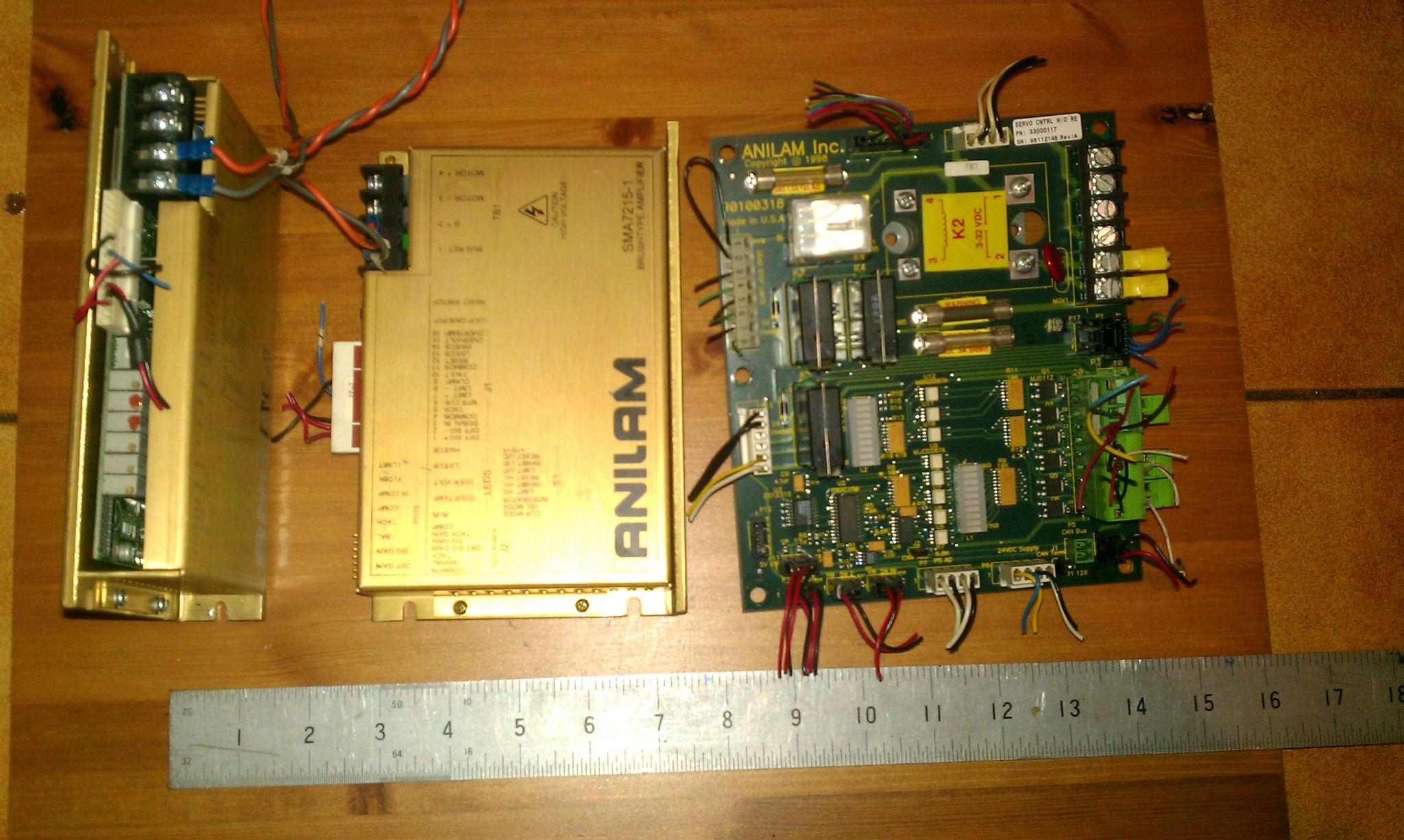

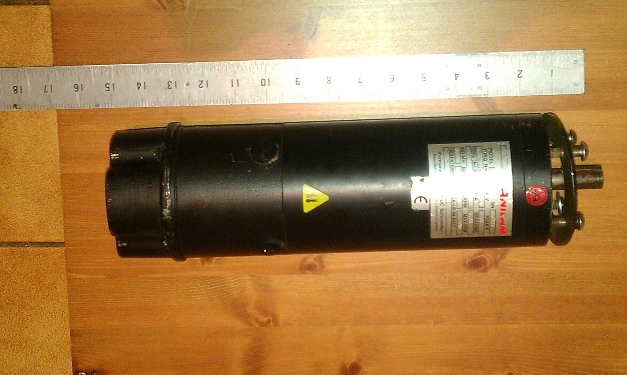

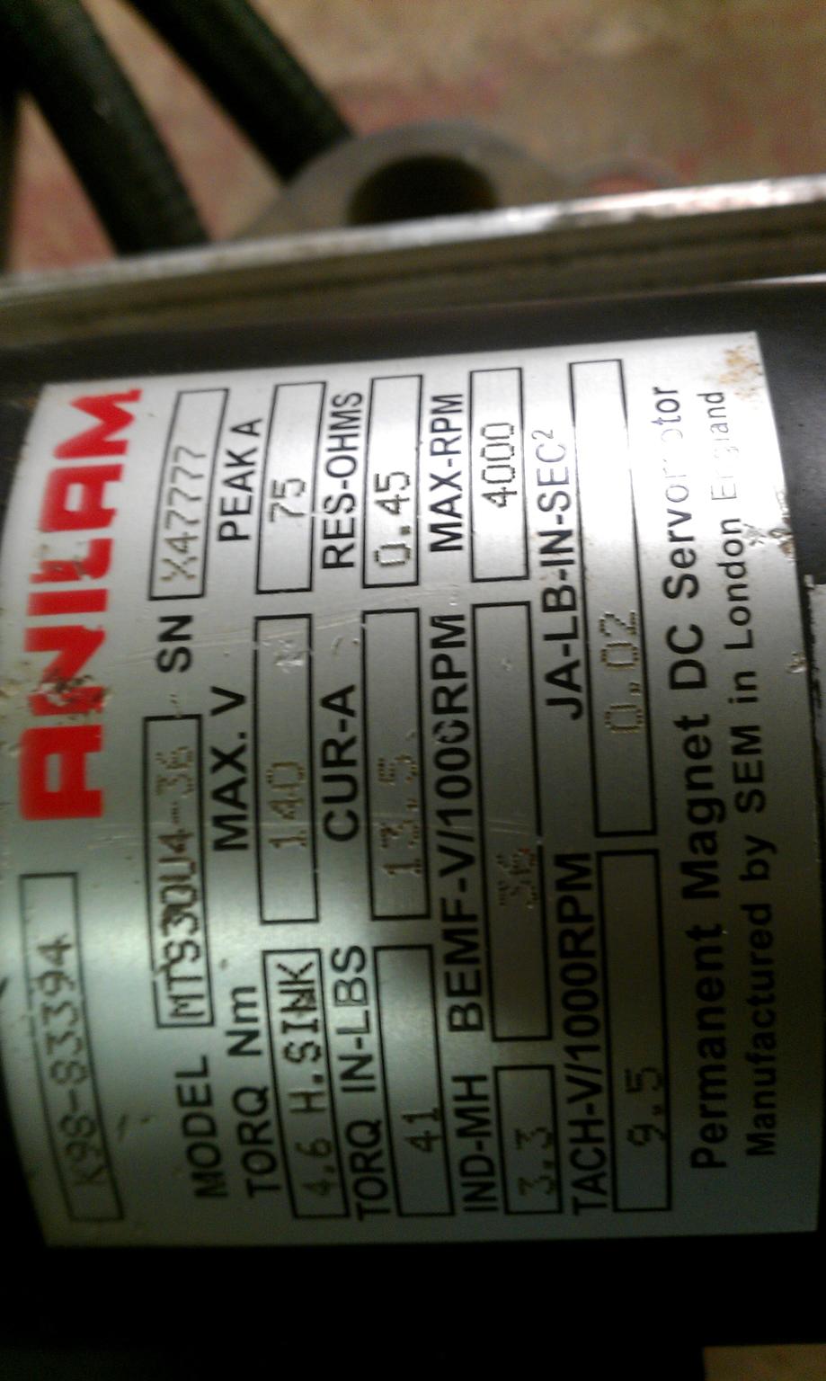

    Chaz I've got 3 x MTS30U4-36 working motors with 2 working Anilam SMA7215-1 drives and one dead one I'll sell.
    The dead drive I think is probably easy repair or could even just be fuseed internaly but not checked. It Was working while I was messing around with it on bench. Turned it off then wouldn't come back on. Got new AC servos so never botherd with it just thru it in box.
    Encoders on motor are 1000 line single ended but I've got some new 2500 quad Differential was going to fit so I'll sell those as well.
    See pics. (Ignore Controller board)
    If interested got my email make me an offer.

    Are the motors using tacho feedback at all (ie, voltage for a specific speed)? Trying to work out if I can use my current drive (Sprint 1220i).
