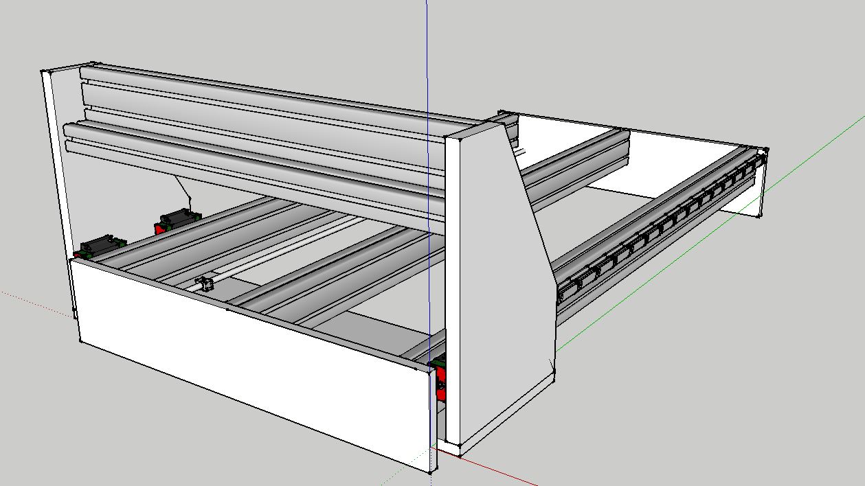

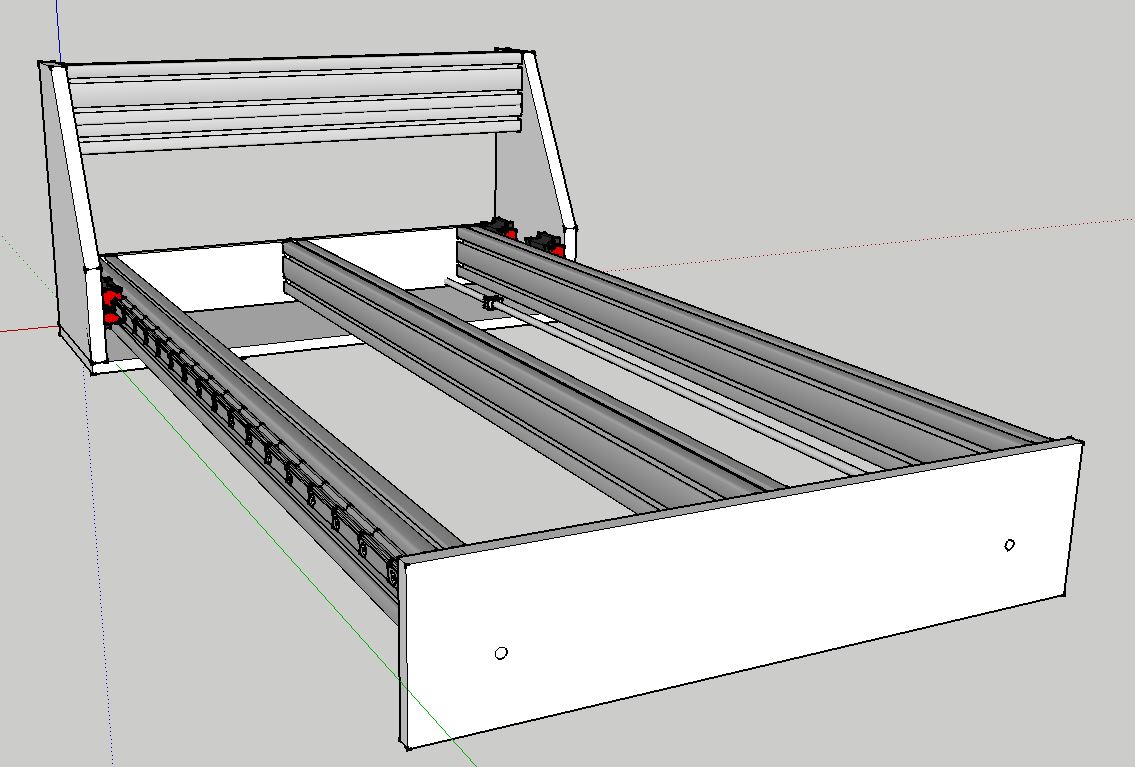

    So going to try and articulate this in the correct language to try and make the question easier to answer. First some wide angle pictures of the design so far:

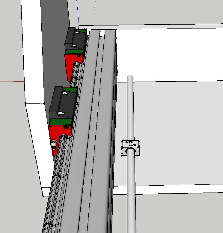

    Question 1 - I am a bit confused with regards to this design section, i intend to use two Y axis motors to provide much greater stability and to reduce the "racking" i think it is called or the gantry pulling or twisting that could be encountered on a single centered ball screw. Accepting that having two stepper motors increases the cost and increases the complexity of the build slightly, as well as needing to calibrate them occasionally as i understand it two is overall more beneficial that one (part A question is my thinking correct here?).

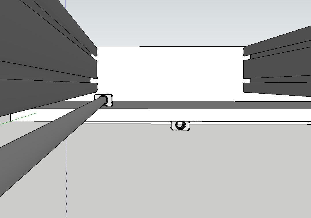

    Part two is in two parts A) how should i be connecting the ball screws to the lower cross beam on the gantry, should they be on top to provide extra support / stability ( a bit worried that it might "strike the plate" or should it be attached to the bottom as per the picture below.
    Part B) i am just not clear at all as to how i am meant to design this area, mainly as i'm not sure how the ball screw assembly is meant to be put together, so am unsure of diameter of cutouts needed for bearings, and how the ball screw would be fastened / driven by the stepper motor. I would be grateful if this could be explained- looking at other build logs it is hard to visualize as while i can see the basic principle the pics are taken far way so not able to see the layout / connectivity. Am i also right to put both ball screws as close to the gantry guide rails as possible as per picture below:

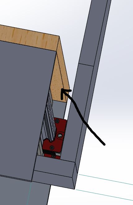

    EDIT - looking back at the picture above i need to redesign this to protect the rail from debris from the bed!
    You haven't mentioned the size of the beast. If it isnt too large the received wisdom is to use a bigger stepper and a belt to drive the two Y screws. This avoids racking and sync problems.

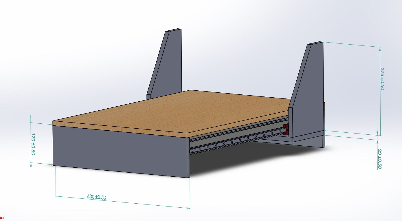

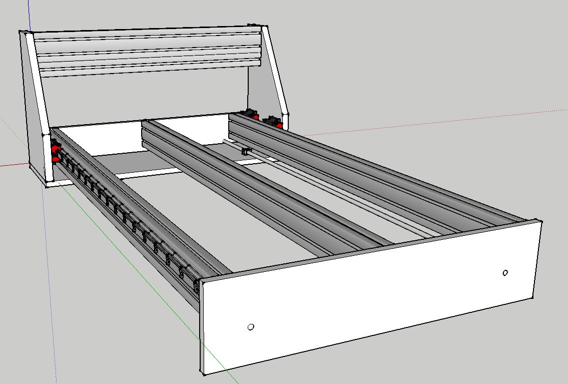

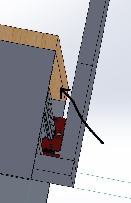

    Ok making some progress now fixed issue with rails being exposed with a bed overhang - read allot about ball screws so going to tackle that next - feel the learning curve is huge and keep going back to the design and tweaking, feel like this is never going to get finished . And as i type this i am thinking i have no cable tracks (are they called "energy rails") so another snag added to my list!!

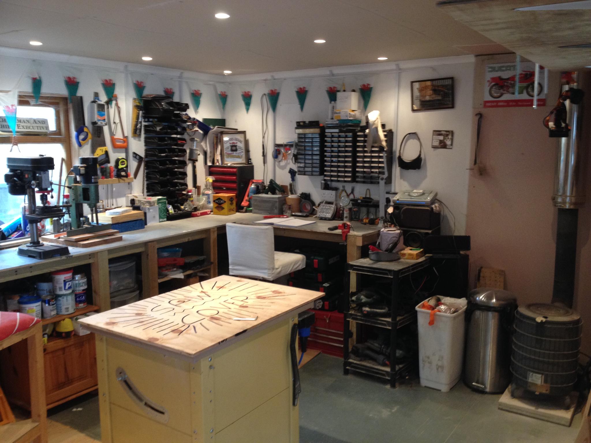

    Well final update on this thread because ... A) just figured out posted in wrong place and B) Gone back to the drawing board so the original design brief has changed so will do it all again once my plans are complete.
    So today i spent time in the workshop getting things tidy again and man it is lick the floor clean in there now lol !!!

  8. Nice workshop! You should have a look at this thread : Finished builds picture menu
