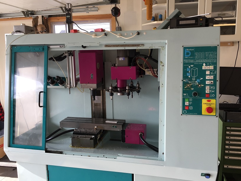

    Hello Boyan, and thanx for reply :-)
    Yes, i have been looking at these controllers.
    Found several of them at ebay like this one http://www.ebay.com/itm/English-Pane...oAAOSwG-1Wy-32
    Dont mind being a guinea pig, but my experience in programming CNC is not exactly fierce. Which means i would like to start with making the drawings and run it from there(that i do have some experience with).
    In time i want to start playing around with the programming part in depth.
    Right now i follow my old KISS(Keep It Simple Stupid) theory, trying to find a cost effective solution i can start with.
    However, manuals have been downloaded some time ago and i will attempt to study this in due time.

    I apologize if my question can seem somewhat stupid, but how do i control the 4/5th axis cradle if i install a 3 axis controller ?
    Jupp.. I`m a newbie :-)

    Boyan That's little out of order to me and not very good advise for someone who's stated got no experience and who's wanting to convert a mill with full ATC.
    The work involved just for the ATC is enough to make experienced user shy away and that's with mach3/4. So with Chinese controller that very few people know anything about with Chinglish manual that's about clear as mud isn't some thing I'd be recommending any new user to get into.!
    Proteus you need to think long and hard how your going to tackle this and what hardware your going to use other wise you could cripple or spoil very nice machine.
    Don't let all this talk about Offline controllers scare you away from PC based controllers because they work fine and have massive user base which can help you no end. Esp with bespoke ATC setups etc.
    The same can't be said for the offline controllers and the jury is still out and will be for very long time untill they become more common.
    Also I'm pretty sure they won't be simple to setup for anything but basic ATC setup. You will be required to write macros or learn some form of ladder logic for more complex ATC.
    The same is true for Mach3 or Linux etc but with the difference that many have already done it or will be able to assist with macros etc.
    Good luck.
