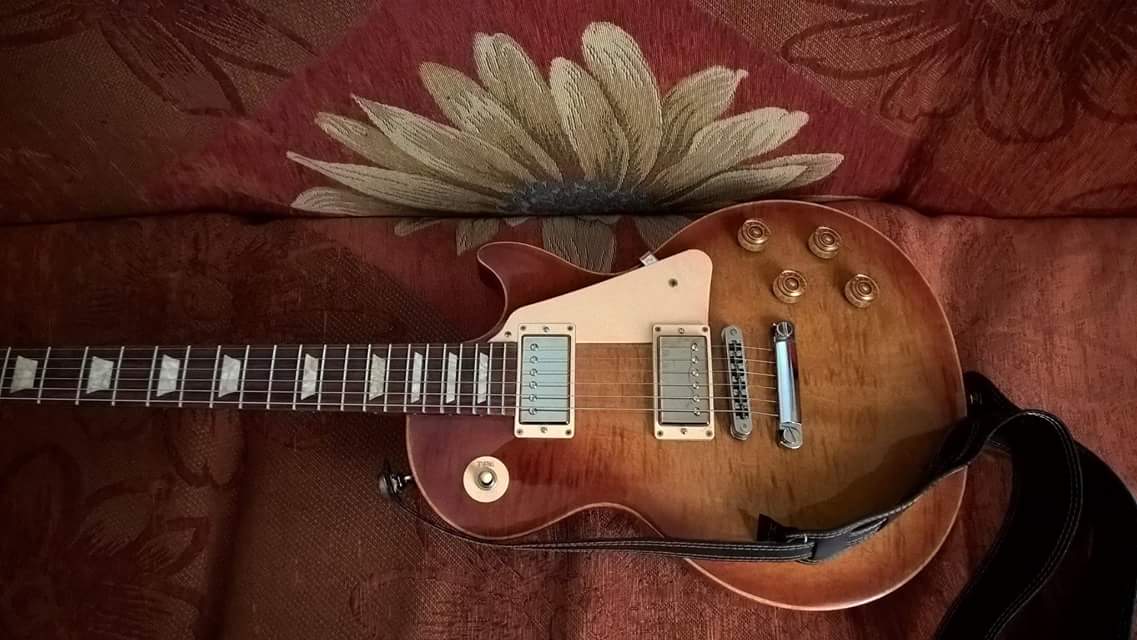

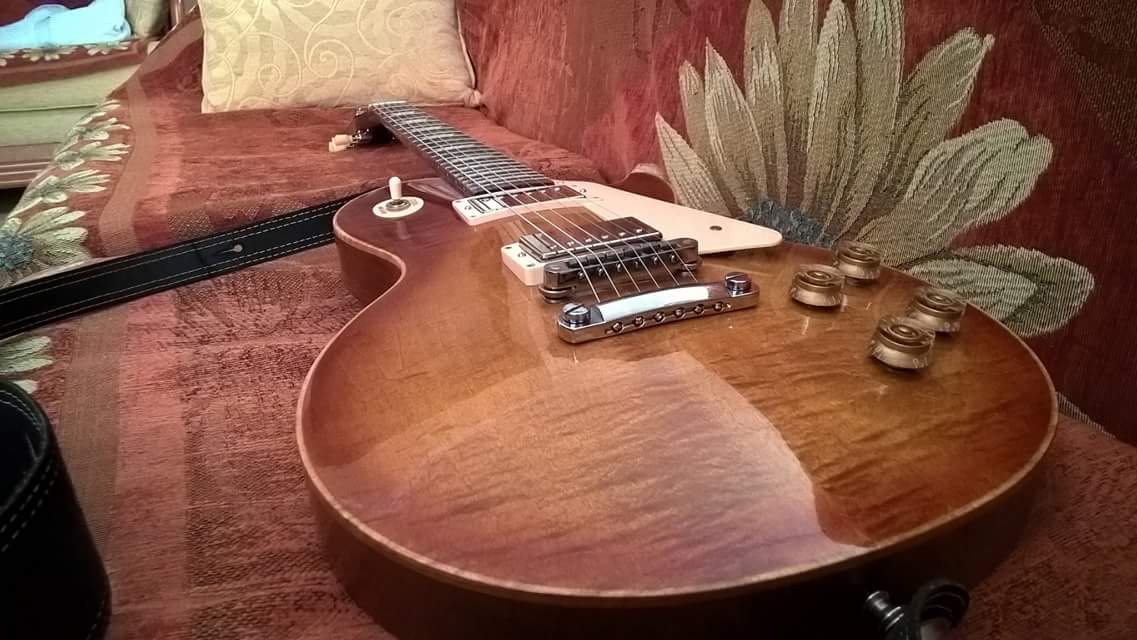

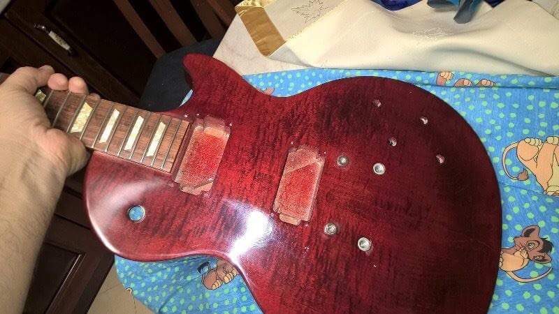

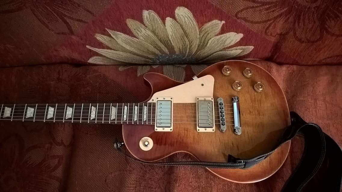

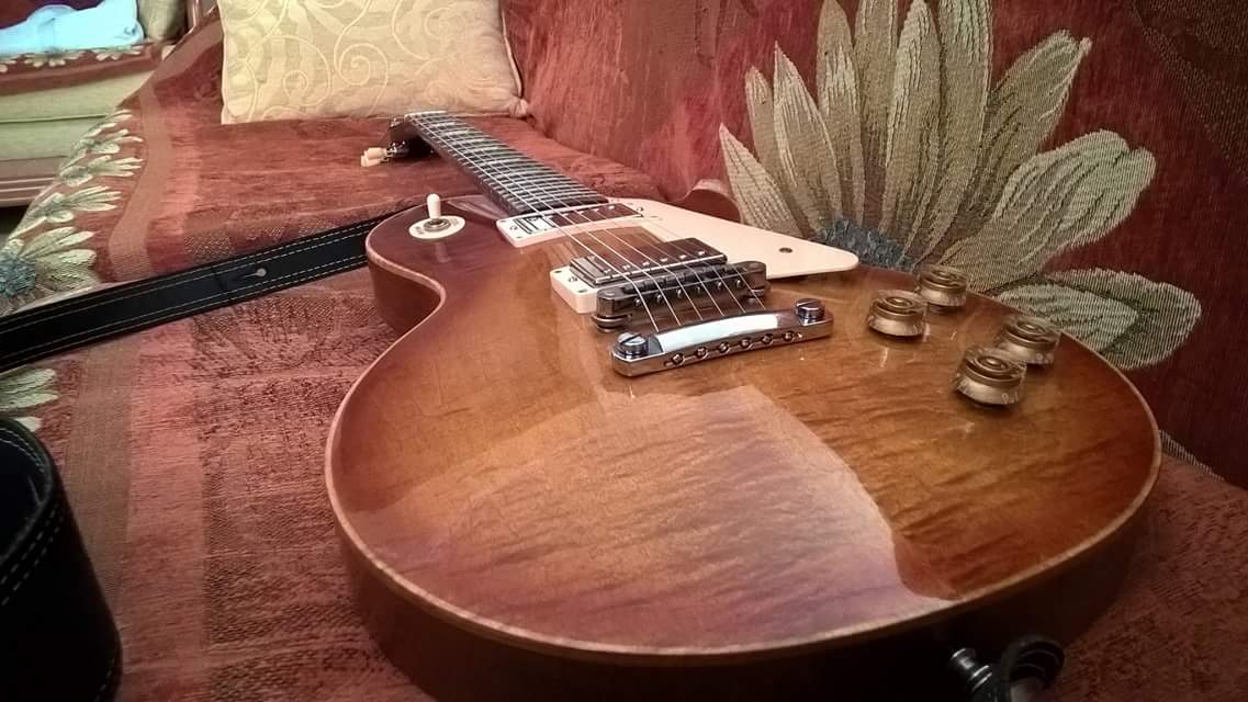

    Burst can be a PITA although it looks easy and not all techniques work the same for all people. You have to experiment with most of them to found which one works best for you.
    Here is one Gibson USA I paint for a friend, from apple red to burst like Moore's guitar.

    Nice job on the Les Paul Nickhofen, that looks far better now.

    Thanks EddyCurrent ,that red didn't make any justice of the maple top that was hidden under the color.

    That's a really nice burst - lovely gradient on it and you're right, that flame was wasted on the original finish.
