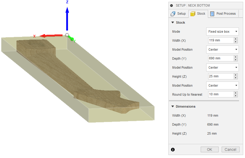

    stock : maple or sapele 690mm(7) Long 119mm(X) wide 25mm high(Z)

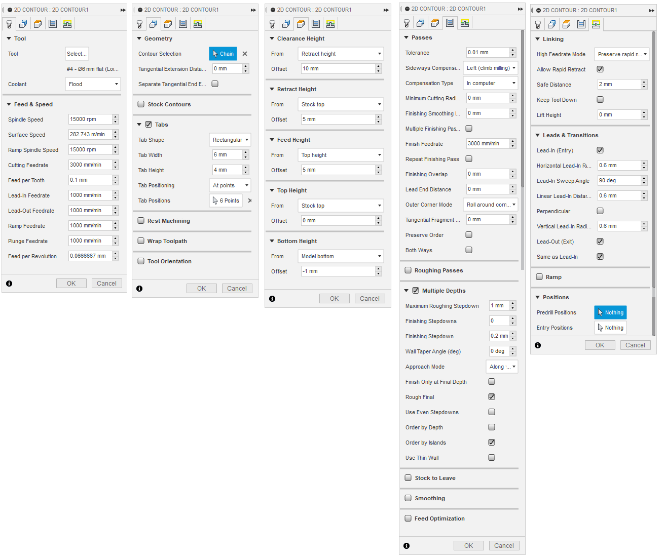

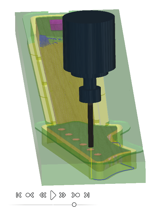

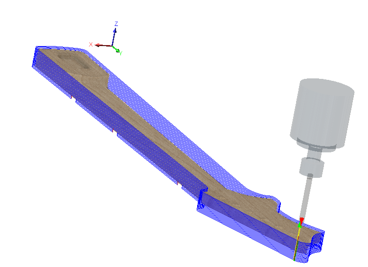

    I am having trouble when cutting 2d profiles through the 25mm
    The operation I am trying to carry out is a 2D profile cut through 25mm of stock.
    when the bit gets to be about half way through (12mm out of 25) the vibration levels increase.
    This then catches the workpiece pulling it out of its clamps and the rest is history....
    I increased the clamping around the workbed but the same happened again....
    I have attached a few images of the setup of the toolpath for reference
    if anyone can help me solve this I would really appreciate it.

    I have a workbee but have not cut anything as big and 3D as that. Unfortunately the picture of the path I find unreadable, could you repost the path details as separate pictures?

    thanks for the replies folks...
    I have pdf'd the toolpath settings.. hopefully that helps their visibility.
    Also two short videos of typical operation.
