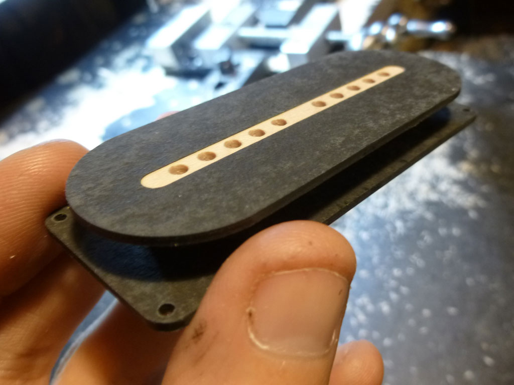

    Not sure I could bring all that much to the party body and neck wise, but maybe inlays, or a badge of some sort? Perhaps the pick-ups? I mention those as I'm currently making a set of 10 prototype Rosewood P90's for a local builder, pics and vid of an earlier effort below. I could always ask if he'd wind you a custom built set if you wanted to go off the beaten track - might be a bit cheeky but he's going to be dabbling in CNC himself at some point next year - I've already had the thought that you might make a good contact for him regarding learning about the machine and a solid introduction to CNC guitar making...

    Hi Wal,
    That might be an idea - I was going to go with some kind of vintage Fender reissue pickup in the bridge (the original guitar I'm copying is a '62) and a '57 PAF re-issue in the neck, but if I can get closer to "vintage" by going custom that might be worthwhile.
    No problems on me helping your mate out with guitar CNC'ing - I try to respond to any questions on my YouTube channel the day they're posted and get some PM's etc as well - happy to help people get inspired to build/buy/learn CNC.
