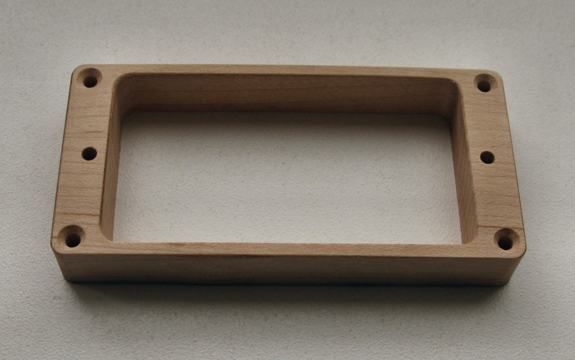

    When you sanded the fretboard black dots it looks like there was no contamination of the maple grain. I once used ebony dots and upon sanding, it went right into the lighter wood's grain.
    I liked the idea of using a lathe to drill the truss rod hole in the heel, I guess the neck was horizontal because you were using a 2 way truss rod rather than a bowed threaded rod.
    Here's a pickup ring I made recently for a humbucker, toolpaths made in CamBam

    Yes it was a double action rod and horizontal - hence all the "hiding" I had to do to make it look like the original single action bow type with cross head adjuster.
    The maple grain was fine after sanding, normally I would clean the fret board before spraying, but this particular guitar is supposed to look like a 62 vintage, so I'm currently testing ways on offcuts of "dirtying" the wood up that also allows nitro lacquer to still adhere (which will then sadly be "worn" back again somewhat to replicate wear).
    Nice pickup ring BTW.
