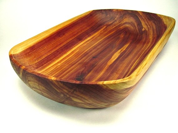

    I'm experimenting with small keyed xylophones.

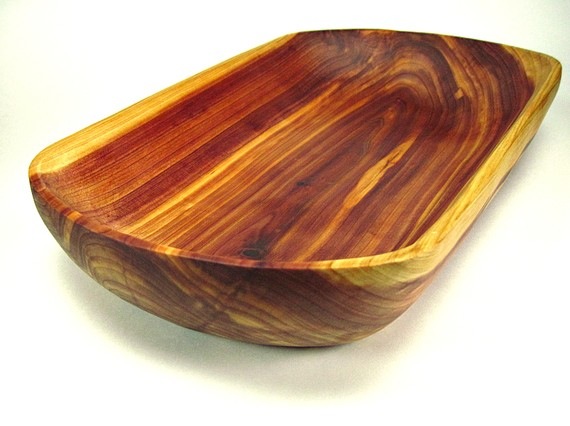

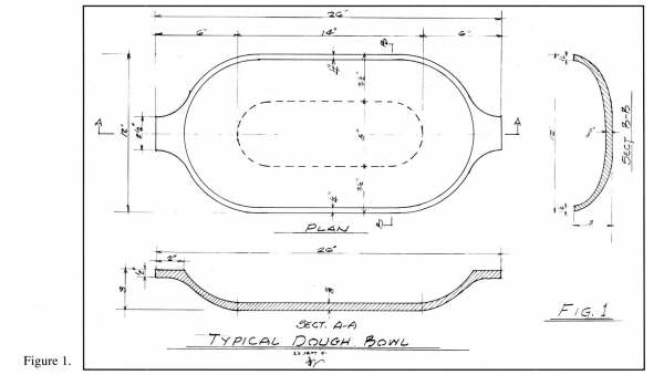

    I'm wondering if I can make the main casework out of timber, machined on CNC. It would be like a large wooden pencil case, or dough bowl at the bottom, housing most of the mechanics. This would be hopefully milled out of one block:

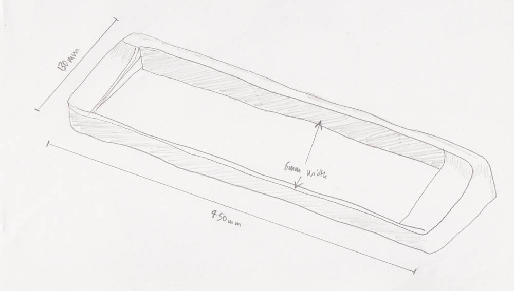

    And there would be an aluminium shape like this, secured above it, around the keyboard. Hopefully this could also be CNC'd?:

    Ideally I'd like an accuracy of +-0.1mm. Is this realistic?
    And a machine with a working area of at least 500mm x 200mm x 120mm (Z)
    Well, definitely looks possible! :-)
    Quote Originally Posted by Grambot View Post
    0.1mm is more than achievable and your cutting requirements are also very easily achieved. Thou you may find little more than 200 will be more usable and give more scope.

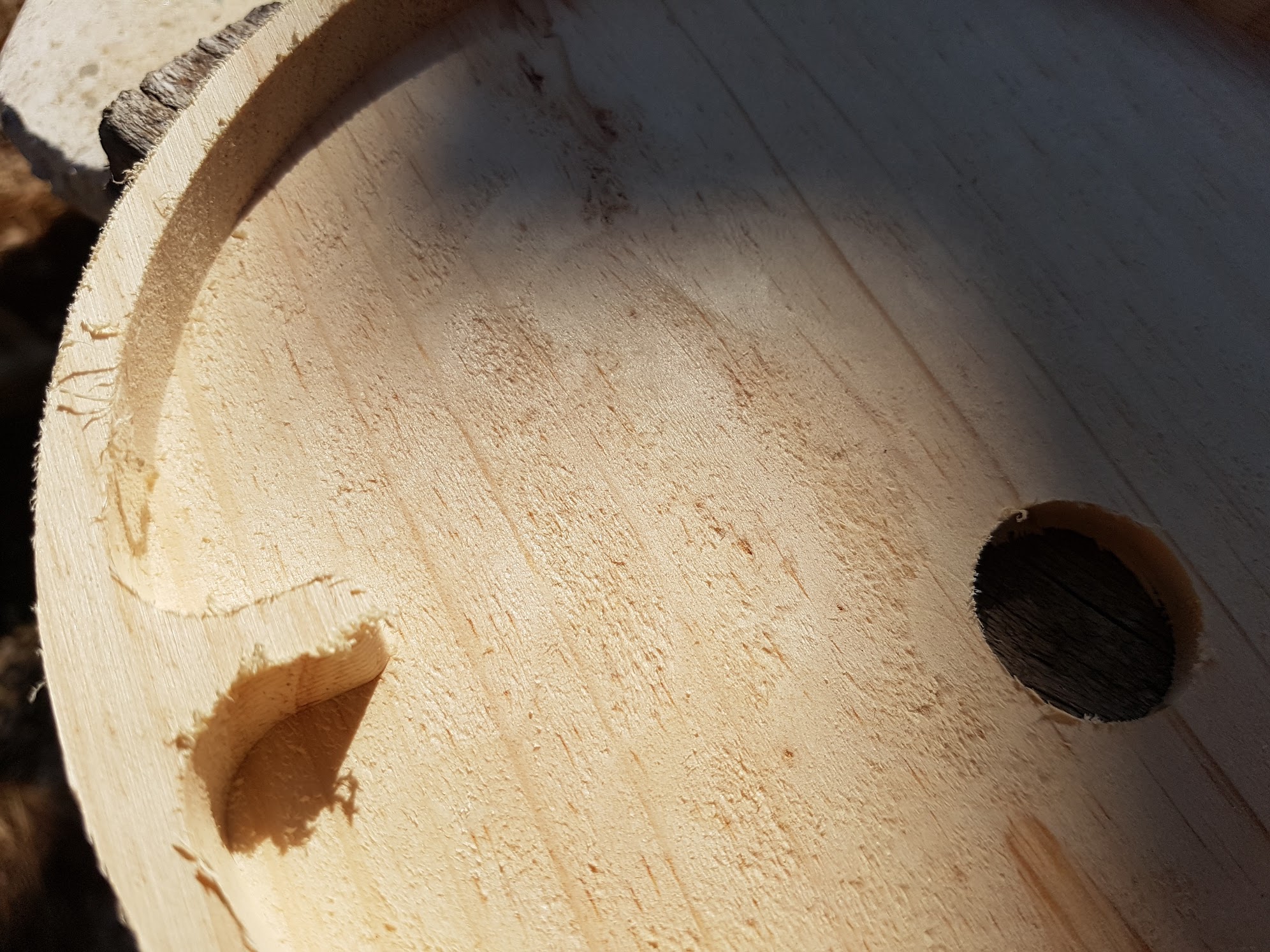

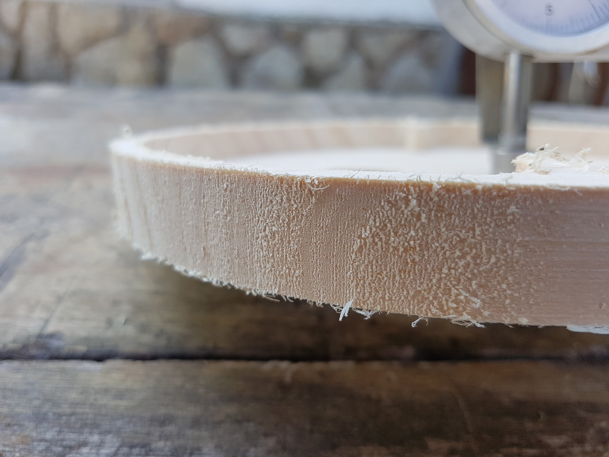

    My instruments were 0.01mm overall even on my old machine which was to say "flimsy". "Overall" means in some places could be and is worse, but on wood that's not a problem. In reality now with my machine i have always to slow down things and spend time adjusting perfectly toolpaths so to avoid chipping. So at the end whatever they say, but CNC is an art
    So you don't need super fast machine , real life 10 000mm/min will be ok. 5000mm/min will be slow to my liking, but it will not be bad if your machine can reach 20000 mm min so you use HSm techniques there like digging full depth / see my video/ . What happens at the video is at 16000mm/min. The problem though is that now i don't use that toolpath, cause it makes a lot of noise and around me people pay to live in quiet near the sea
