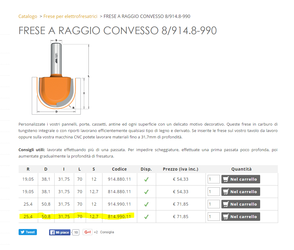

    My last advice before you jump in ordering a machine is have in mind the following:
    That below will be your main tool/s in this kind of job/ there are cheaper variants, dont worry but i am speaking about the size here/
    So start backwards from there. What spindle you need for that bit, what speeds the machine to move, how will evacuate the chips produced and so on.
    Download HSMAdvisor, It has trial though i greatly advise to buy it, as it starts to become indispensable tool for me and if one knows how to use it it will save a lot of money, even when designing a machine. After my recommendation now there are all the chinese water cooled spindles included there. So choose 2.2 and 3kw spindles there, input the above router bit and start playing around so you see what happens. Change machine max achievable speed and so on.
    That's how you will make really educated decision on spindle size, machine max speed, rigidity, motors and so on. Knowing exactly what final purpose is, how good a machine could be and how much will cost you that. Find the acceptable point that all is valid and seems good and that's it.

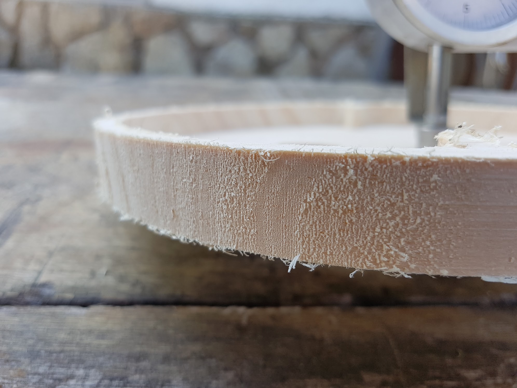

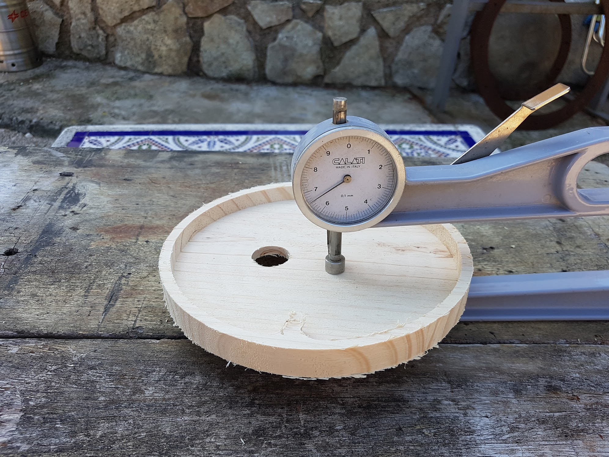

  4. #24
    Here is an example. I work mainly with pine. No hard woods in my case, but otherwise some of them really hold that 0.01 precision after machining and can be machined to almost perfect finish.
    On a slow machine that below / roughly 200mm diameter, 18mm thick overall/ could take 15-20 min to machine. As you not thickness is exactly 6.5mm.
    But later it will need sanding, otherwise i could have machined it straight to 6mm from the beginning but it would have taken a lot of time to almost same finish as sanding it for just 1-2 minutes . So not worth machining it too much. As sanding it is much faster.
    So as you see it needs sanding, otherwise i should have wasted unnecessary time to change bits, slow the speed and so on.

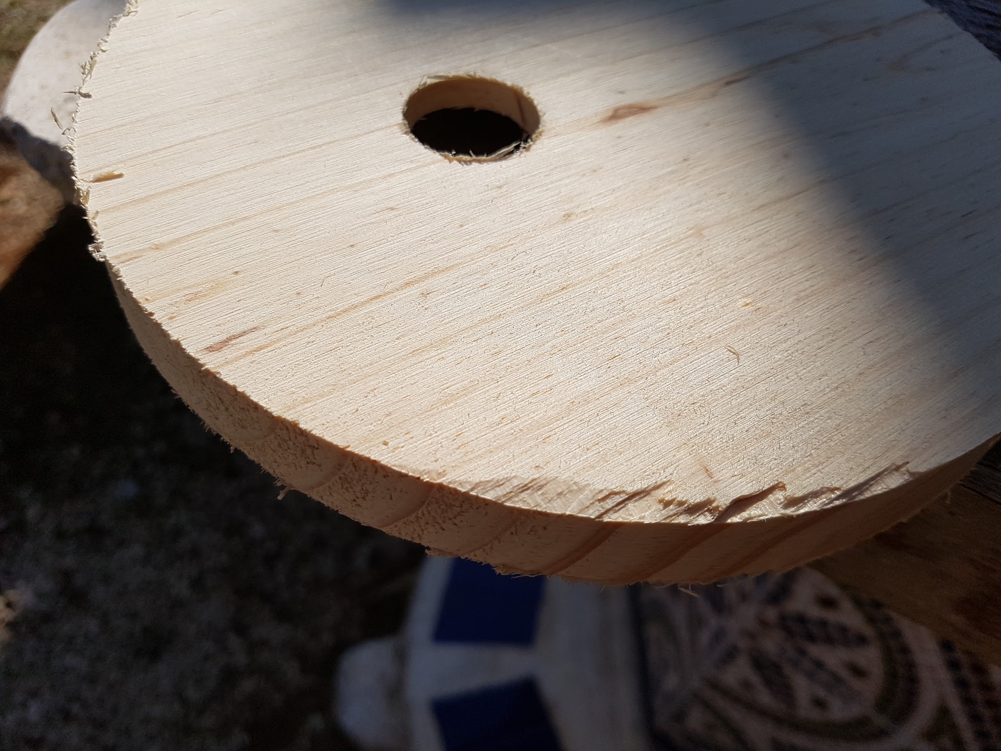

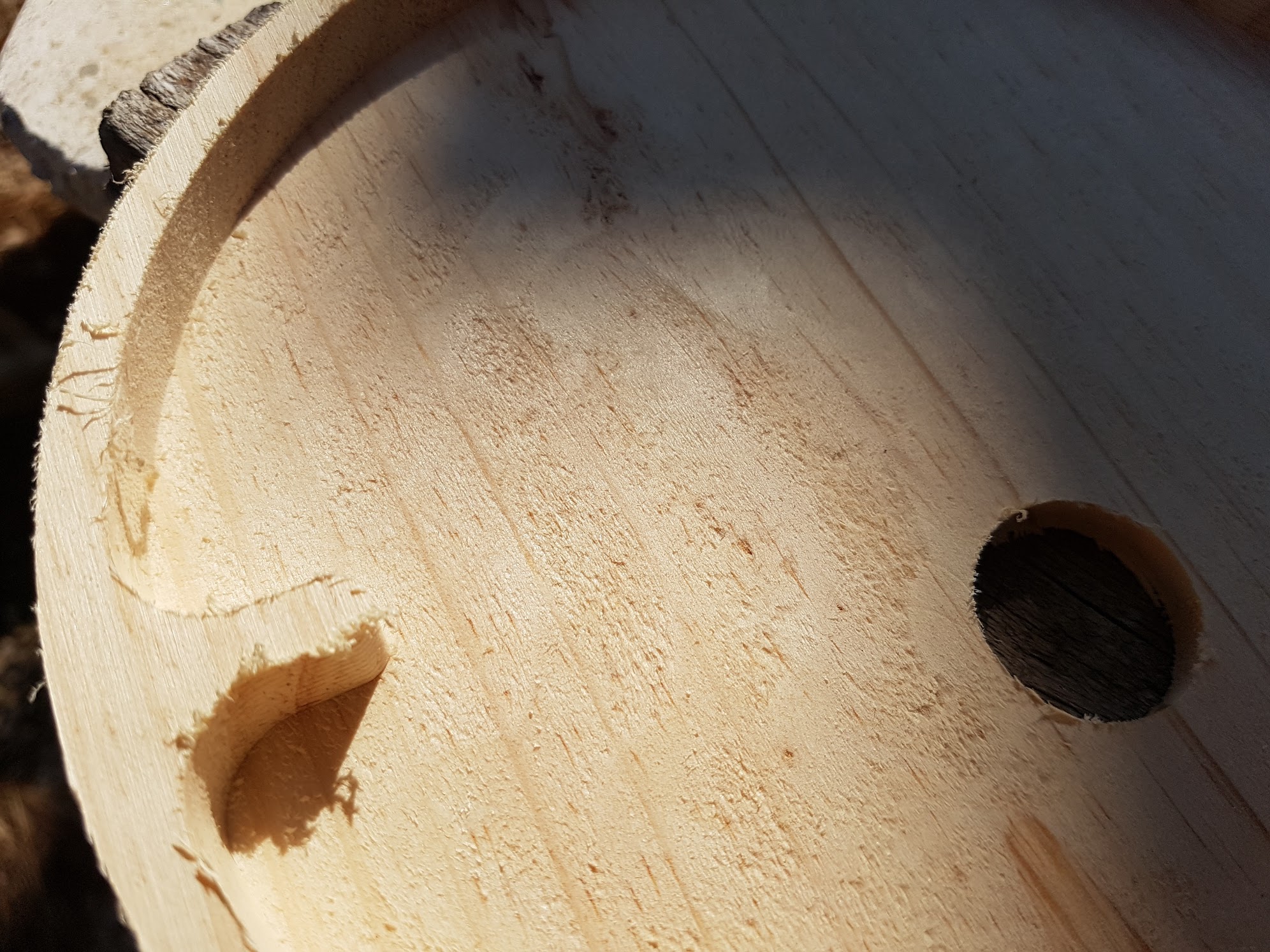

    But too fast is also bad. As the machine does not have problem to make it for 4 minutes but many pieces chip:
    So a compromise time of 6 min. Where i offset profiling toolpath 5mm. So if it chips like picture above its no problem. Then i make another profiling toolpath that takes the last 5mm only. 1.5 min more, but its worth.
    Even so, i leave extra 1mm because finnish is not perfect and when 2 pieces glued together and dry, then i take out the last 1mm on the sanding disk, where it takes mere 30 second using 60 grit.

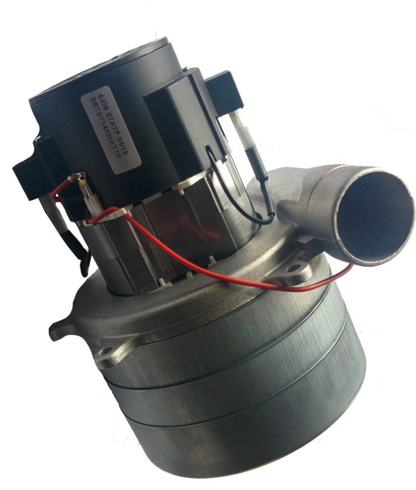

    If i was going that way I would rather buy 3 stage vacuum motor and design a simple enclosure to silence it mounted directly on top of separator on top of 200l barrel. I have done that in the past and works like a charm. The separator and enclosure is very simple to design and make from MDB
    here is the motor:
    Problem with the above is they make noise, so have to be isolated and they have high power consumption, plus have to be ventilated outside otherwise they heat the room much.

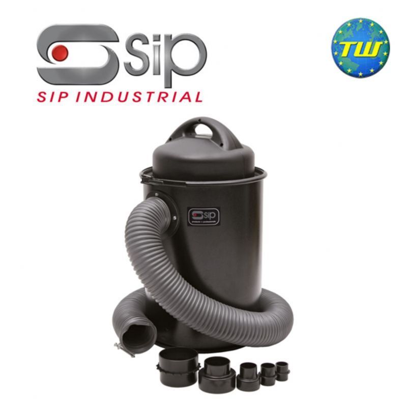

    CLARKE Woodworker DUST EXTRACTOR 1hp could be the other solution. Again separator must be build on top of the barrel as there are no cheap ones for 100mm hose size/ if any/ . The original bag is crap, it will not collect fine dust.
Name:	clarke-1-hp-portable-dust-extractor-chip-collector-cde35b-6470310-11798-p[ekm]299x299[ekm].jpg
    I am in from of the same problem now and for the moment i use a shop vac and dust separator on top of 200l barrel. I don't like it for the high power consumption, small diameter hose and the noise.
    I am thinking also about a smaller wattage tangential motor like 350W mounted on top of DIY separator on top of barrel. My friend has the same setup and reports its good. I will go these days at his shop to see with my eyes if small motor could evacuate the fine dust and small chips.
