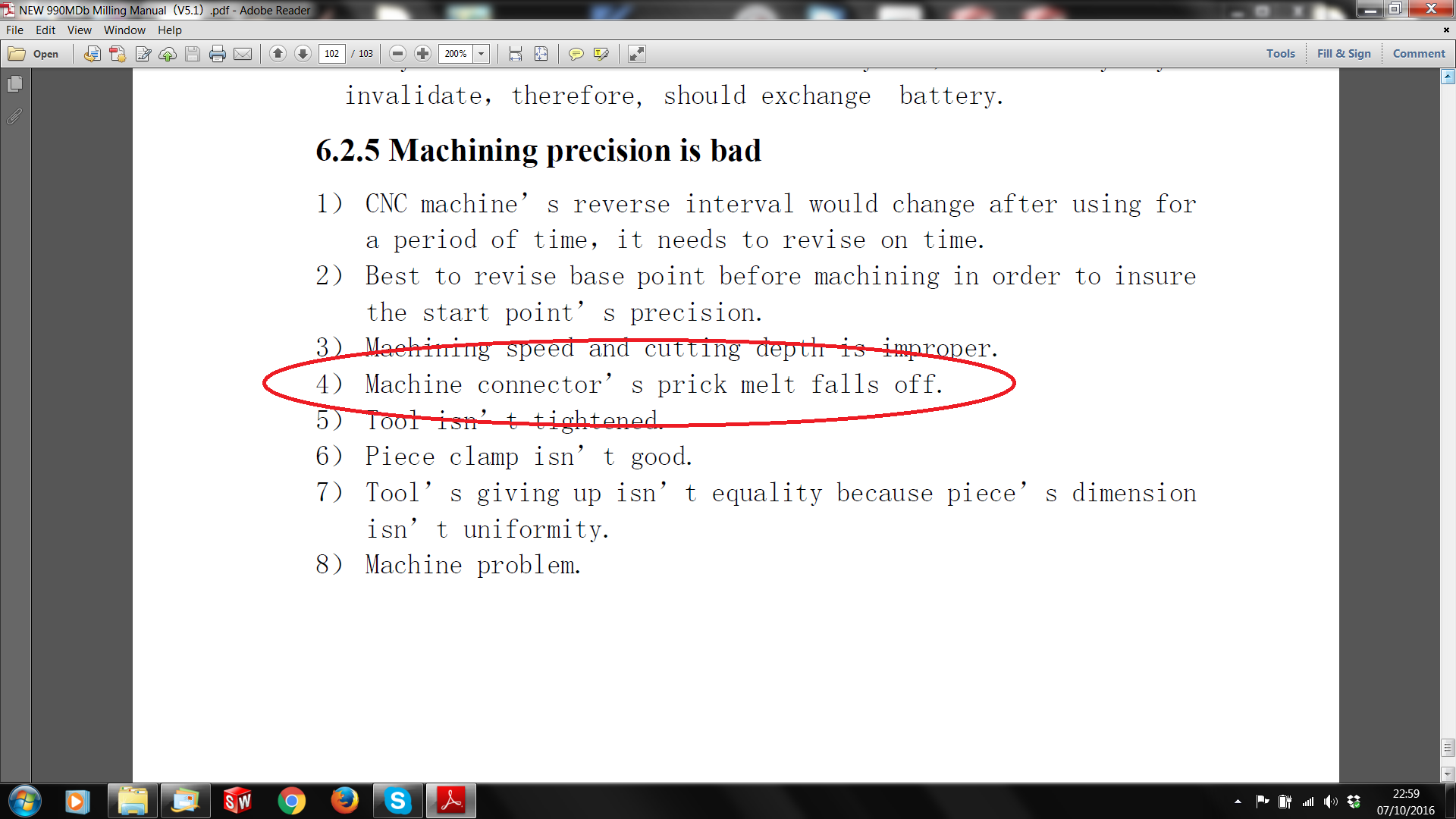

    After reading the manual for one of these controllers I'm not sure I want one if that's what happens when go wrong. .

  4. Quote Originally Posted by JAZZCNC View Post

    Gotta love chinglish!! I can't read manuals like that without crying with laughter
