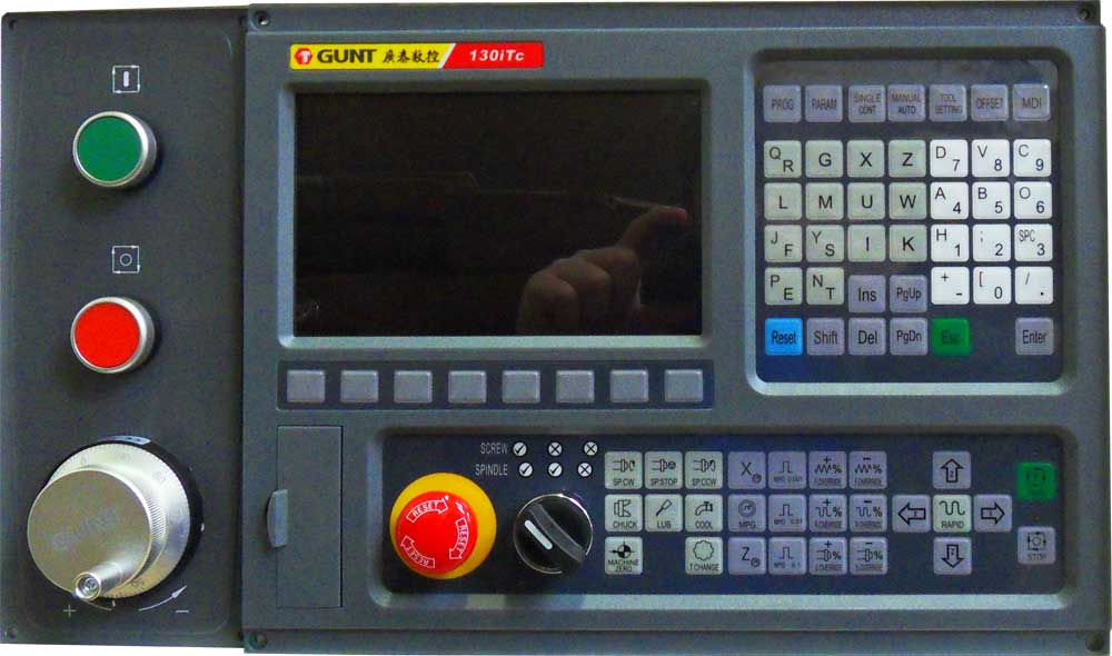

  6. I have dealt with the Chines for over 20 years and some of the Chinglish is quite funny. I have two CNC controllers made by a company called Gunt. with a bit a grease or dirt in the right place it becomes quite offensive to the opposite sex.
