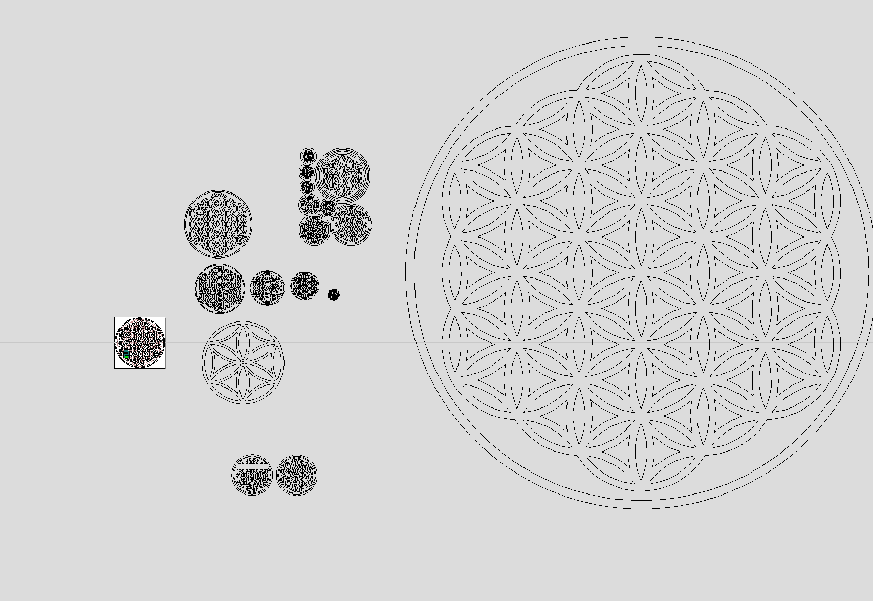

    Example bellow that i scanned from web and node edited to perfection, as i found that the vector ones had some small mistakes that took me even longer to find and cure. plus i had to make proportions according to my specific liking and tool. So at the end it was shorter to trace perfectly a part of it and then copy paste build it as a whole.
    Another tip. Do you note how big is that one at the right and how small are the actual machining ones? Thats cause i blow always the JPG as big as possible by stretching / +shift to keep proportions/ . Then i trace. Then i fix. Then make vectors small and all is perfect for machining. Though as i said this time i just had to redraw it using the pen.
    PS. I mixed the pen with the pencil which is free hand. The pen is the right tool. And as i said use the "shift" tool also here. See video below
