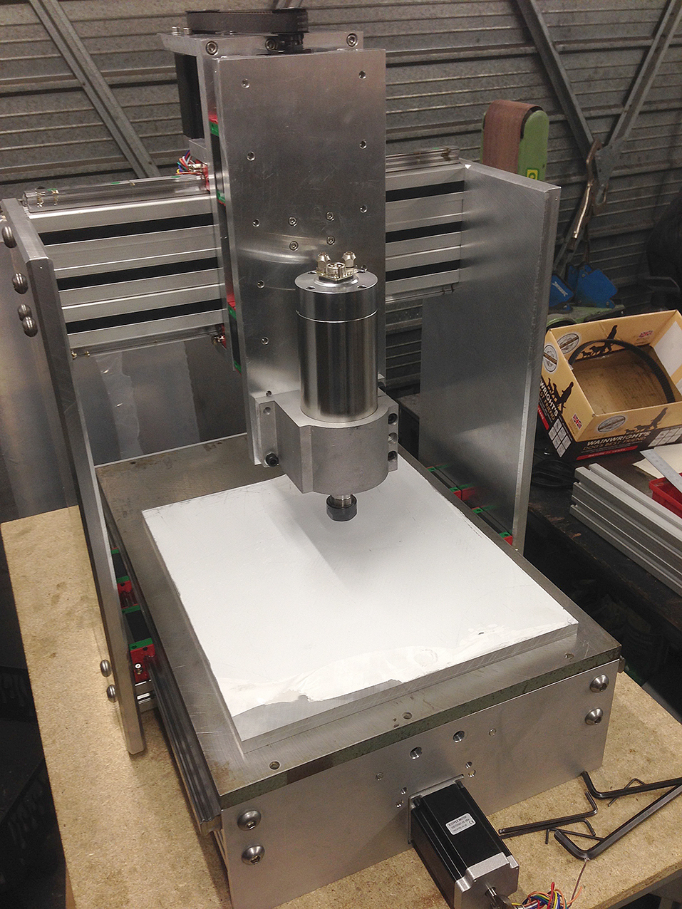

    Cut area - 400mm x 300mm
    Z axis clearance - 100mm +
    X & Y axes speed - 5000mm/min
    Z axis speed - 2500mm/min
    Heavy Aluminium build
    Cast iron machine bed with replaceable 15mm aluminium working bed
    HiWin 20 Linear rails
    HiWin Carriages with extra chip-wipers and seals fitted
    1610 rolled ball-screws on X & Y axes
    1605 rolled ball-screw on Z axis
    4Nm Nema23 stepper motors, belt drive at 1:1 ratio
    DSP Digital stepper drivers
    CP0-10v Breakout board
    UC100 USB controller
    48v Motor PSU
    24v Control PSU
    2.2kw Water-cooled spindle with ER20 collet chuck
    ER20 Collet spanners and a couple of collets
    Schneider-Altivar sensorless-vector VFD with speed control via Mach3 of 8,000 to 24,000rpm
    Home-made mist lubricator/air blast
    All documents from build and some pictures.
    Dell PC included - set up and tested ready to go.
    Will need a license for Mach3 - not included.
    Uses custom "2010" Mach screen-set.

    Has been used for a couple of months - now replaced with a far bigger Bridgeport vertical milling machine.
    Offers around £2900 buyer must collect from Bishops Stortford, Hertfordshire.
    Stand is included.
    VERY heavy !!
