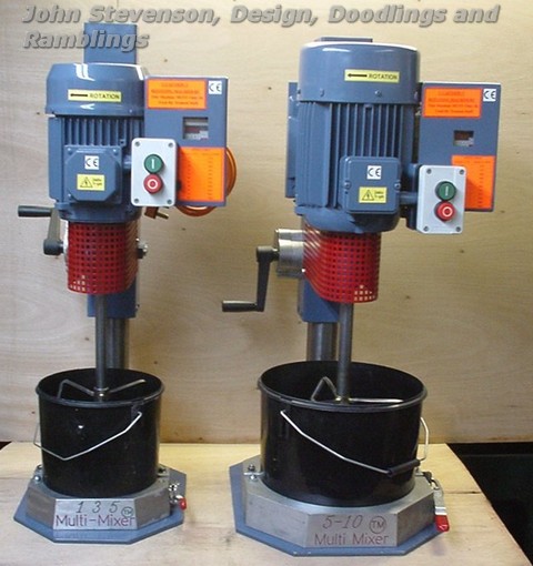

    Avery do some metalised labels for laser printing that will withstand oil etc.
    http://www.avery.co.uk/avery/en_gb/P...vy-Duty-Labels
    However when we used to make the Ink Mixing machines we just colour printed a label and then laminated it making sure we had a laminate border round the label so liguids couldn't get in then double sided taped them onto the machine.
