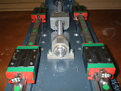

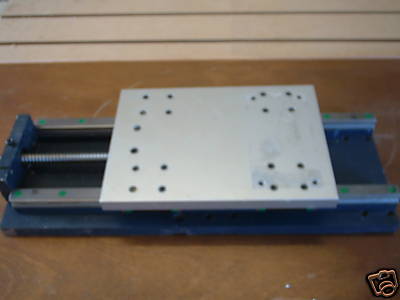

    Anyway what started me actually getting on with it was more or less impulse-buying this on ebay:
    Slide/ballscrew assembly on Ebay
    Got it a few days ago and looks pretty good, slides are in great shape. Ballscrew (16 x 5) is rolled and has a few tiny bits of pitting but it'll serve for now.

    Anyway those NB slides will sit under the X axis Airy points on a 20mm+ thick alu plate which will be the machine baseplate (approx 350 x 450). Will be trying to find an affordable bit of flat tooling plate type alloy for this as my milling machine only has 250mm or so of travel so I can't easily accurately machine flat the 400 mm Y slide bases.
