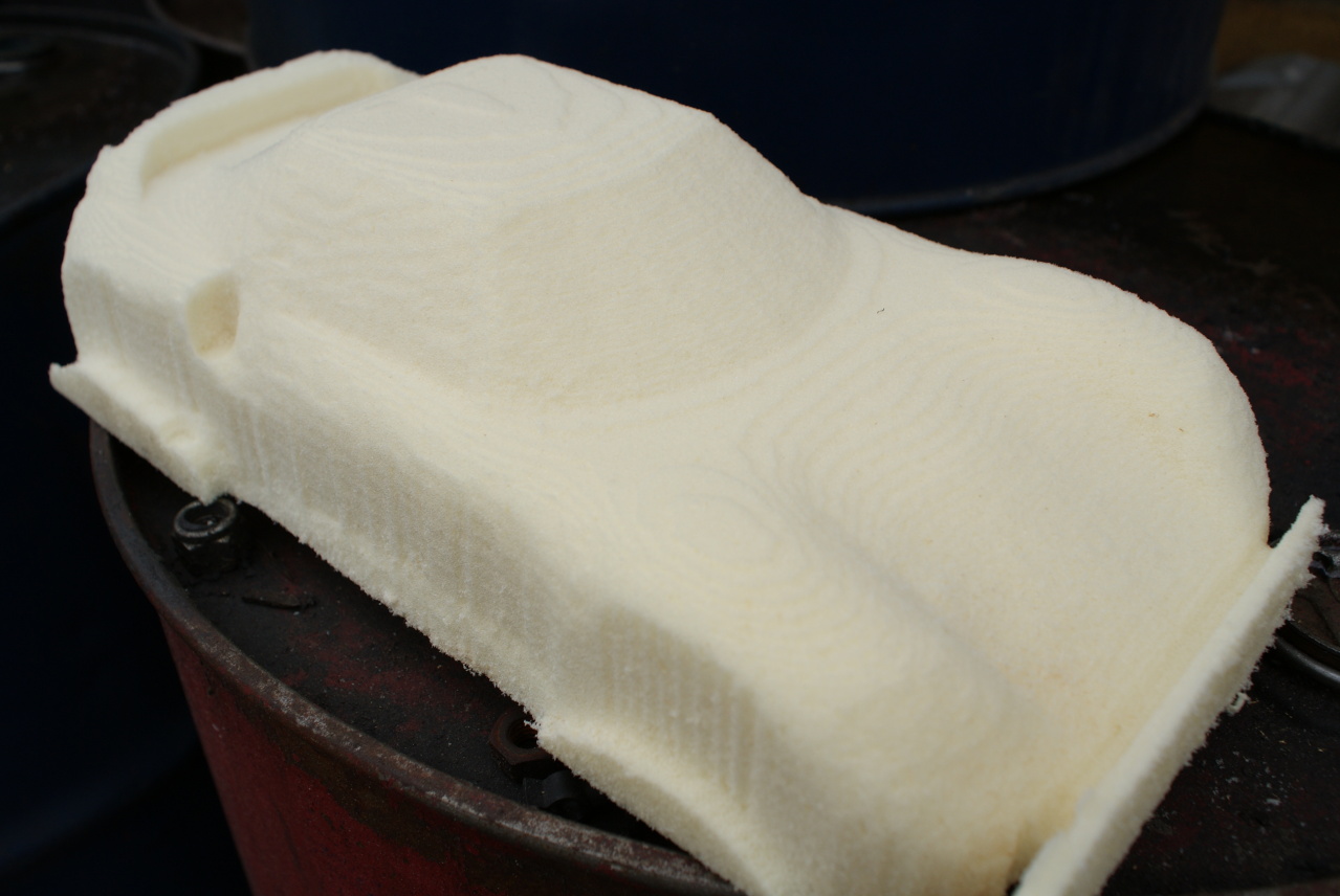

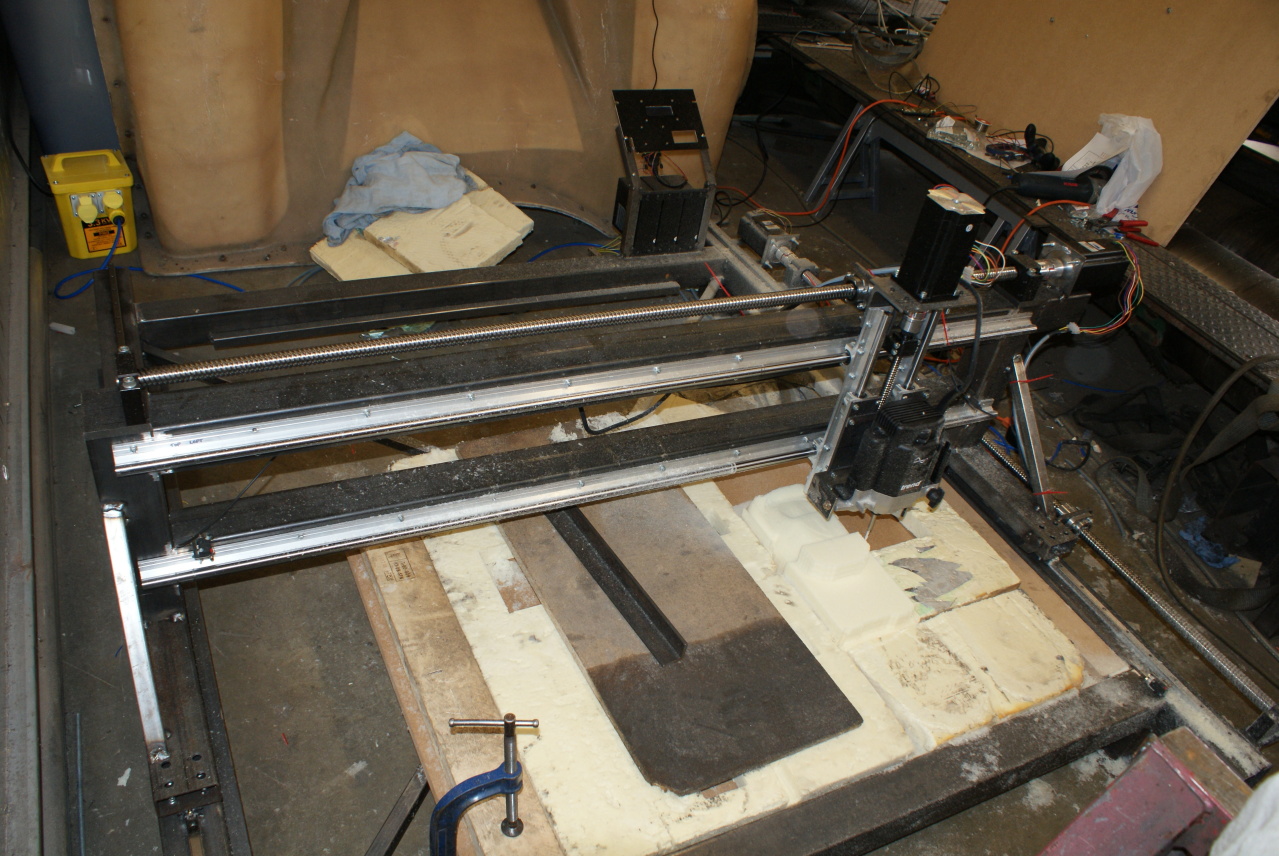

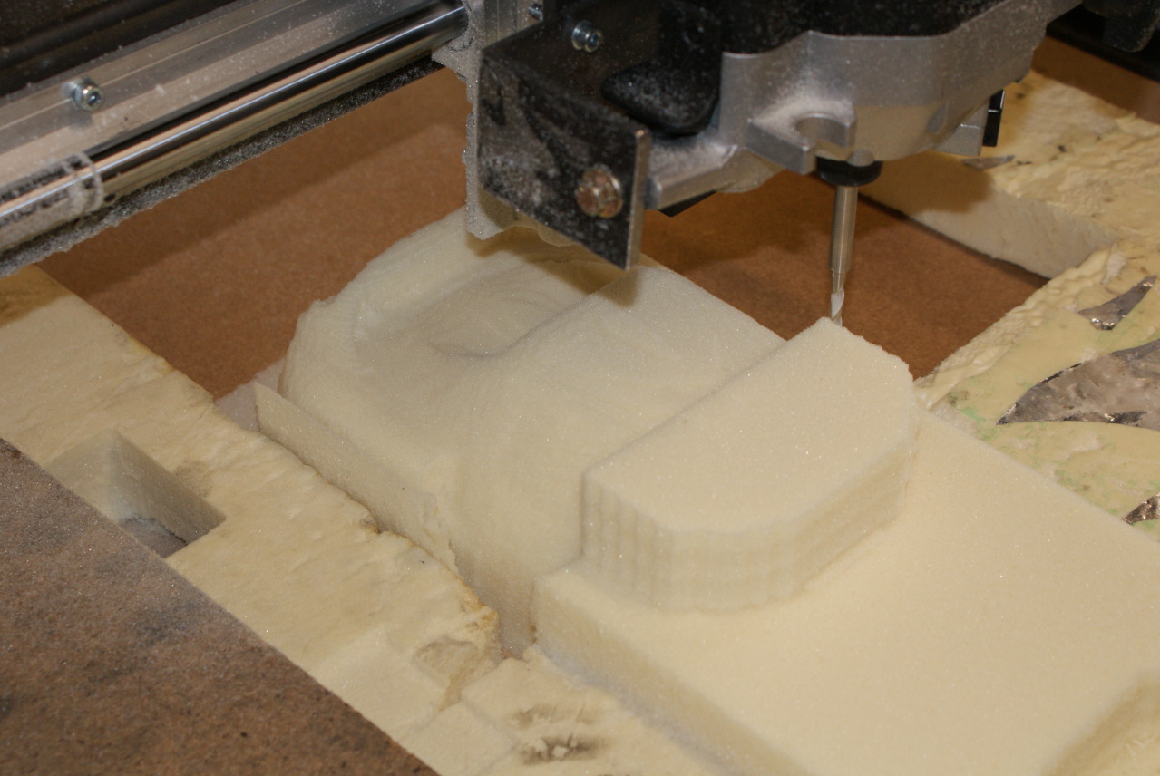

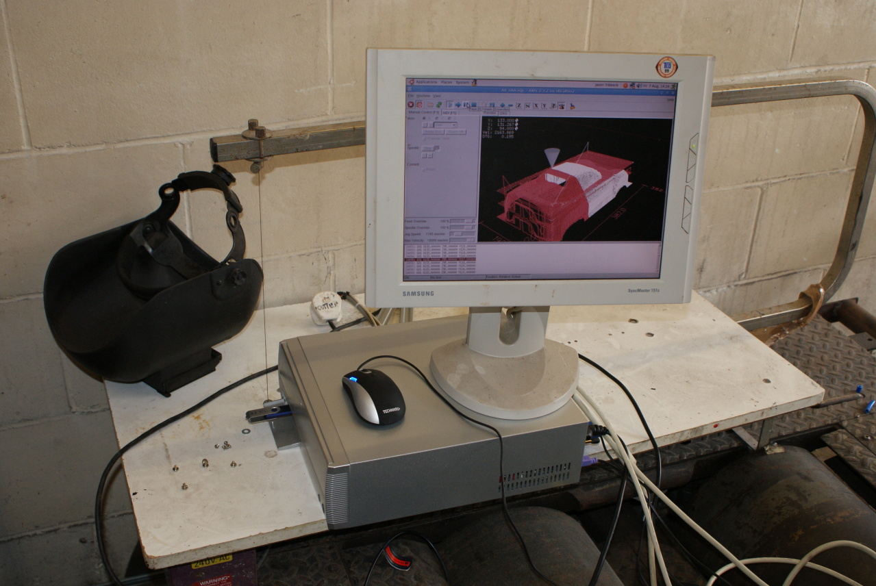

    Okay, my 10 days are up - and it works (but needs a bit of tweaking).
    Here's some pictures of it in action, and also the finished test item.
    ETA: Or rather as finished as it could be before the tool fell out (it wasn't in very far into the collet [deliberately to give me some extra length]). That's why the front isn't finished.
