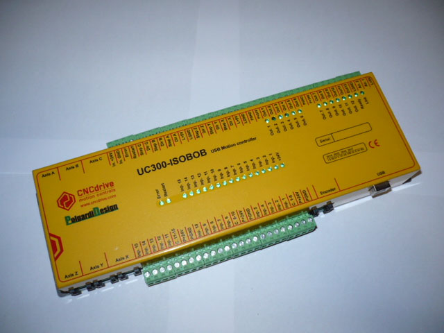

    Still need BOB's or Isolation Lee they MB only provides headers which arent Optoisolated.
    One thing that baffels me with this Company is they provide good hardware that is stable and with decent software/backup provide it on Motherboard with headers but then cripple it by not providing isolated I/O system that can handle 24V.
    It wouldn't take much more effort or cost to add this and make it much more usable piece of hardware. I would use them in heart beat on machines I build if didn't require BOB and ran from 24V not 5V.
    Shame.!!!
    They designed and built a prototype two years ago, but had to shelf it at the time, as they were too busy working on their software and their ethernet boards. Hopefully at some point they'll get back to it.
    If enough people ask them for it, maybe they'll get to it quicker.

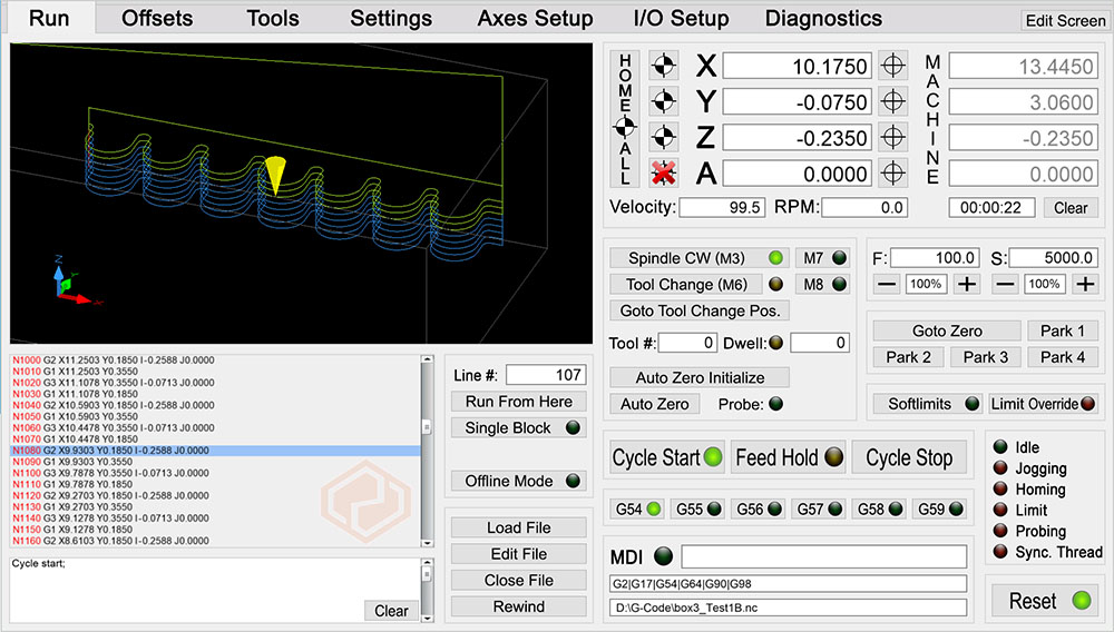

    Here's a preview of my upcoming UCCNC Screenset.
    Similar to the Mach3 2010 Screenset, but more modern, and more features and user control.
