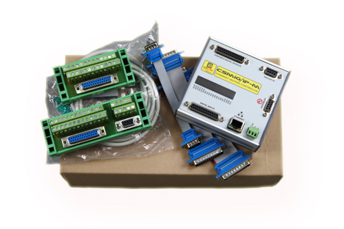

    Not sure i'm bothered about them wanting to sell BOB's, I'm sure there will be benefits to using physically separate units, the option of using your own and the features that you may get with one but dont get with another, for instance...
    HANG ON A MO?
    The IP-M come's with separate BOB's/cable's anyway so what's the biggy?
Name:	IPM karton mały.JPG
    Sure the isolation, handy little relay and what ever else they bundle is all nicely tucked away in that pretty little grey box they call the IP-M, but you still have to access that lot with a bob/boc....
    SO....WHAT'S YOUR BEEF FAM?....
    with having separate units in a UCCNC based system?

    HANG ON A MO?
    Sure the isolation, handy little relay and what ever else they bundle is all nicly tucked away in that pretty little grey box they call the IP-M,
    The cables you mention are just terminal blocks to make connection easier and not like BOB at all.
    Stabilty is all about Layers or more specificly removing layers. BOB's or to be more specific Cheap ones are just Weak Layer which cause trouble.
    Don't understand why folks will buy Motion controller for the higher cleaner pulse rates then strangle them by connecting to Cheap BOB with Slow Optos etc.?
    It's this and other electrical incompatabilty's that come into play which make multi mixed hardware systems less reliable than one that's been designed and tested to play nice together.

    HANG ON A MO?
    Try Specsavers, they are connector boards, DB25 to screw terminals and at least they supply the bloody things and don't just do a half heated job of fitting IDE sockets and leaving you to it.
