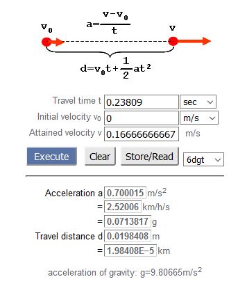

    I watched the video and frankly I wasn't impressed. You quote 10,000mm /min speed but on a machine such as yours you don't have the room and I'll bet it never gets over 2500mm / min
    I'm certain that a standard mill running a standard copy of M3 could do this file the same.
    Perhaps UCCNC is capable of more but it will take it to be installed on a larger machine than that. I feel the file doesn't do justice to the software
    I didn't post that video to impress you or anyone. Never the less, I don't think there are many DIY machines which run at that speed with only direct stepper motor driven single 1605 ball screws on each axis. Most people when they want speed in this range use belt and gearbox, dual screws, higher pitch, servo drive and so on. I seriously doubt that there are many Chinese moving gantry machines which reach more than half of this speed. Never the less, this is not a pissing contest, so I don't care if you are impressed or not.
    As for the maximum REAL speed of my machine, again I think you are wrong, but I still have to measure that using real instruments, which I don't think I will ever do because as I said, it is not a contest and is not my goal to impress anyone.
    Anyway, just for the sake of discussion and for answering your claim, UCCNC and Mach3 both display the speeds, in this video at least once, at the 40 second mark you can see it reaches 10,000mm/min. If my calculations are right then with 700mm/s/s acceleration I am up at 10,000mm/min after 19.8mm. Watching that video frame by frame shows 33mm for the Y to move from 170mm down towards Y0 before it reaches 10,000 (you can see it in the FACT message box) and deceleration starts at the Y 19.18 mark, which is almost like my calculation.
    Remember that the frame rate of the video is not high enough for accurate measurements, but I am pretty sure it is correct as far as the top speed is indeed reached at some point, probably long before the 33mm travel of Y. Also, the settings used was constant speed, which probably affects the distance needed as well, but never the less, I am sure that I actually reach 10,000mm/min. Also remember that this drawing is only 170mm Y movement, and my table is almost twice that size if I need it to be.
    The 2500mm/min is the feed rate for the pen when the pen is down, not the rapids, which is obvious from the video as well.
    I am aware that my machine is tiny by your standards but again, it does not matter. It is large enough for me, weights over 80kg and it takes up more than enough space as well. Lastly, it definitely beats most, if not all the kits which can be bought with similar table size, in terms of speed and real accuracy, but regardless, it is NOT a competition against anyone else.
