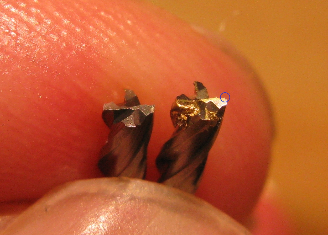

  3. #22

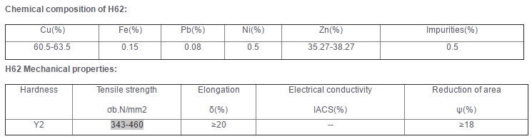

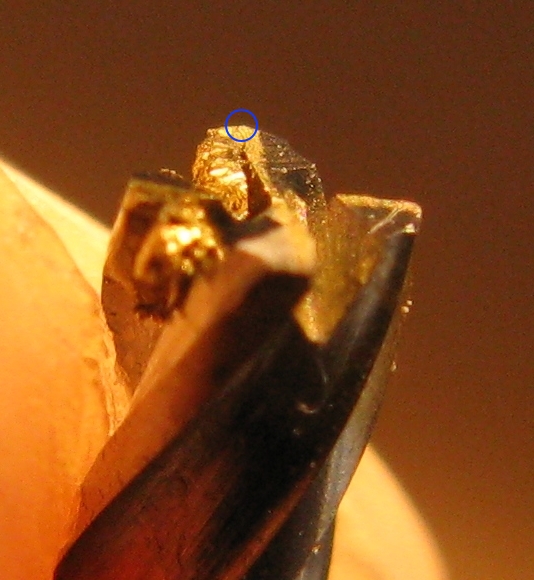

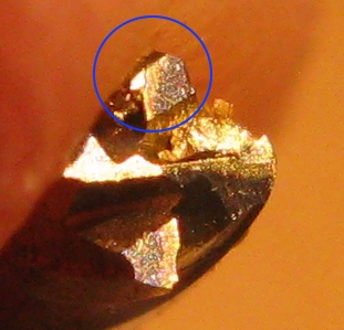

    Well, I'm not having much success here. I don't have my compressor yet so I thought I'd try a HSS/8% cobalt end-mill (4 flute, 7 mm flute length, 6 mm diameter shaft) which requires a lower speed. With the tool sticking out 20 mm to avoid my clamps, I've taken the HSM Advisor recommendations and then backed them off, so 5 mm/second feed rate and 0.5 mm depth of cut, tool running at 14000 RPM as recommended. As a reminder I'm cutting a slot in [343-460 N/mm2 tensile strength] brass plate.
    Result: tool snapped off in the middle of the first pass. It looks as though the tips have worn quite quickly and then the tool has become clogged with brass:

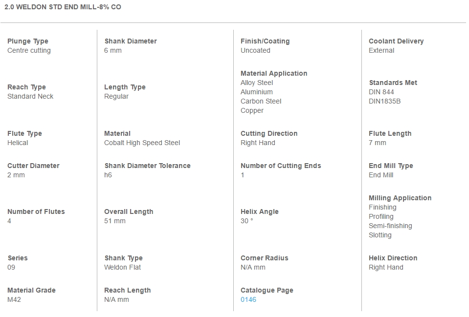

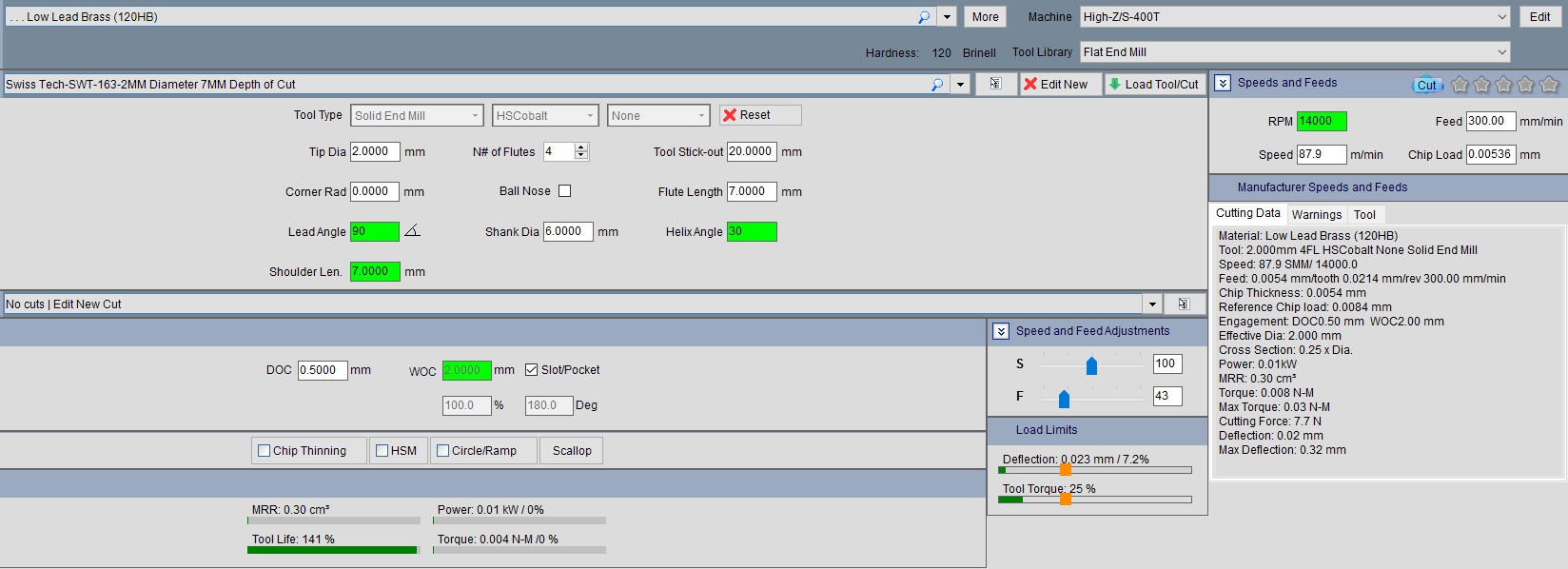

    Here are my tool details, material details and the HSM advisor screen to match. Where am I going wrong?

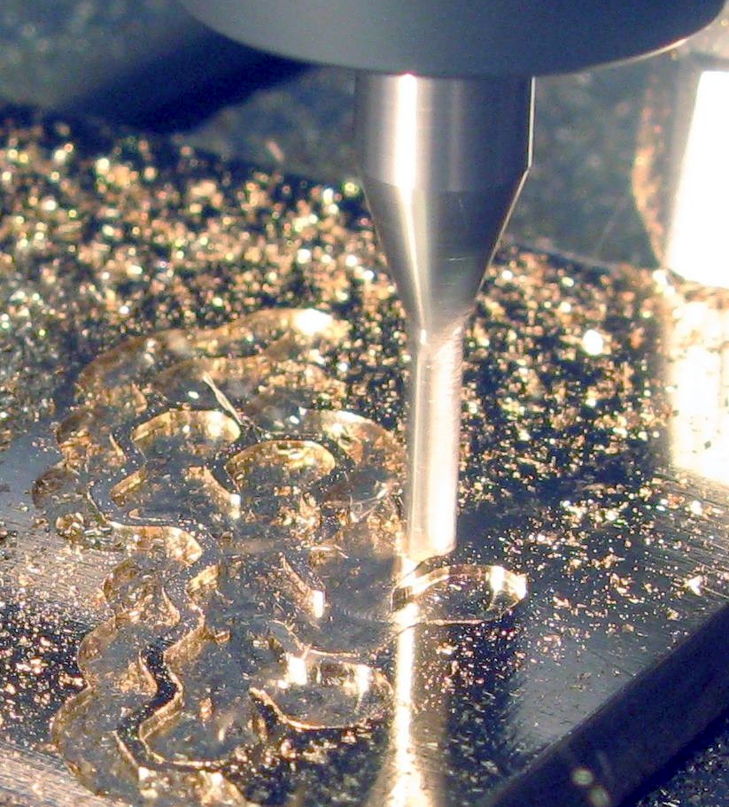

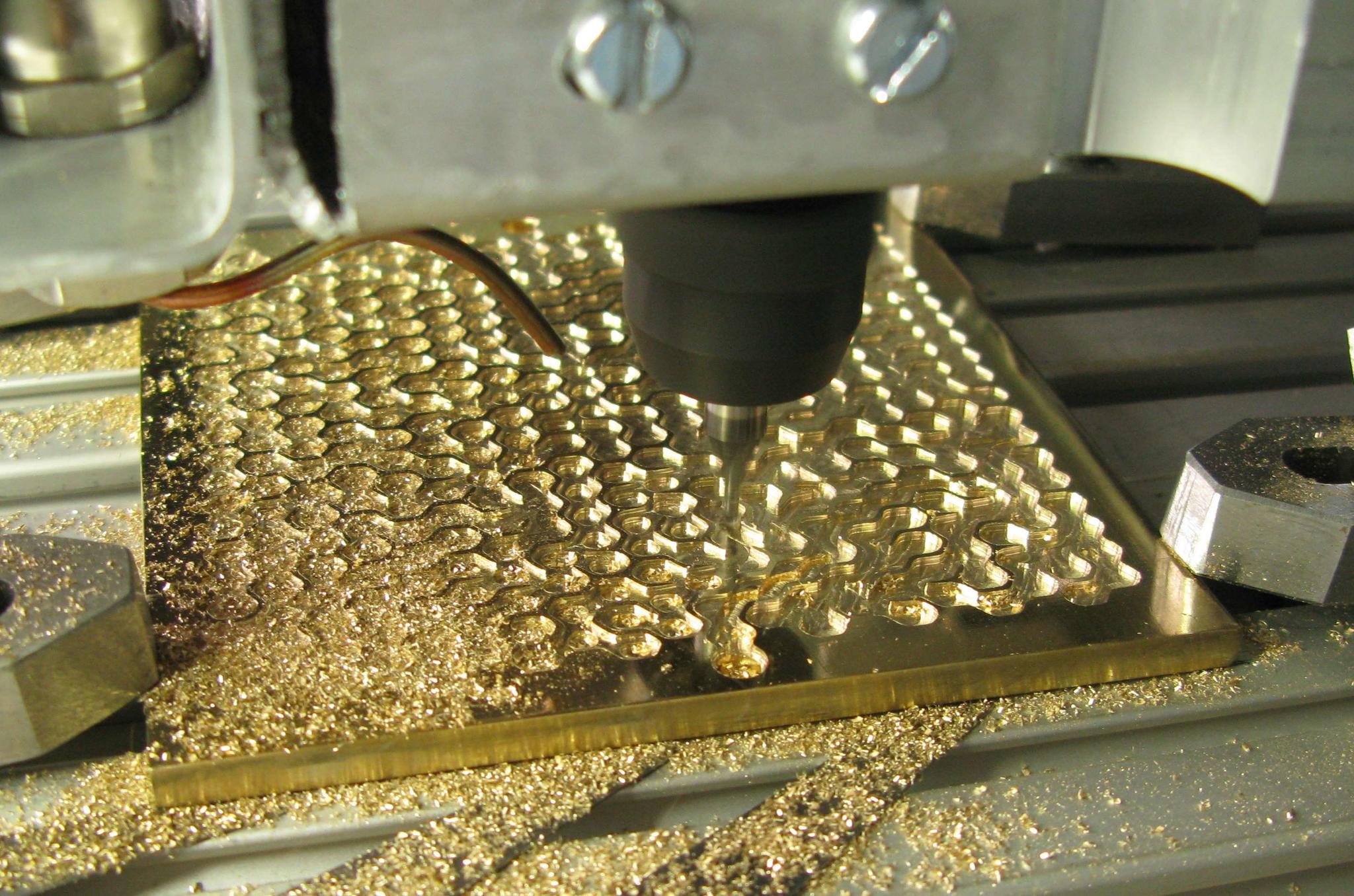

    FYI, until it snapped, it appeared to be making quite a reasonable cut:

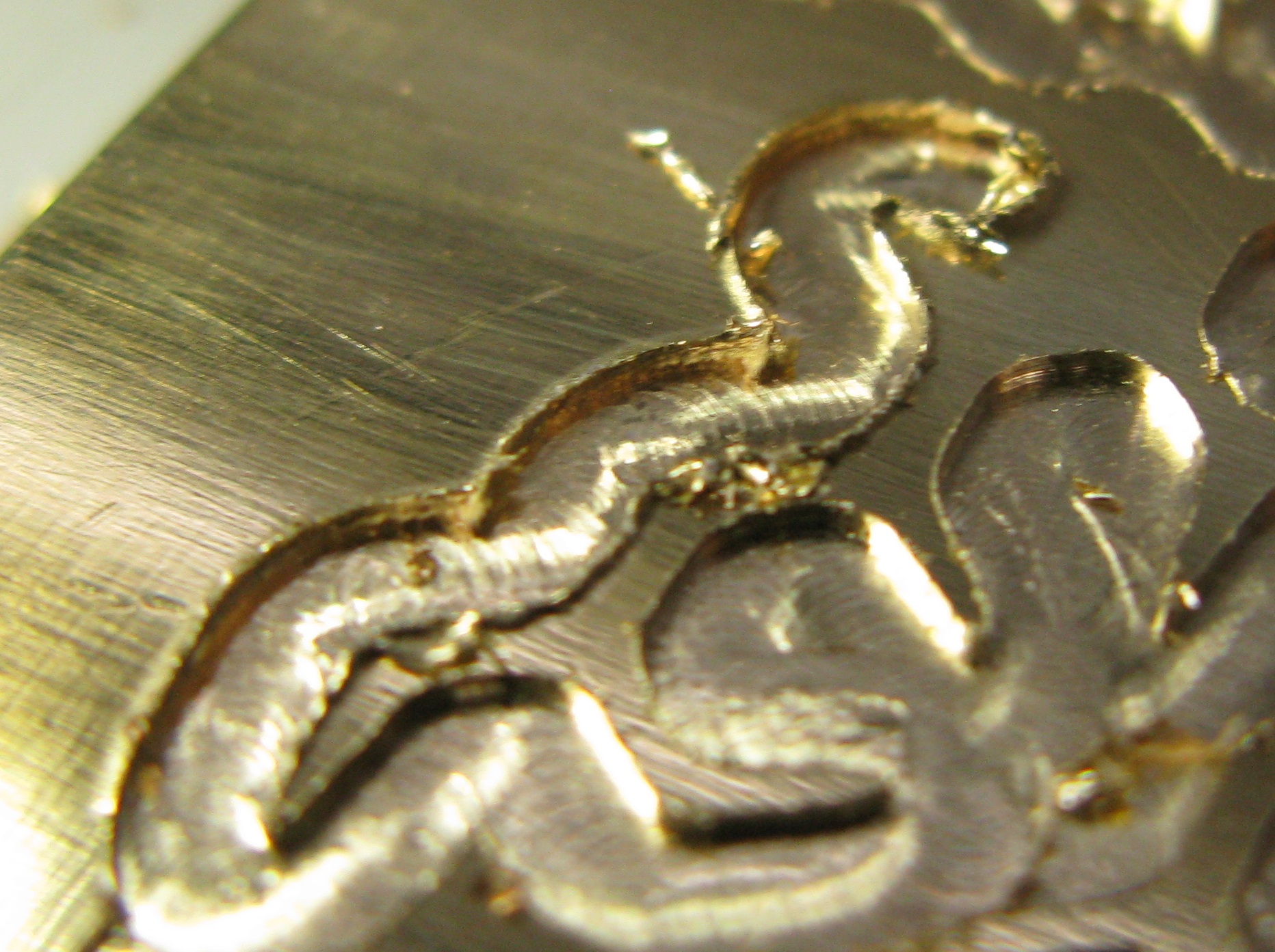

  6. #24

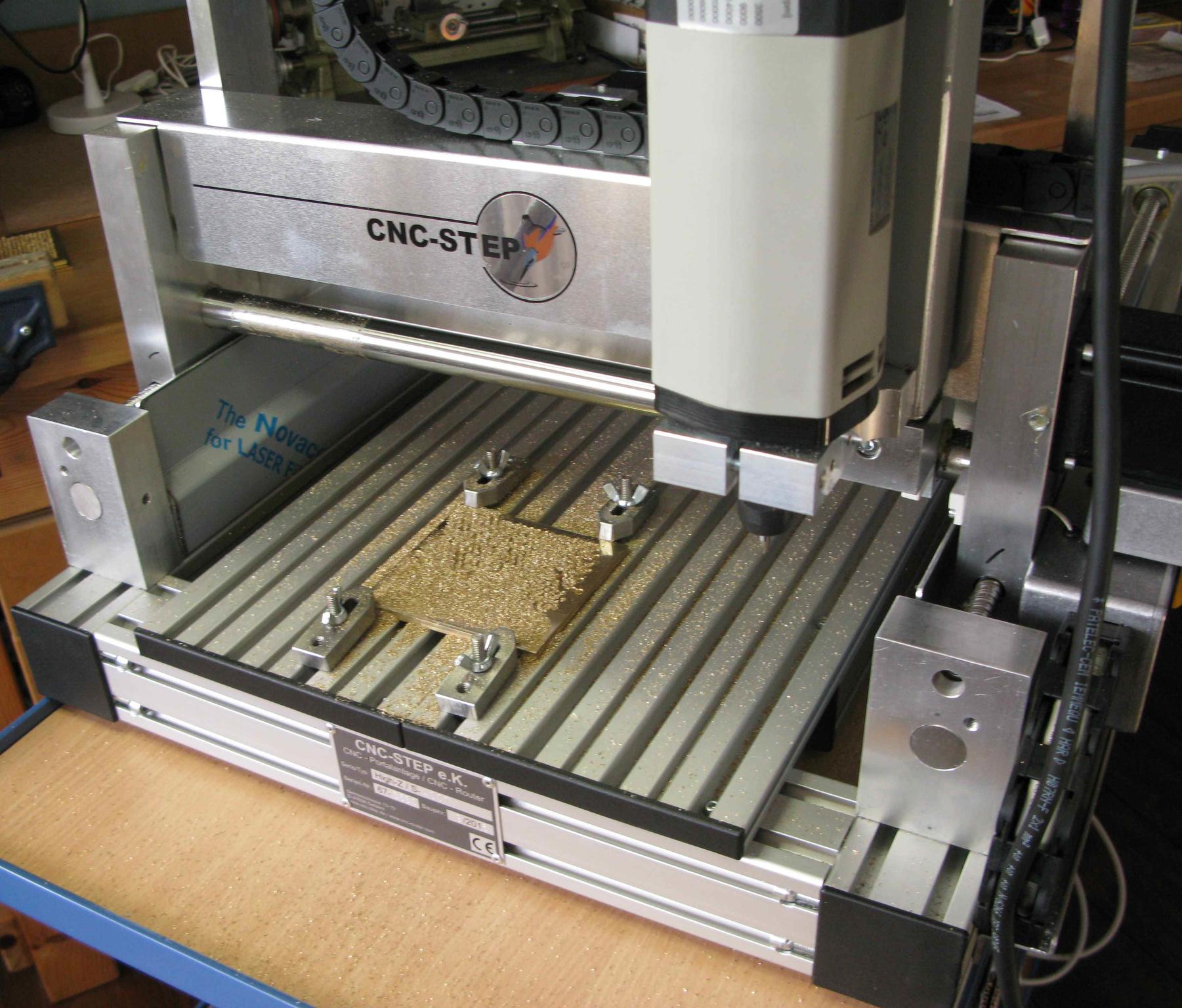

    Thanks for the swift response and offer of help, here's some more detail. First, the machine (High-Z S-400/T):

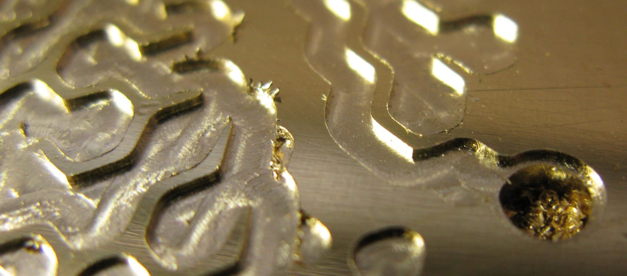

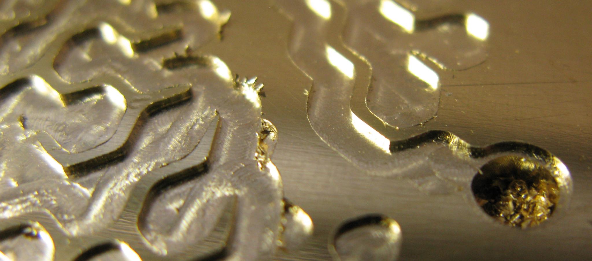

    Then the cut; left is early on when some clear-outs are being cut, middle is at the start of the slot-cut (where the right-hand side of the picture is the earliest, the left-hand side is several minutes later) and finally right is the slot-cut just before the bit snapped:

  7. #25
    From the third photo it looks like you have issues with rigidity. Your machine has unsupported rails on all three axes, so this is shouldn't come as a surprise. That shouldn't mean you can't make this part though, just makes it more of a challenge.
    Is the tool plunging too fast? Ideally it shouldn't much at all.
    Have you checked the runout of the spindle? With such a small tool this may have an effect.
  8. #26
    The machine purchased was specifically stiffened for cutting brass; at least, that's what they told me, there was an extra stiffening bar, out of sight up-top in the picture of the machine above, for this purpose. I have a feeling that the mess you see on that last picture is because the tool had degraded by that point and hence was rubbing. If the machine were too sloppy, I'd have thought the same mess would appear early on as late on (see right-hand side of middle picture versus left-hand side)? Maybe a better question would be: could lack of machine rigidity somehow cause damage to the cutting edges of the bit?

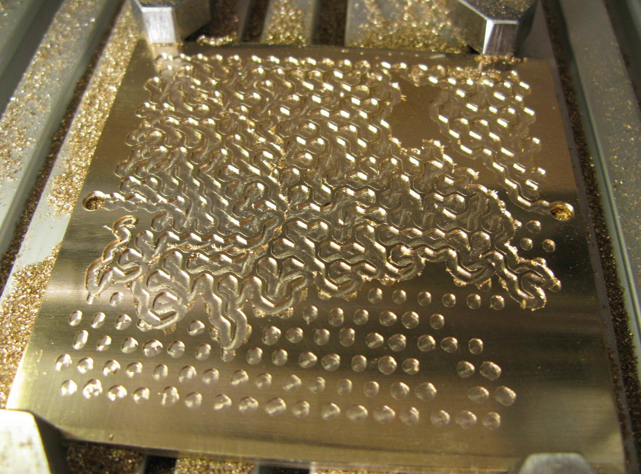

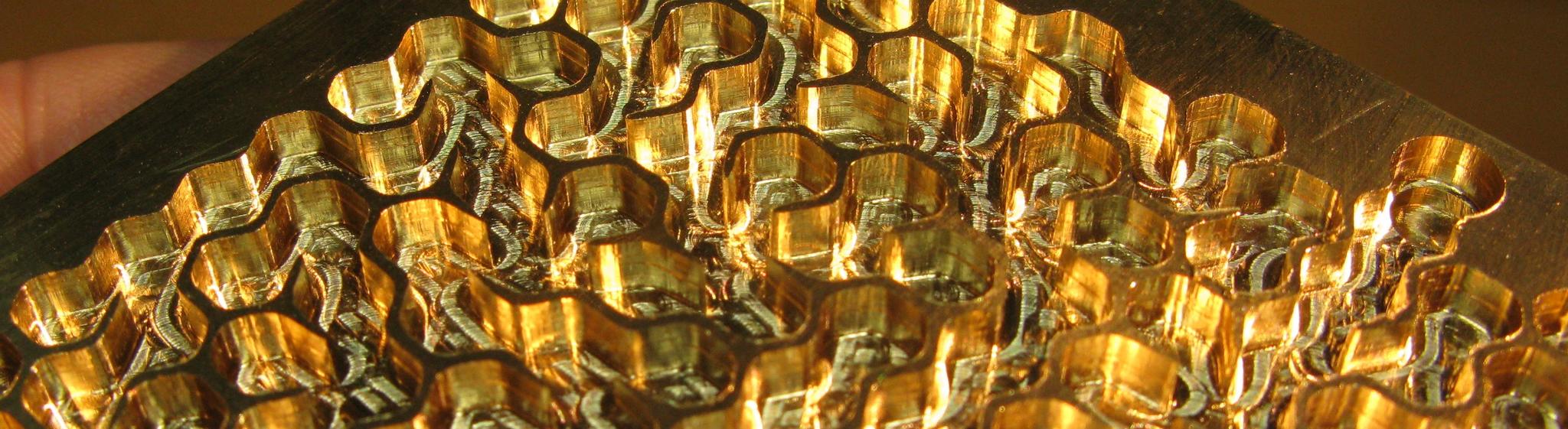

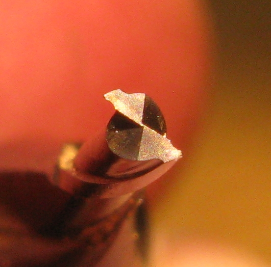

  11. #29

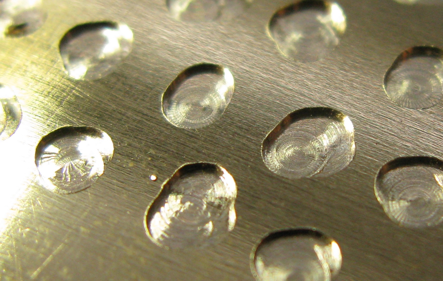

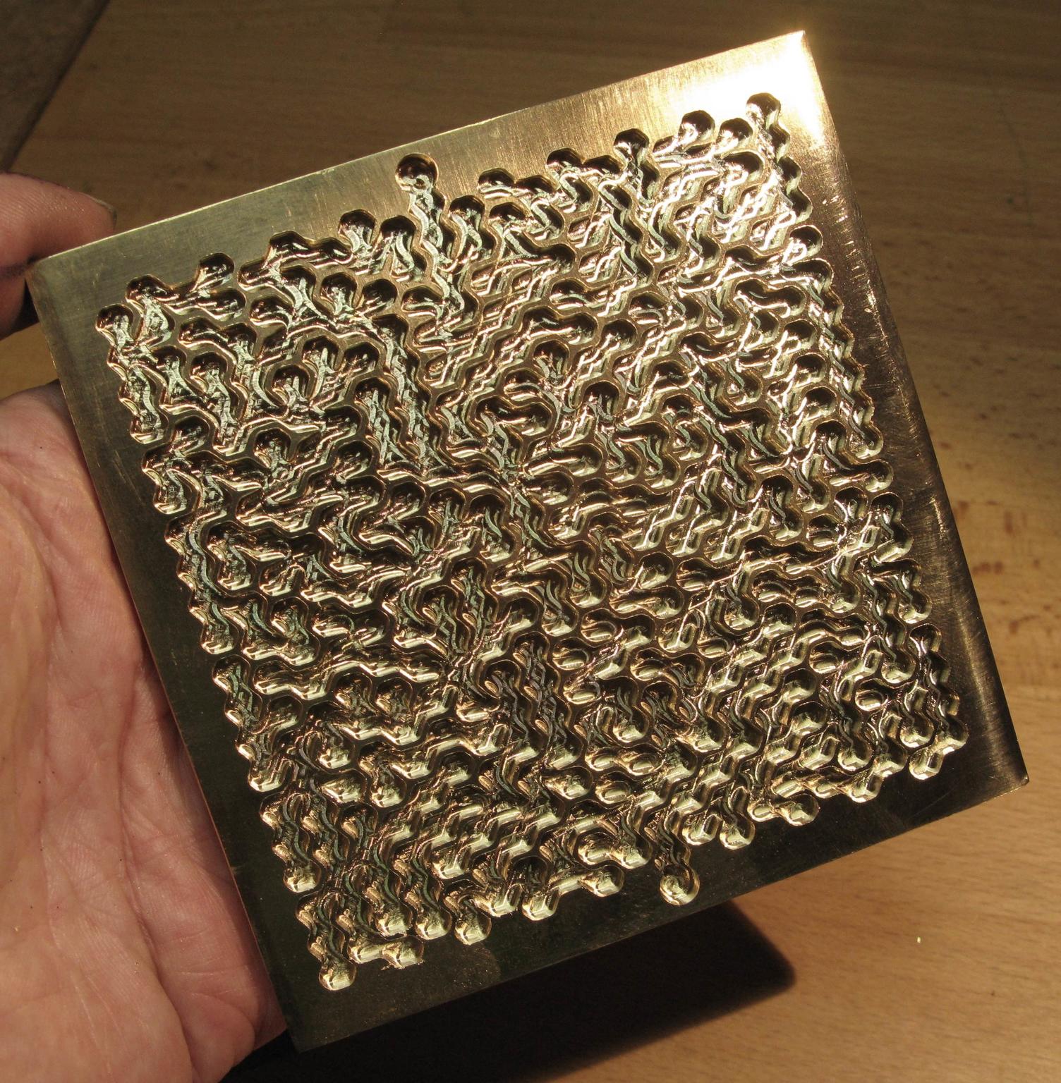

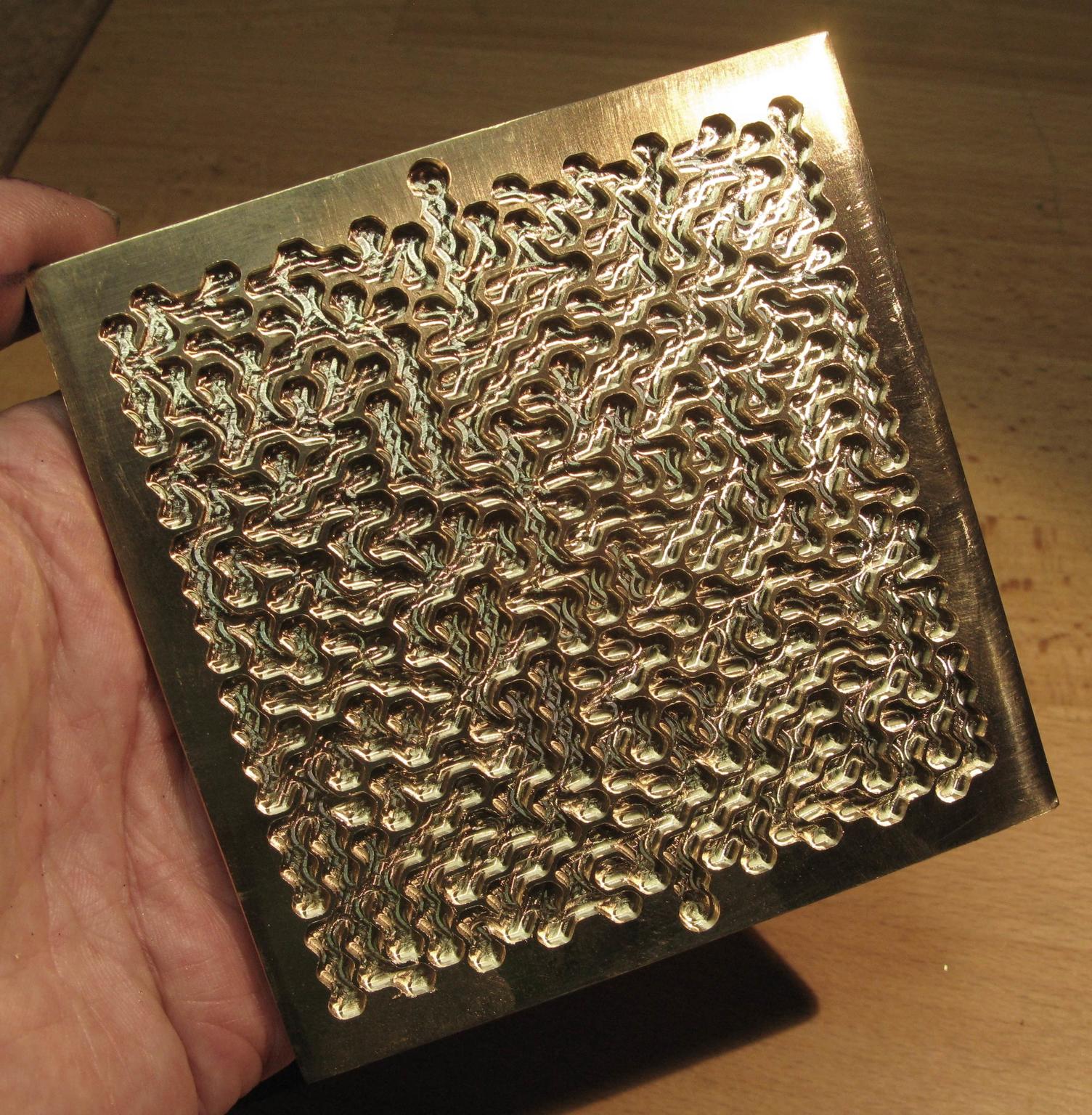

    To conclude this thread, I've now managed to cut the brass maze successfully. The secret was, as you probably expect, cooling. With a 1 mm internal diameter copper tube backing 2 bar of air pressure (no water, too messy for my loft) from a Jun Air compressor, cutting for 10 hours caused no damage to the bit whatsoever and the finish in brass is as good as that in perspex. I only applied the cooling during the looong cut around the side of the maze so as not to overheat the compressor but that was enough. Happy milling Christmas everyone!
