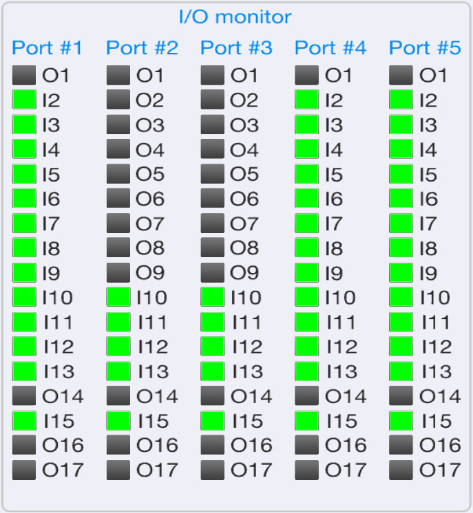

    If you run the UCCNC software in demo mode, and select the UC300ETH-5LPT, the diagnostics page shows you which pins can be used for inputs and outputs.

    With the 5LPT motherboard from CNC Drive, ports 2 and 3 are the same pinouts as standard parallel ports. (1-9, 14, 16, 17 Outputs ----- 10-13, 15 Inputs)
    Ports 1,4, and 5 use pins 2-9 as inputs. (1, 14, 16, 17 Outputs------2-13, 15 Inputs)
    It's just like using a parallel port, except that you have 5 of them.

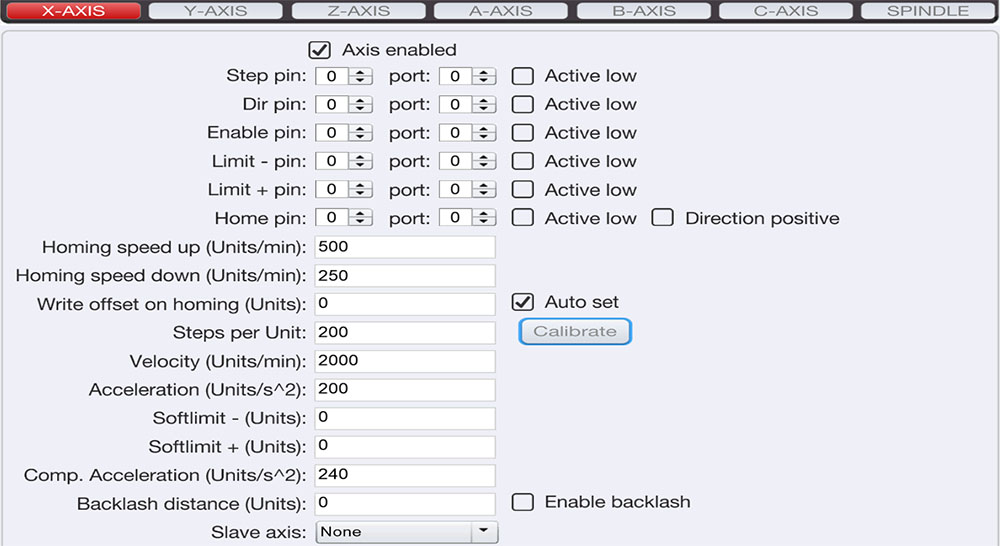

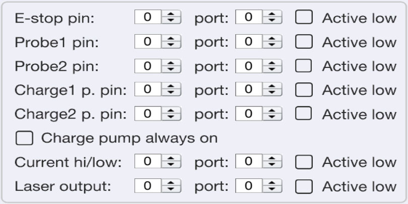

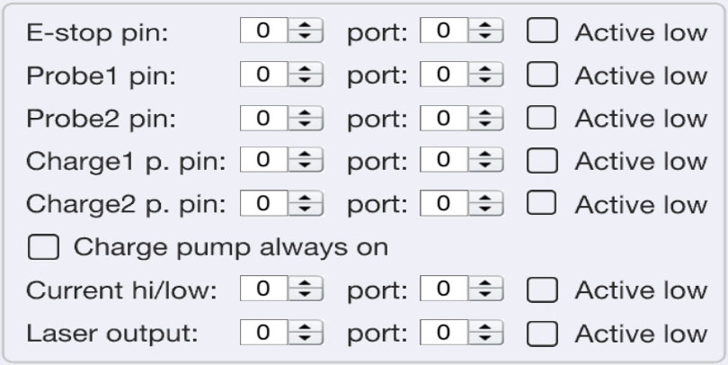

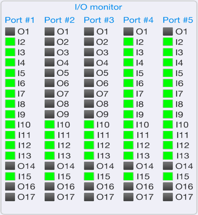

    Here's the diagnostic page showing the pinout, and some setup pages.
