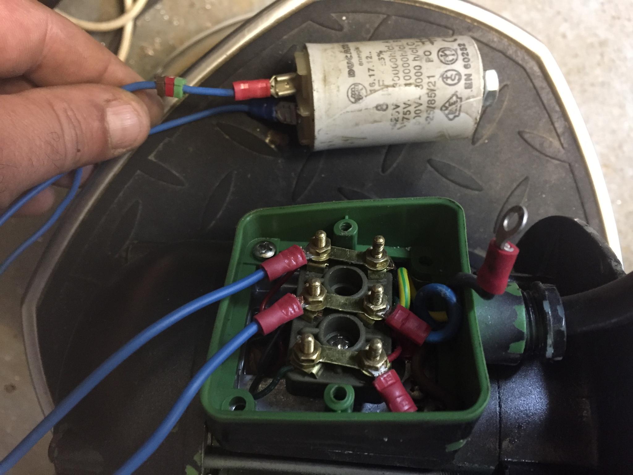

  1. Anyone that is running on single phase
    What did you do re coolant pump?
    Swap motor? Capacitor a phase to run single phase? Or install a vfd?

  5. Ok - re coolant pump
    Seems to work fine as single phase if wired delta- using just L & N
    Using a run capacitor of 8uf. Starts fine, runs quiet and straight up to speed
    :-) only had to cut a small notch in the wiring box to bring the capacitor cables out of.
  6. https://youtu.be/1uJpm7IN7-M
    shows a quick explanation of converting suds motor to single phase.
    note the spin direction was wrong so i reversed it by moving the wires around- correct in video
