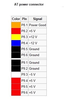

    note if you are replacing an old AT power supply
Name:	AT power connections.jpg

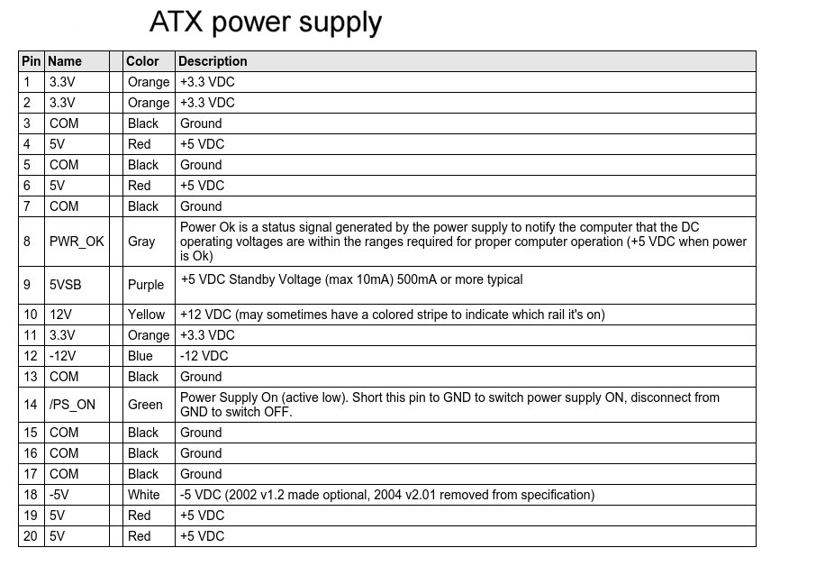

    with a new AXT supply
Name:	ATX power suppy connections.jpg
    the orange AT power good signal wire = the grey power good wire on the ATX supply
    don't get it mixed up with the orange 3.3V ATX output wire !!

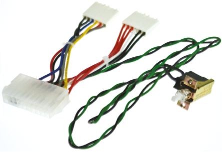

    ready made adaptors are available
Name:	photo of RS Components  214-739   ATX PSU TO AT Mother Board.jpg
