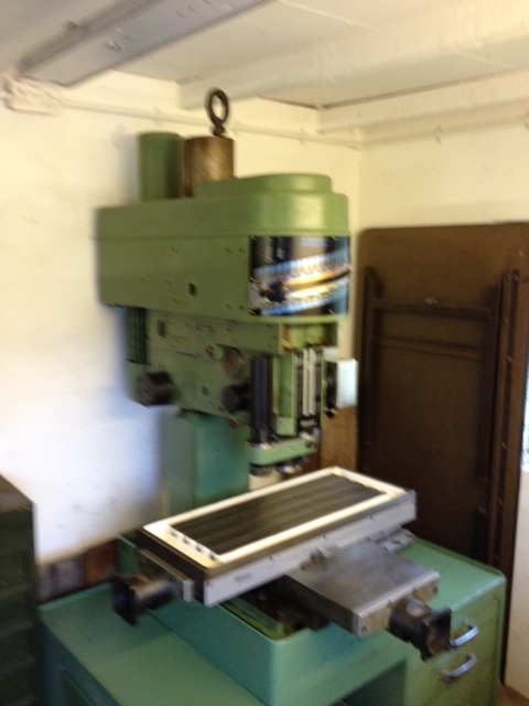

    Just to give some idea of the sort of machine - here's a (bad) photo:Click image for larger version.
    As you can see, it's a kind of mill-drill. But don't be fooled, this thing is a beast weighing in at about a tonne. The table weighs around 150kg - hence my 100kg load per axis estimate. The motors drive the ball-screws directly.

    Lives in East Lothian, United Kingdom. Last Activity: 1 Hour Ago Forum Superstar, has done so much to help others, they deserve a medal. Has a total post count of 2,992. Received thanks 376 times, giving thanks to others 9 times.
    My gut instinct for a machine like that with direct drive steppers, would be something in the 4Nm range to give plenty safety margin.
    I think personally I'd consider altering things to use a belt drive with some Nema23 steppers, which should give you better performance. With big Nema34 motors, for best performance you've really got to use high voltage drivers, but you're then still limited at torque drops of quite quickly with big steppers.
  11. #20
    Thanks. I had considered driving via a belt just in order to make the machine more compact. Would you gear up in order to increase the speed of the ball-screw relative to the stepper?
