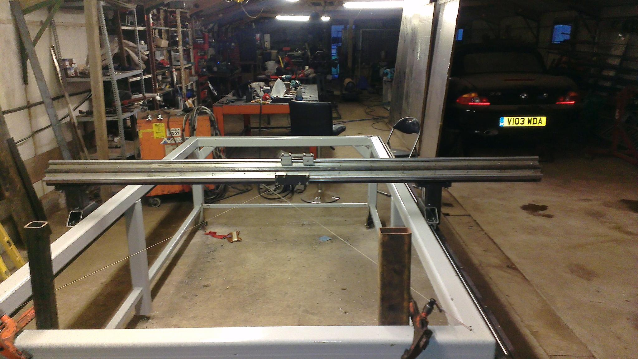

    i quite like the mixed slat idea!...im going to use 100x50x6 angle to support the slats which will be spaced 20mm away from the main frame so i can eventualy turn it into a water table with down draft air extraction...im planning to use magnets to hold the torch to the z axis so if it hits anything it will break away.............

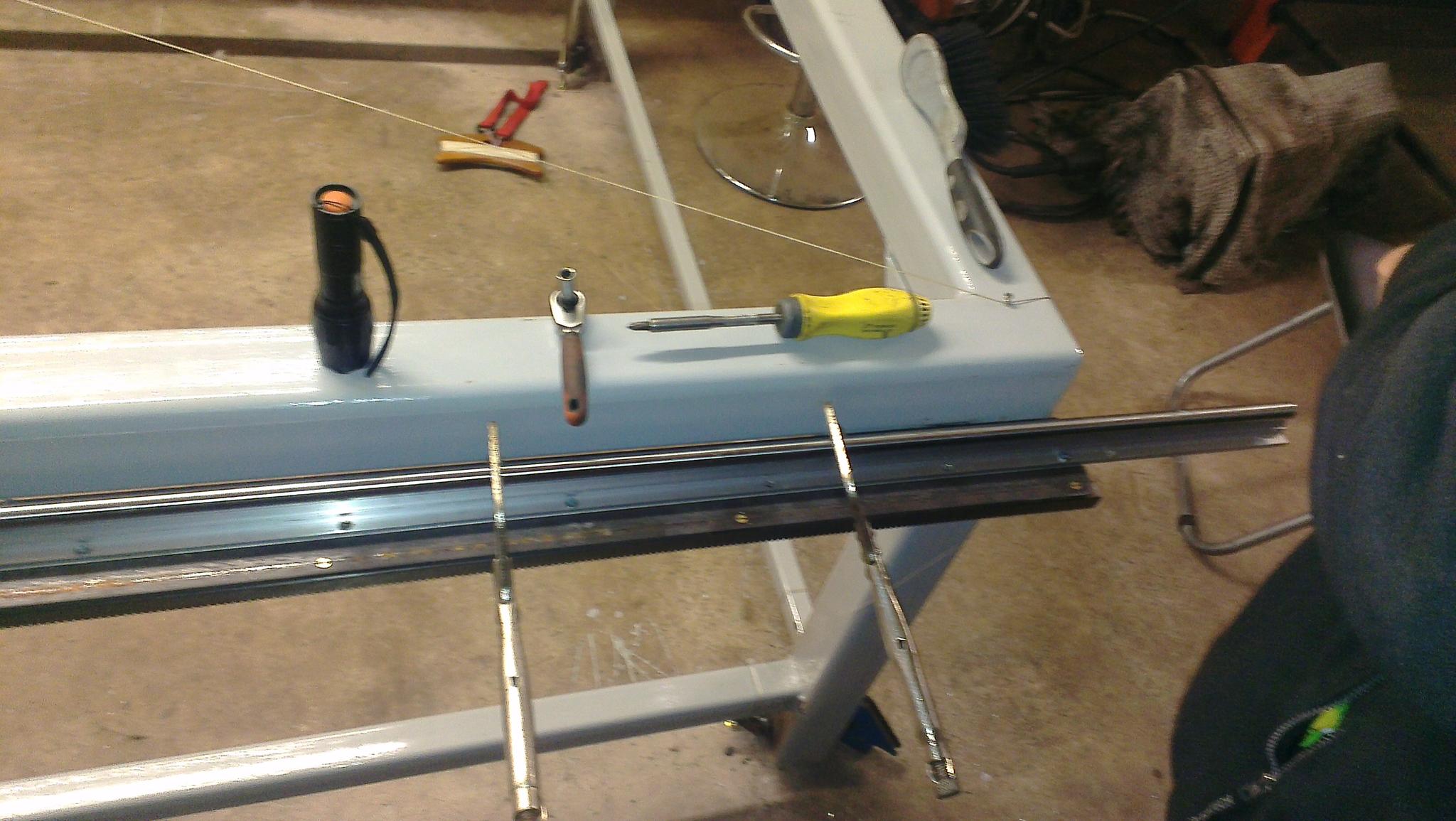

    had an evening of drilling tonight..managed to secure the first linear rail..then started fabricating the gantry

    managed to get the gantry mocked up today

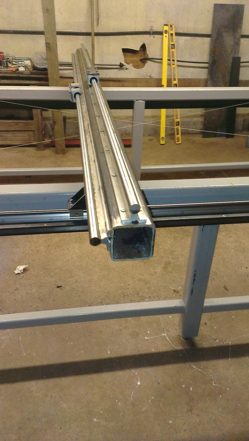

    only managed a few hours in the shed today...managed to mount the linear rails to the x axis gantry....lots of m5 tapping

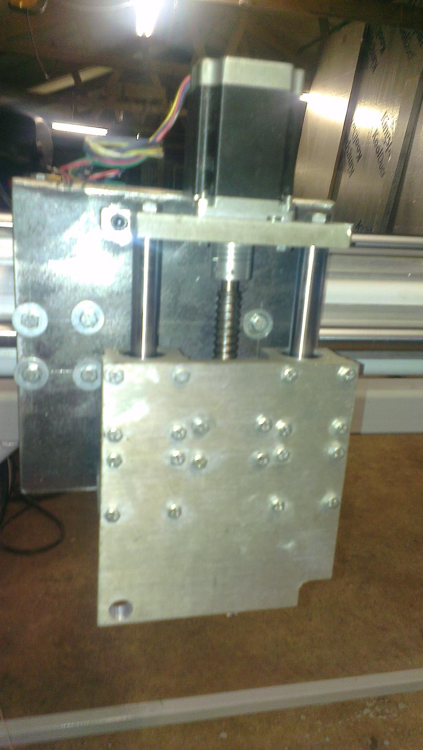

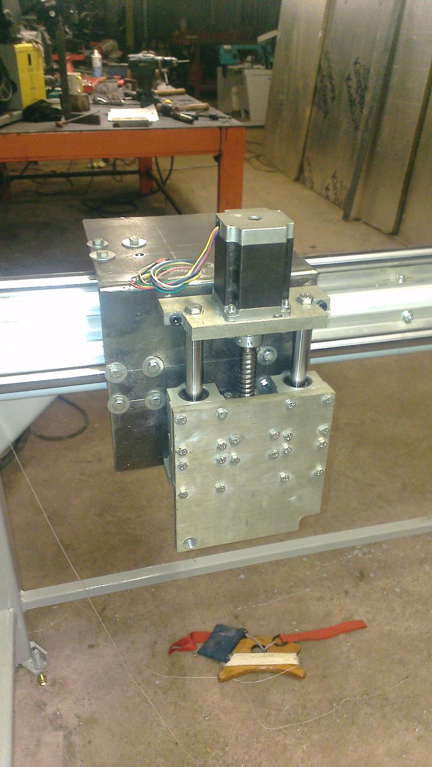

    iv managed to get the x axis painted..and the z axis pretty much finished. iv gone for two short lengths of 16mm linear rail and and old piece of ball screw..
