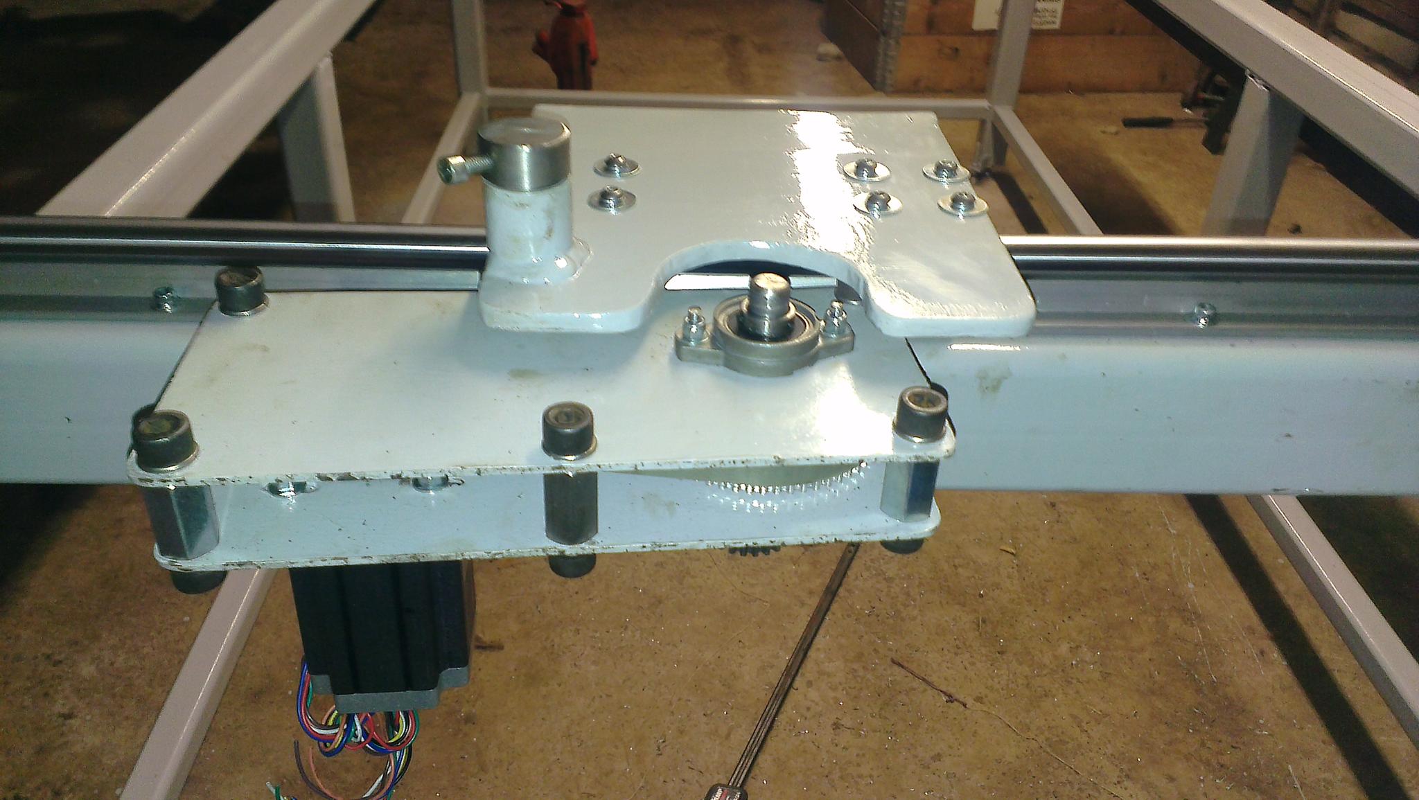

    hi, im going to use spring to hold the pinion against the rack,im using stainless steel to make the bush to pivot the reduction box (scrap prop shaft from a boat).........

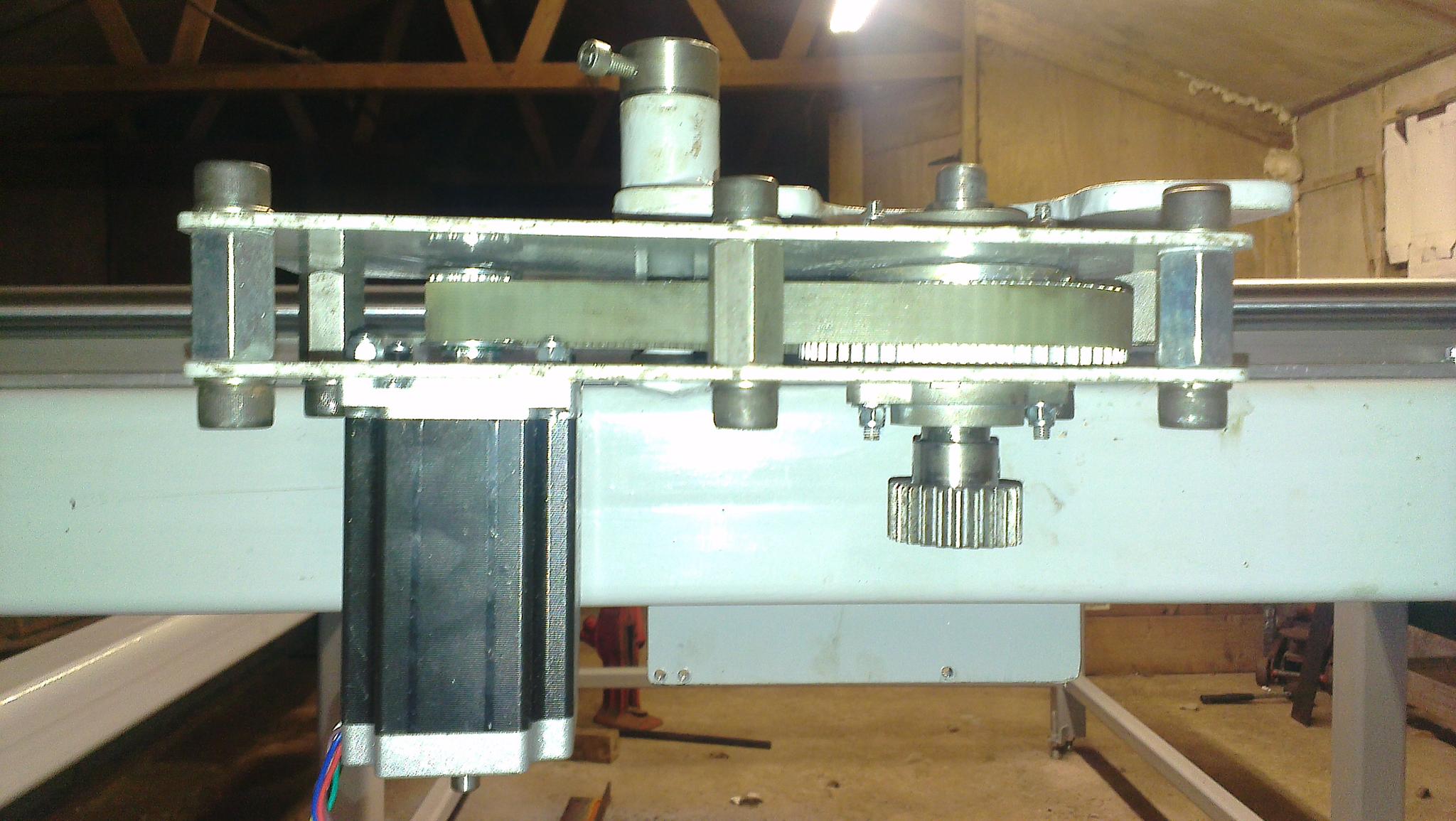

    managed a few hours today,

    for the (hopefully)final assembly iv drilled the shaft for the grub screws to bite into and for the pinion gear iv sweated the gear onto the shaft and used a roll pin,which im sure is very stable and wont come loose but now if i have a bearing faiure im going to have to pull the shaft back through the 60t gear and the other bearing,so im not sure iv gone the right way...

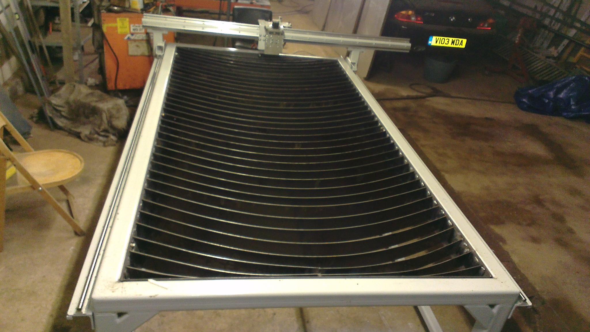

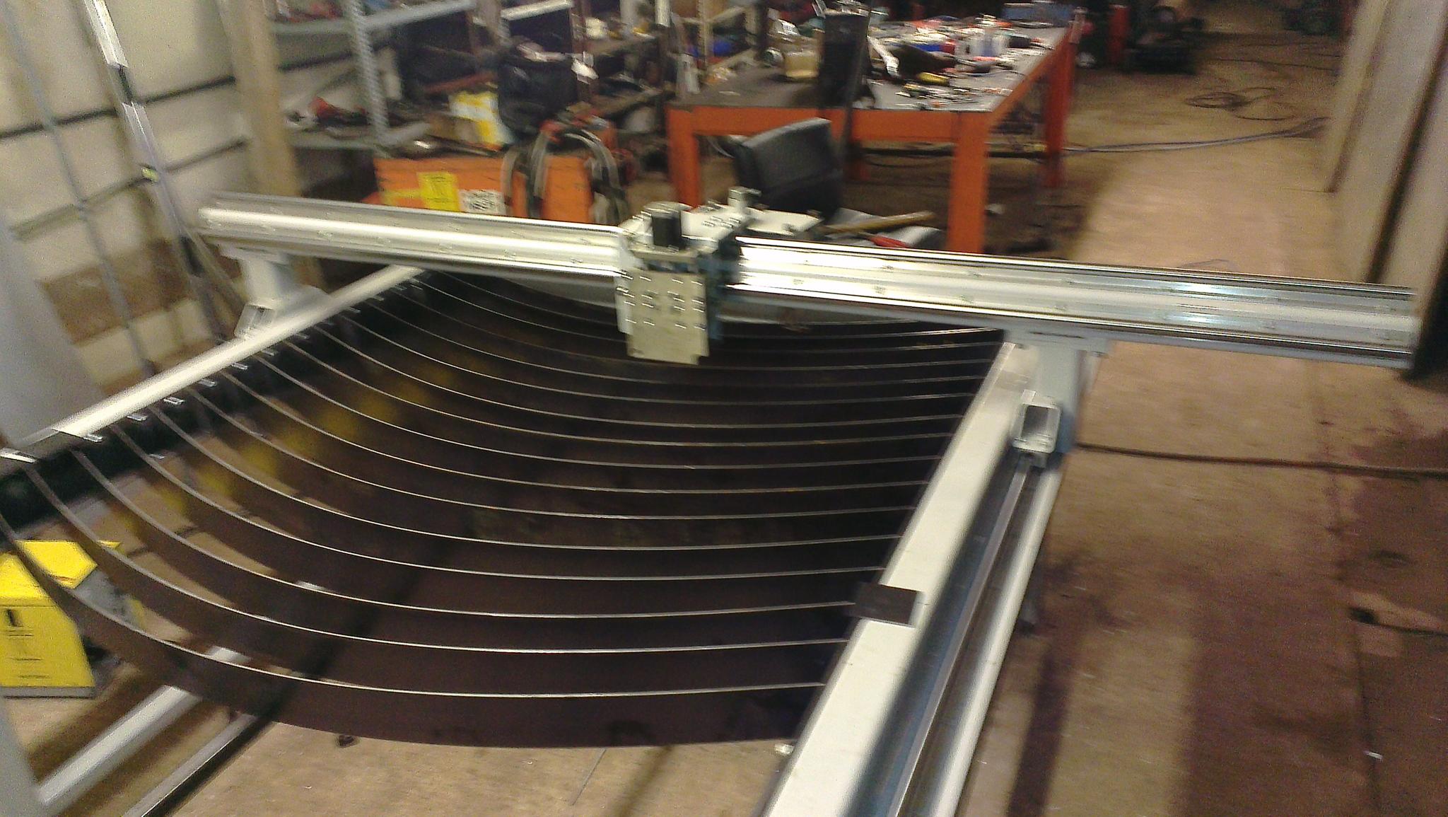

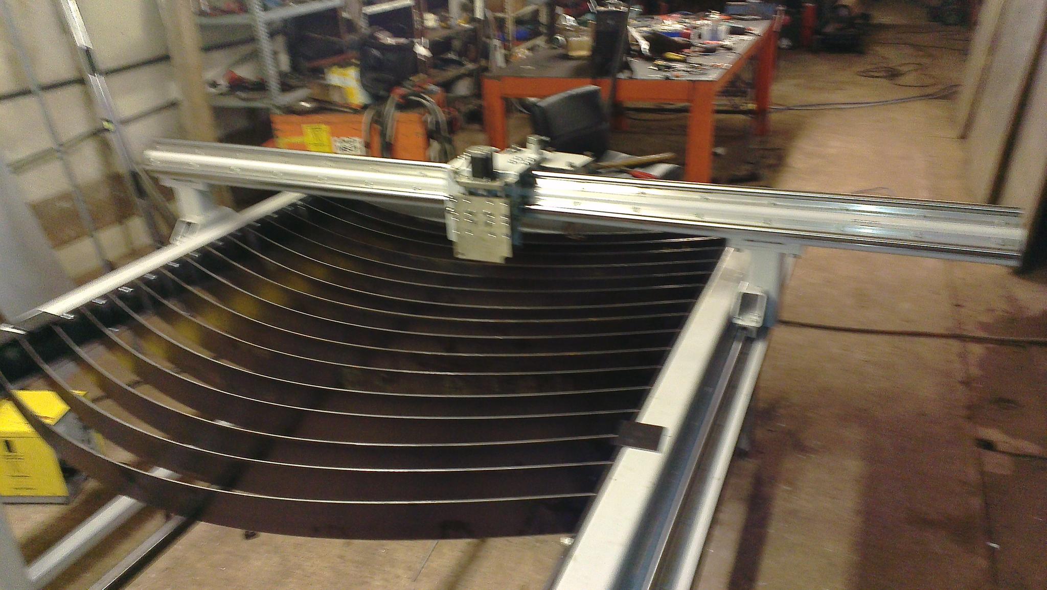

    iv had a few hours spare so iv finished the slats for the table....iv used 80x3 flat...
ID:	20047Click image for larger version.
  4. #24
    looking very nice.
    Have you thought of making a scraper/cleaner for the supported rails carriage?
    In the past I have used pot scrubbers ( cheap scotch-brite nock-offs)
    the flat ones .. Like these https://www.youtube.com/watch?v=kAv-pKD0Eug
    profile to suit the rail section.. Green side out. sandwich between to alu plates.
    I soak them in sewing machine oil prior to installation
    Paul
  5. #25
    hi paul,
    iv been thinking about some sort of scraper/gaurd for the linear rails..im ging to put an hour meter on the table so i can get an idea of how long parts last and cost of running.then i can work out if the for instance if the 16mm bearings will last a year and cost x amount and then they become a consumable? Or if its just a bad design and i'll need to rejig it....is plasma dust evil stuff?
