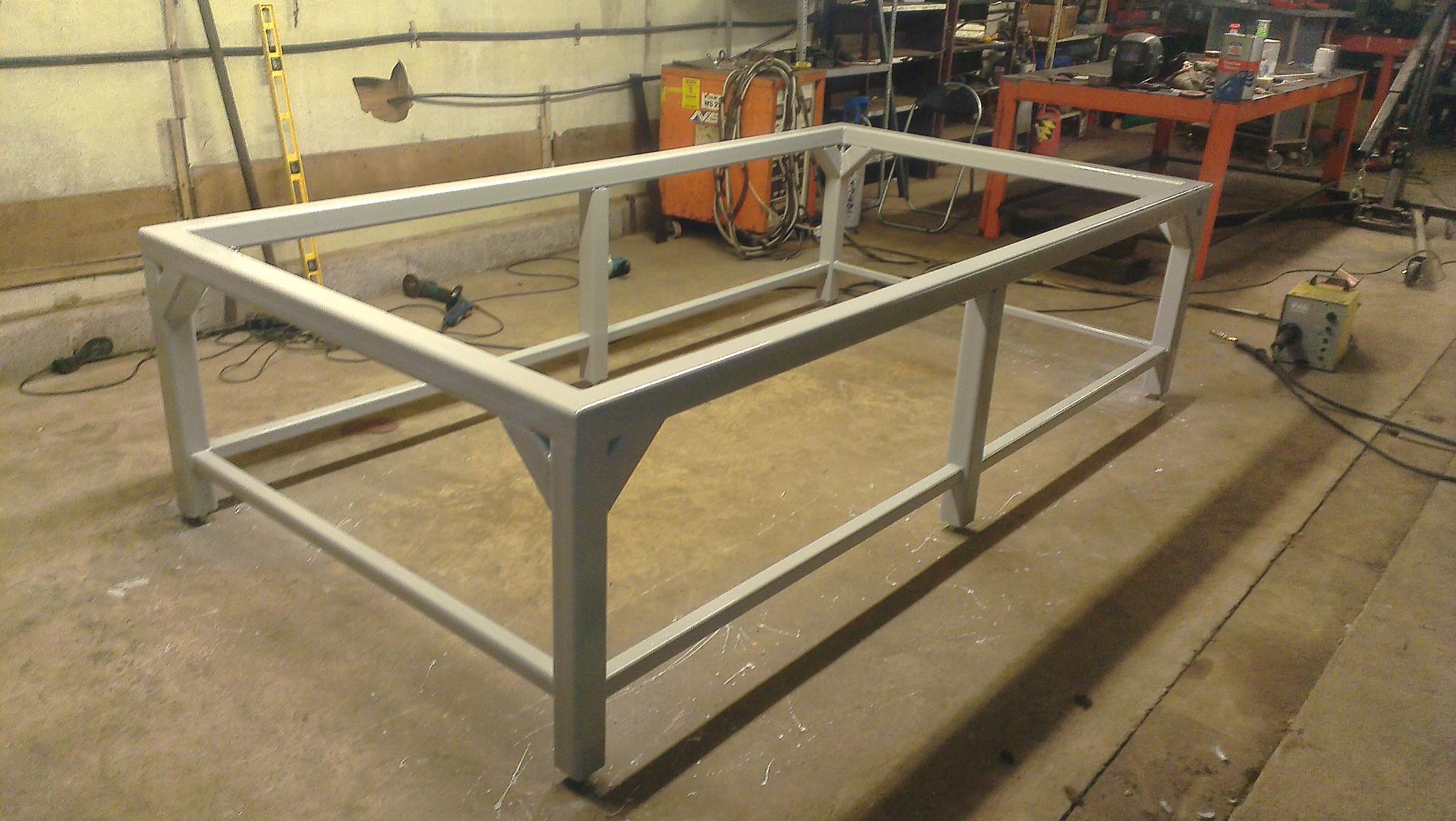

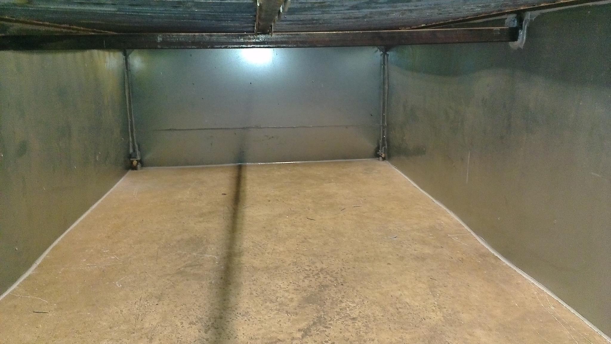

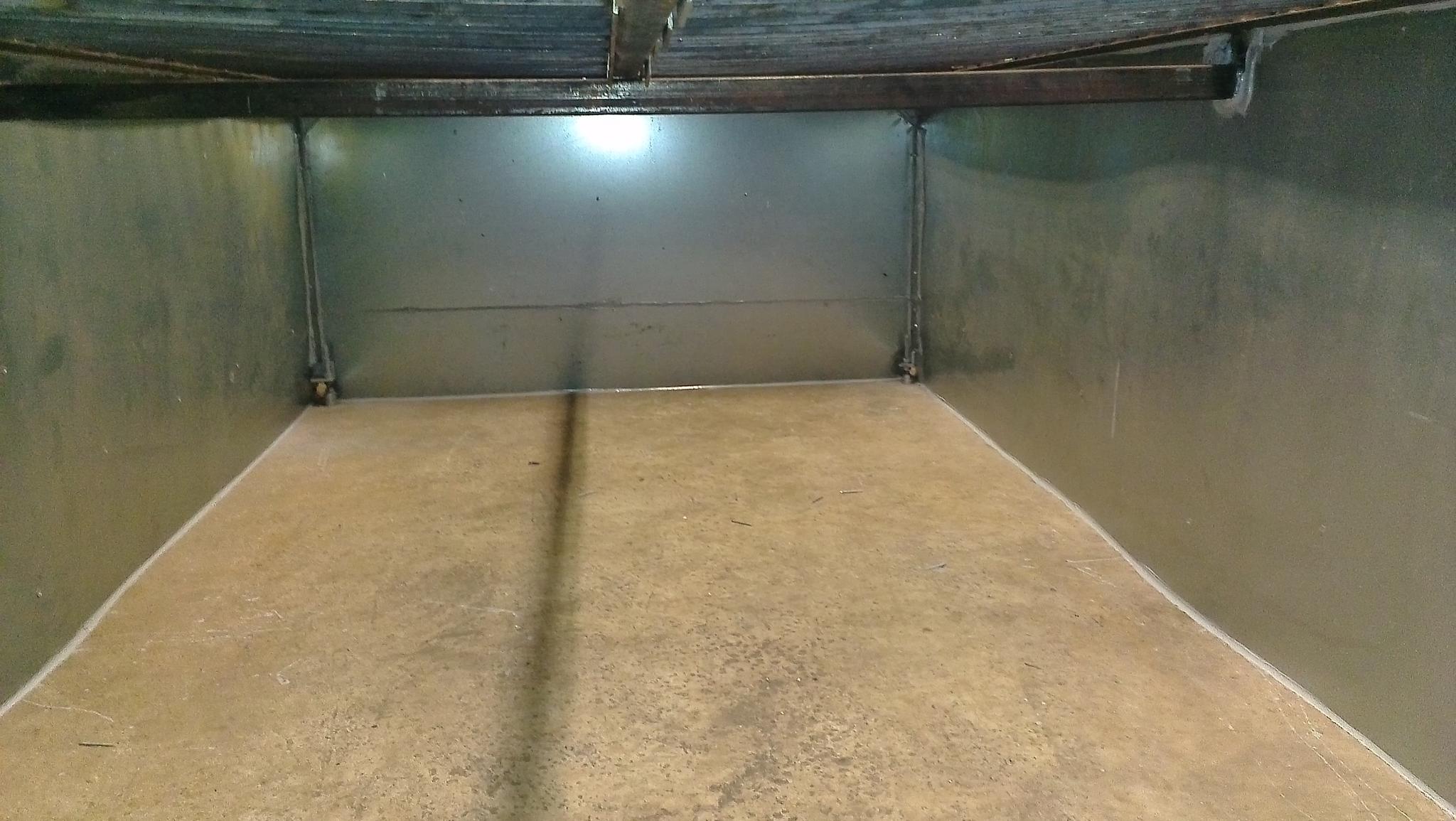

    ok to start...this is going to be picture heavy!..anything you see here is how iv done it and it doesnt mean its the right way.....
    A year or so ago id seen a few videos on youtube and thought id really love to have a cnc plasma table.....
    i had a look on the internet and most seemed mega expensive and made out of pressed tin...
    i decided id build my own table to be able to cut an 8x4 sheet of 12mm mild steel.....I HAVE NEVER HAD ANYTHING TO DO WITH CNC EVER,

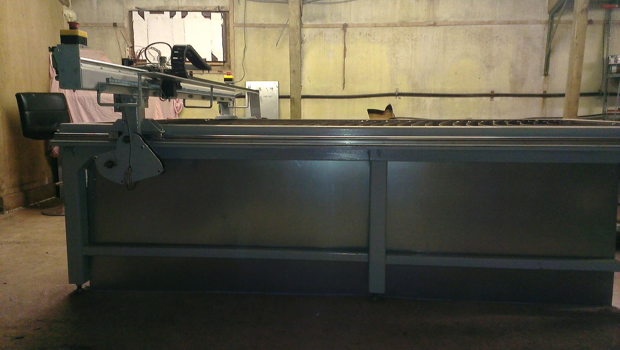

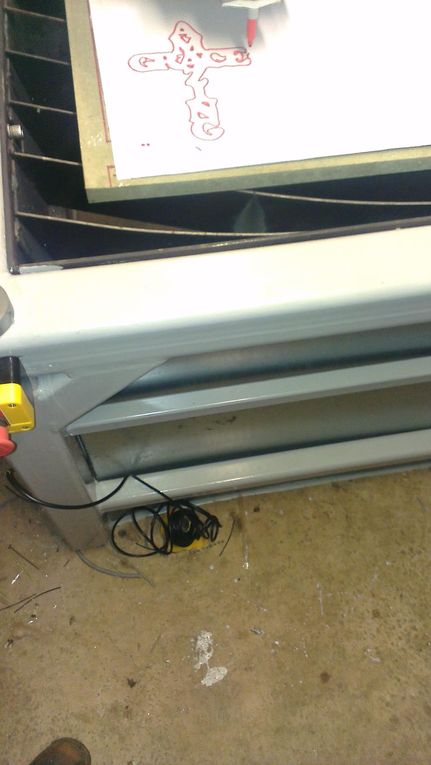

    the table is fabricated out of 80x80x6 mild steel box...a few photos of the table
    a huge thankyou to julian

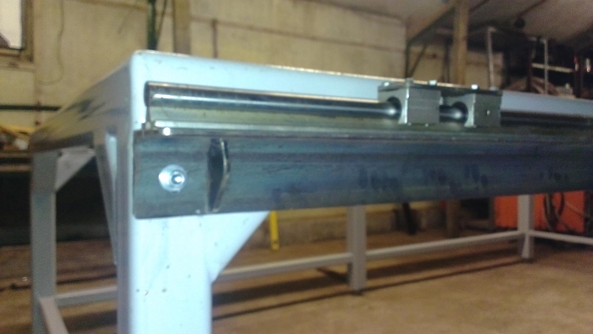

    after welding the table up i mounted some 80x80x6 angle to the side making the base for my y axis 16mm linear rails..i drilled and tapped the three legs of the table and then slotted the angle iron so i had plenty of adjustmentClick image for larger version.

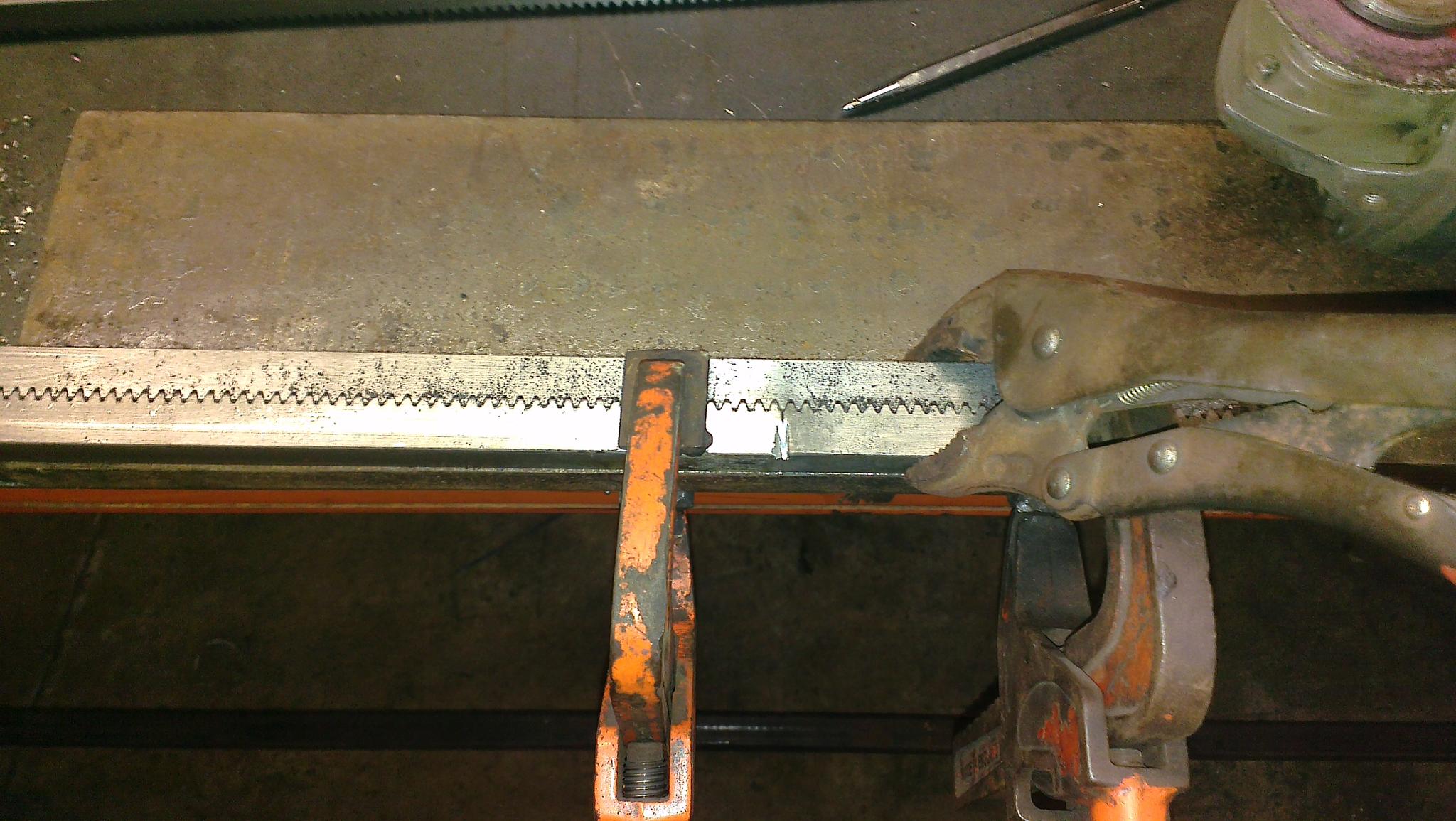

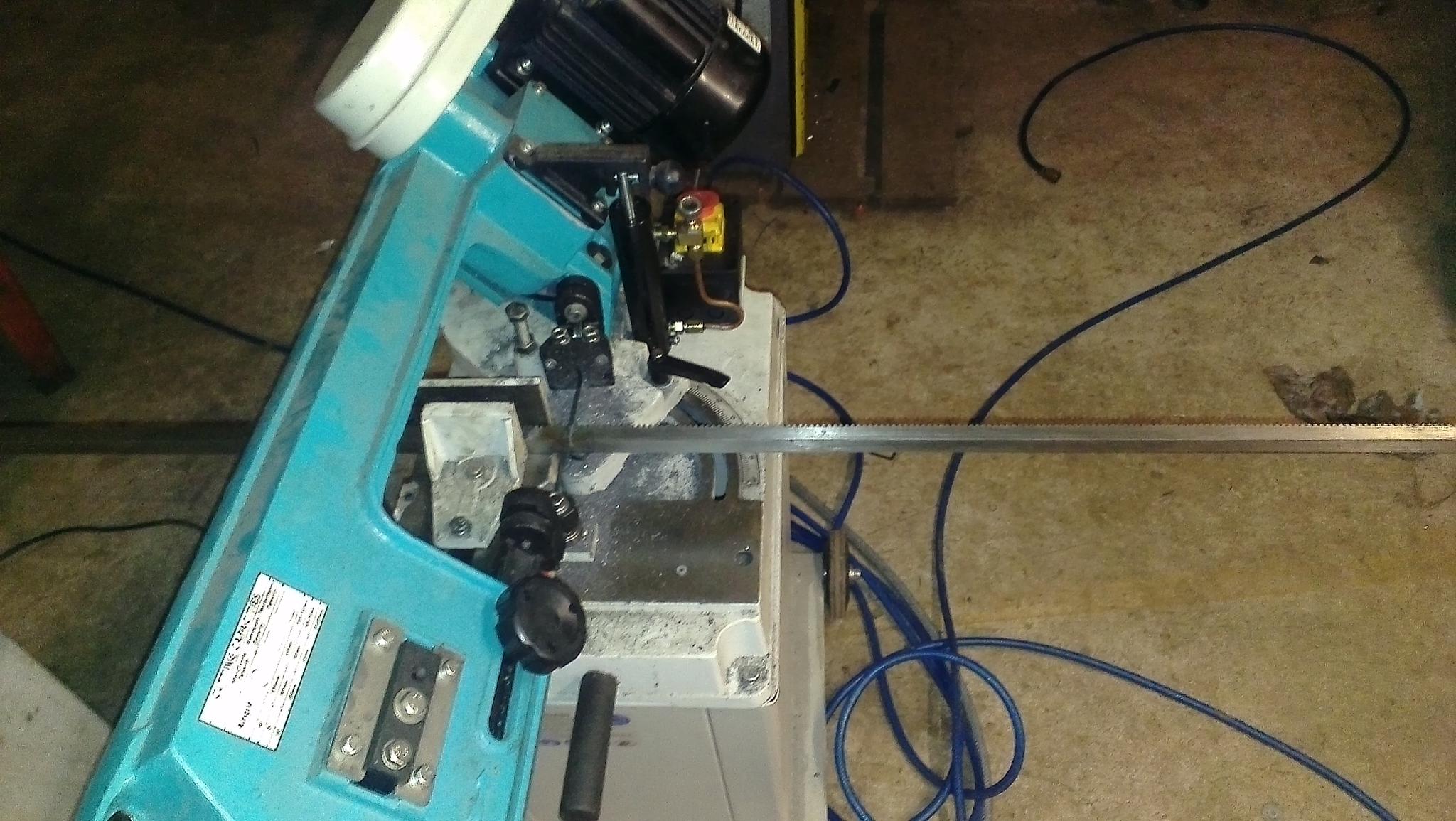

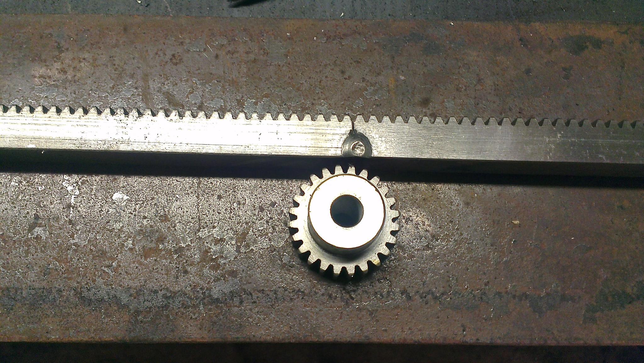

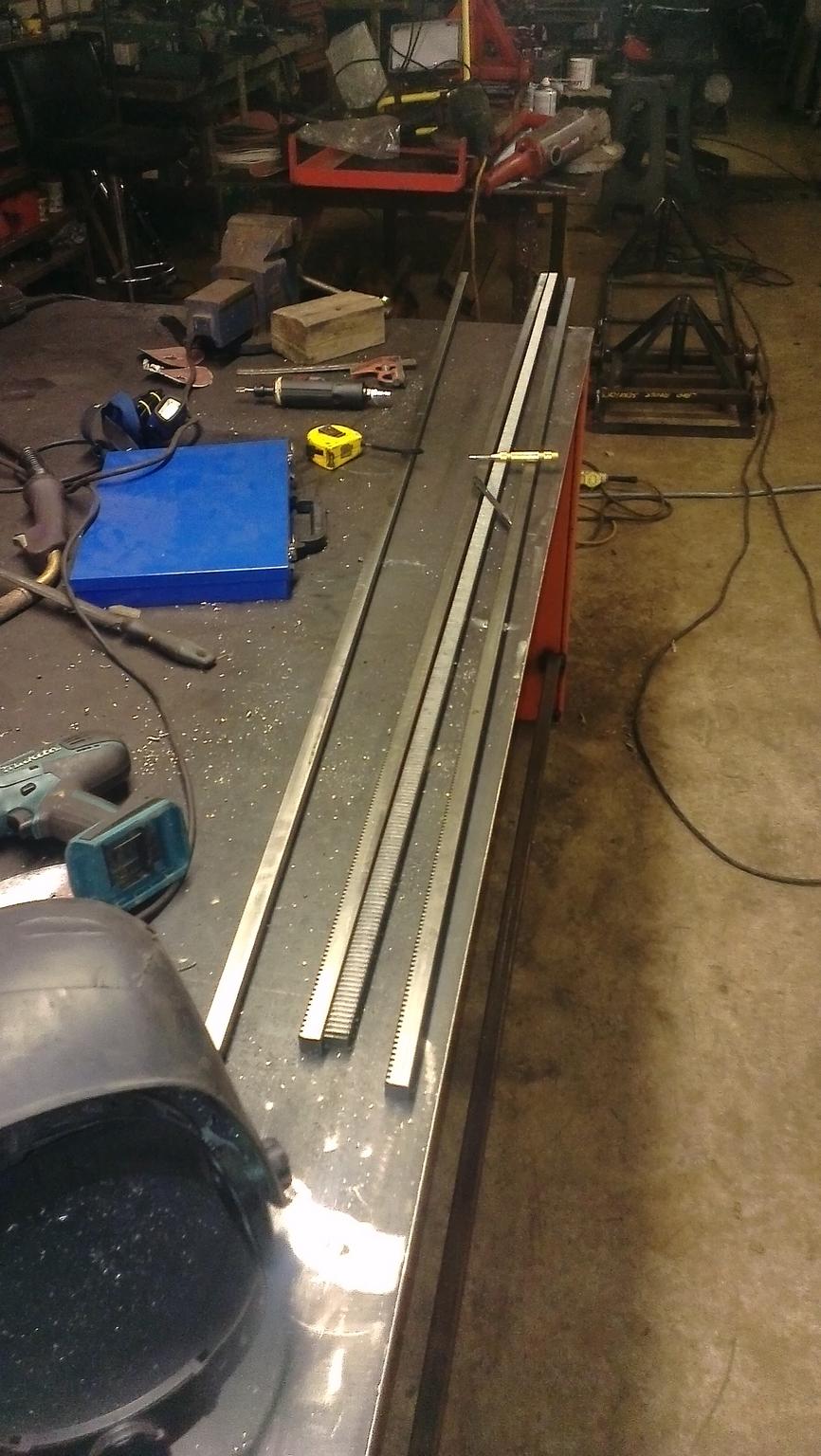

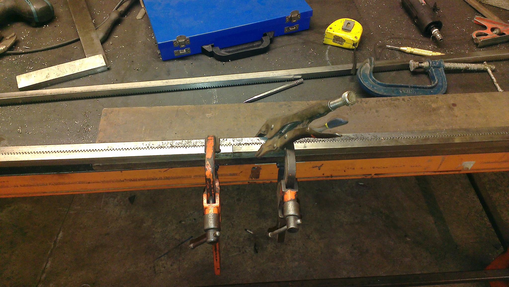

    next i needed to drive the y axis so after alot of advice i opted for rack and pinion,it came in 2m lengths and i needed two 3m pieces... (lee roberts look away for the next few photos )

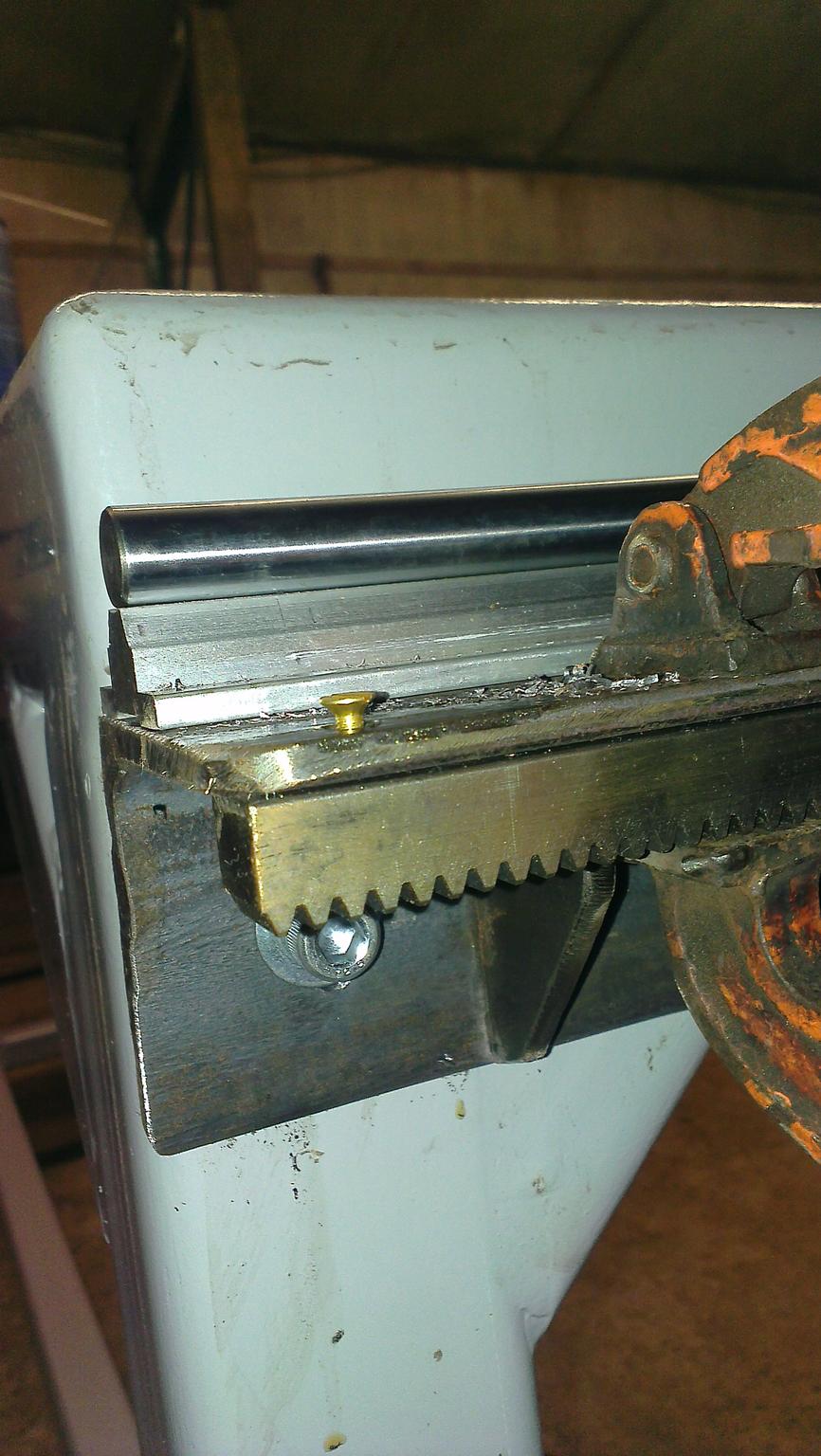

    now having two pieces of 3m rack i needed to attach it to the y axis angle iron i used 4mm counter sunk brass machine screws..iv used these as it was 10pm and thats all i had in the shed.....Click image for larger version.

    How clever are you? Do you actually need any help? Here is a bunch of stuff, feel free to tell me where to go if I am teaching granny to suck eggs.
    Joining two bits of racking is easy, you just put a third piece on top an it gives you the perfect spacing while you nut up.
    You want to cut 12mm steel, is that a specific job of a theoretical maximum?
    An 8 x 4 sheet of 12mm is a fearsome thing. If you are actually going to be slicing 2mm while planning for 12mm, maybe you want a smaller, less vigorous torch to start with, or have you already been on CNC Zone and been convinced HyperTherm is the only option?
    Possibly not because you don't have a monster water bed
    It might be too late to mention that you do not need huge motors because there are no cutting forces. The only thing you have to push against is the weight of metal in the gantry when you reach a pointy corner. Weight is your enemy.
    If you start using the same motor to lift the torch as you use to move the gantry expect derision.

    iv never even seen r&p until a friend showed me what to order,so yes clamping a piece to the two parts that need joining to get distance right is easy aslong as someone tells you the method of doing it...my original question re.welding rack ...was can i tack it to the frame rather then drill and tapping,its a part that has a sprung loaded gear pushing into it so didnt see any issue??...

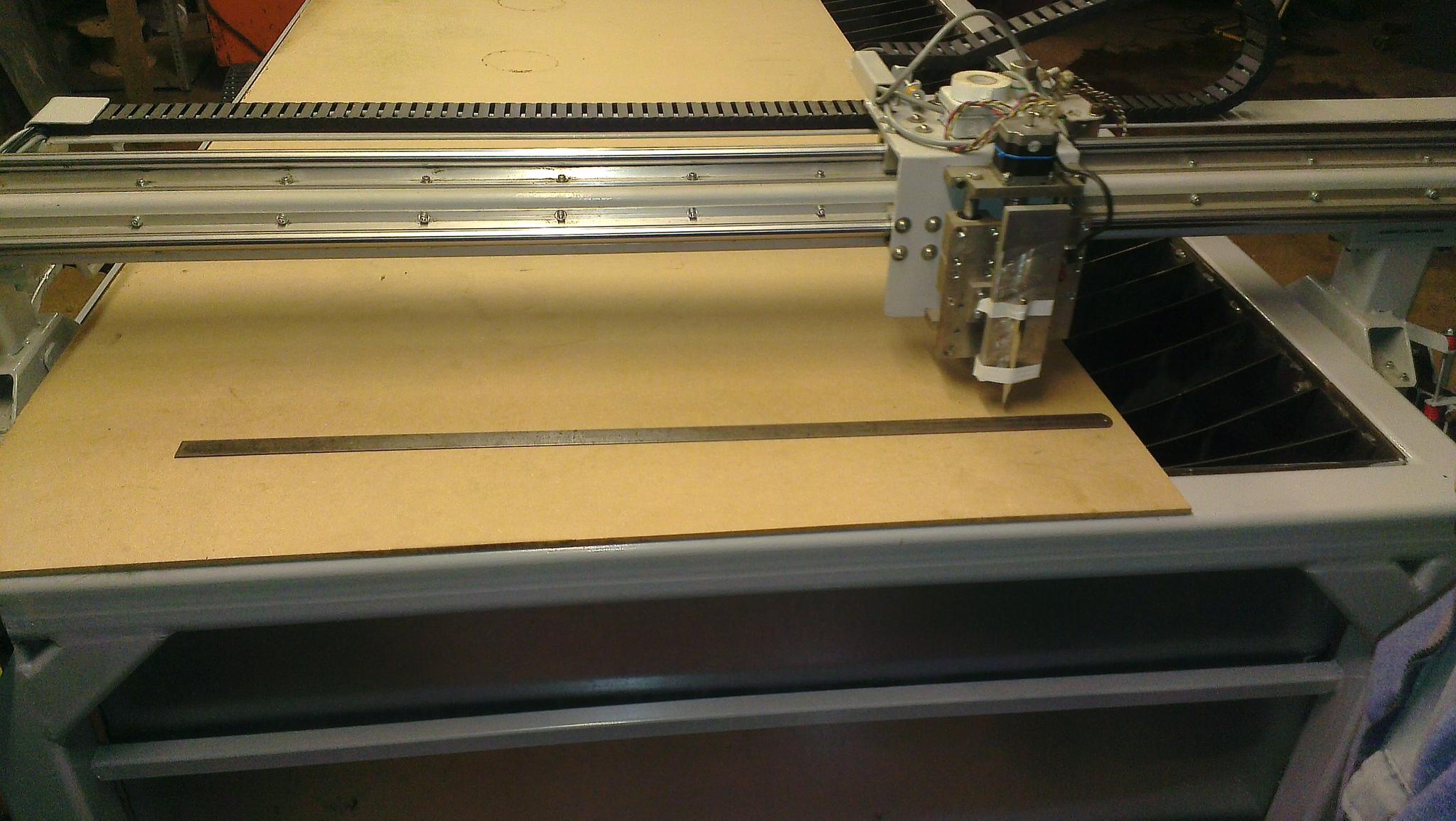

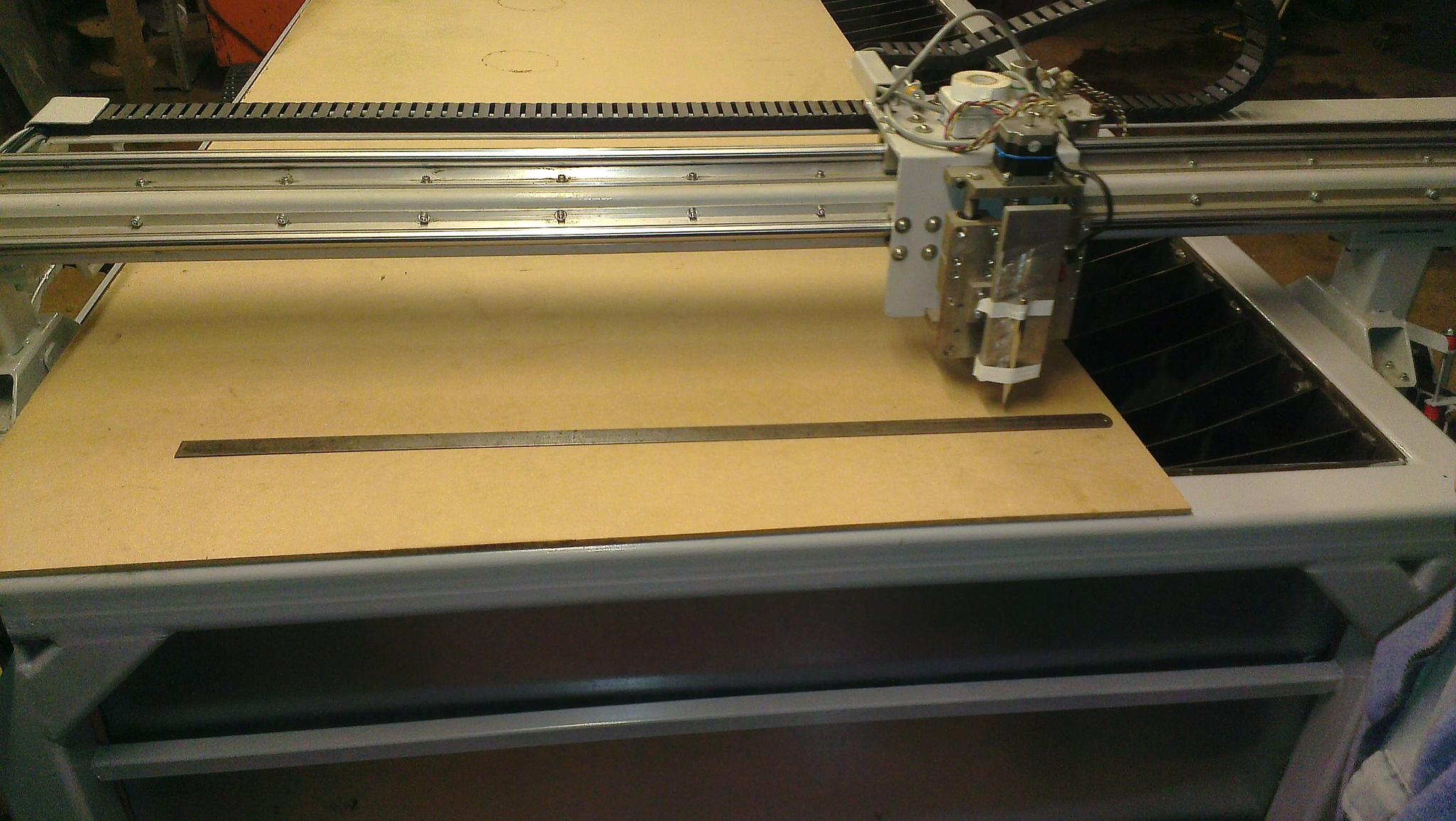

    next part of the build is the x axis gantry..what are the best options for a gantry???iv got some 20mm supported rail and 2m of r&p
    thanks in advance for your help..........
    Looking smart.
    Looking smart.
    thanks lee.
    iv got a bit of time,so hopefully this is the last big push to getting it finished
    only managed a few hours in the shed today...managed to mount the linear rails to the x axis gantry....lots of m5 tapping
