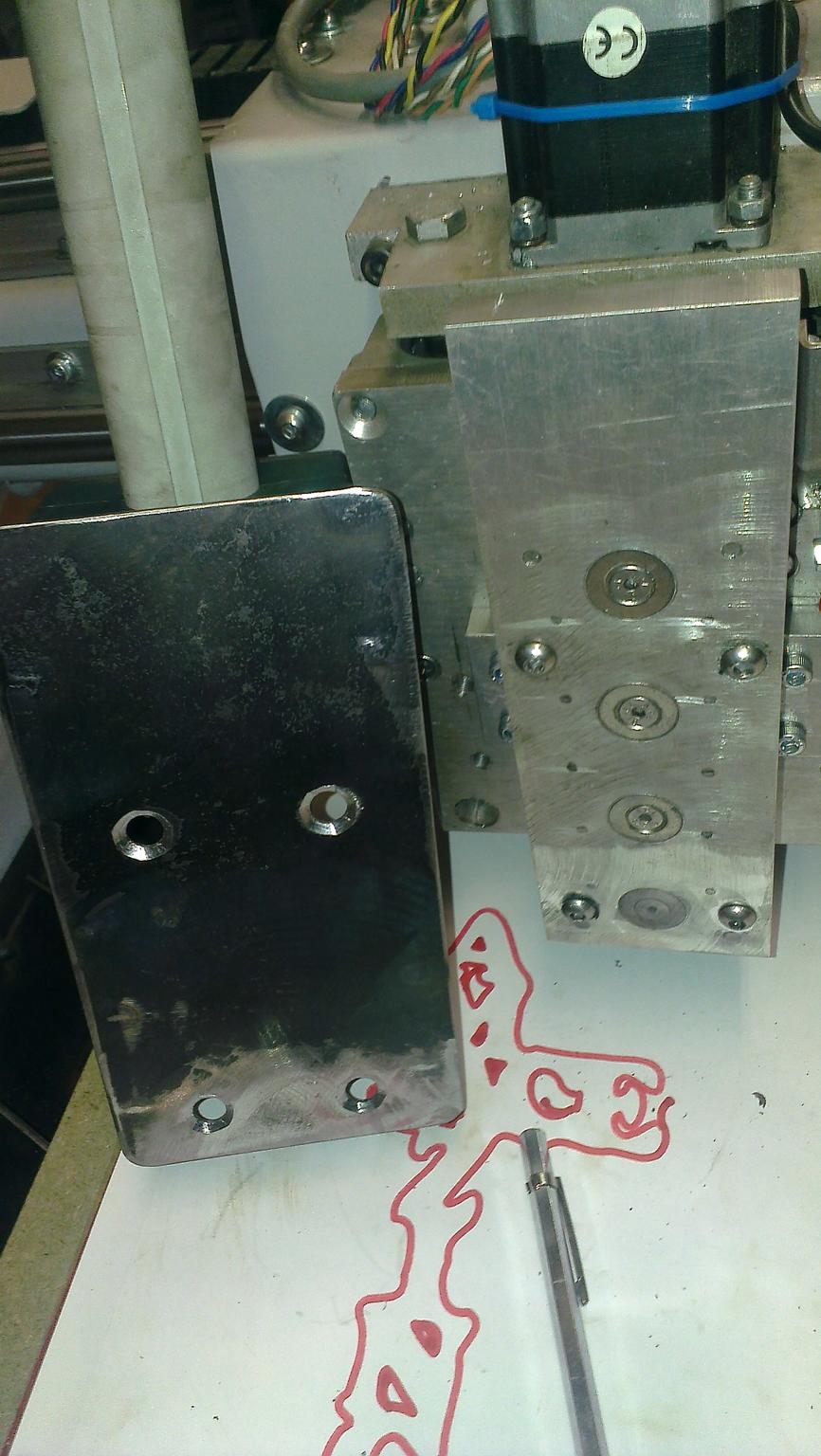

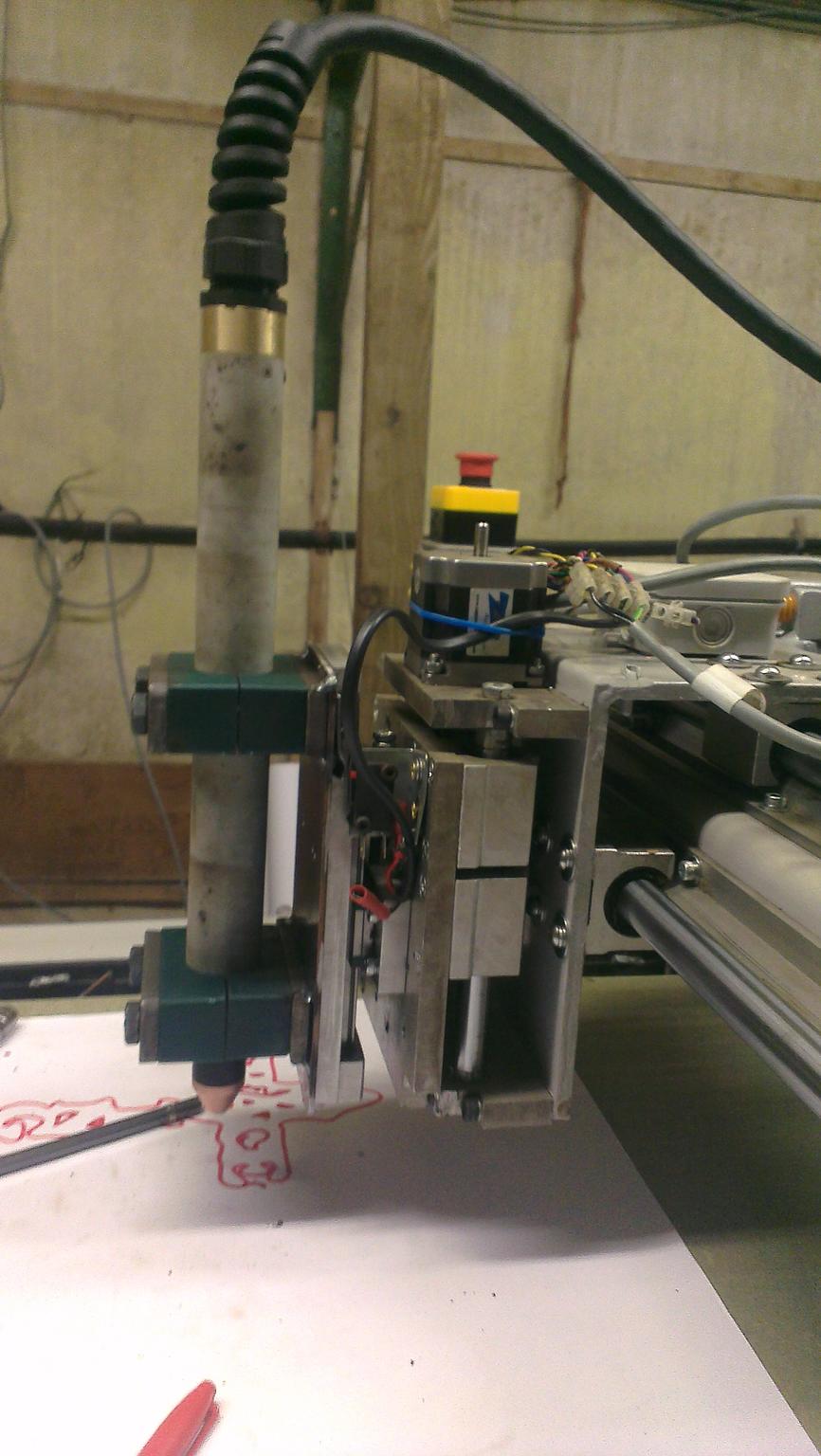

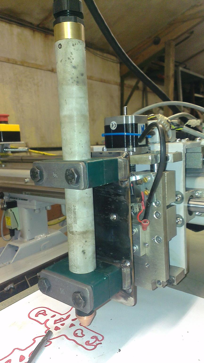

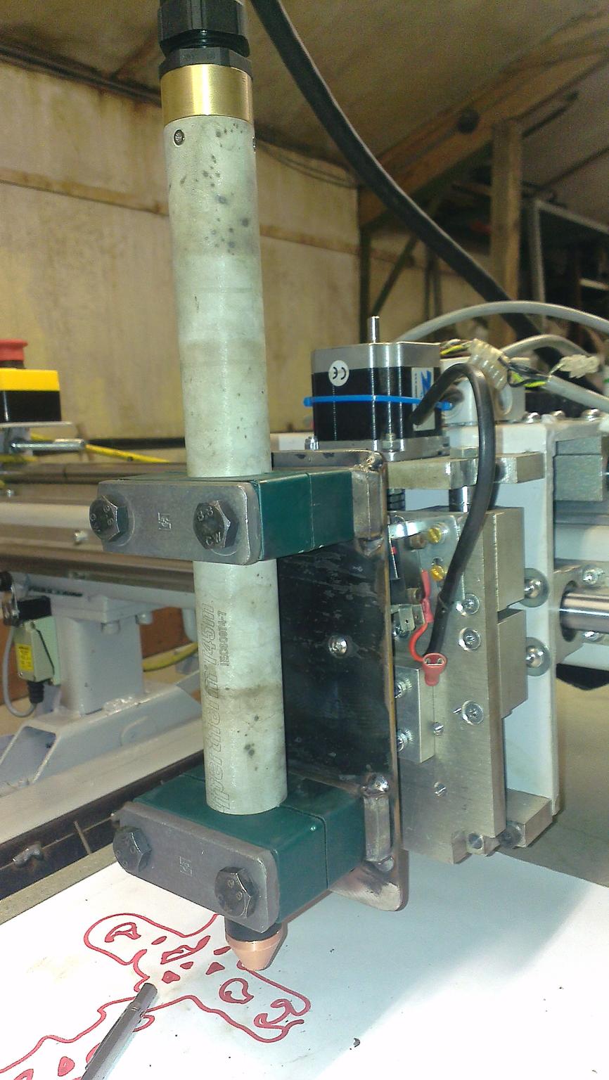

    finally tracked down a machine torch and have got it mounted..iv used four magnets and a few domed head bolts

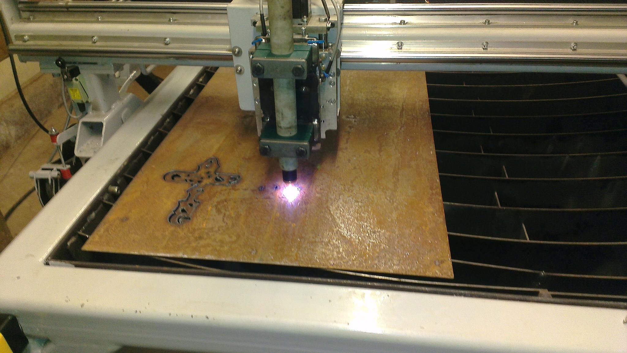

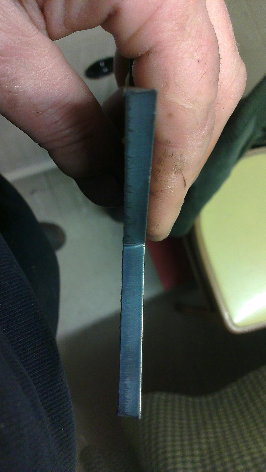

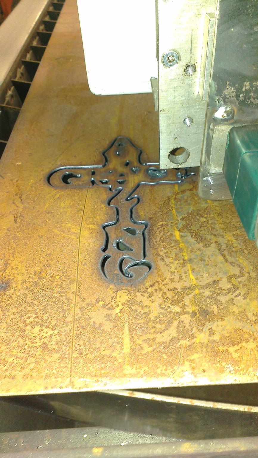

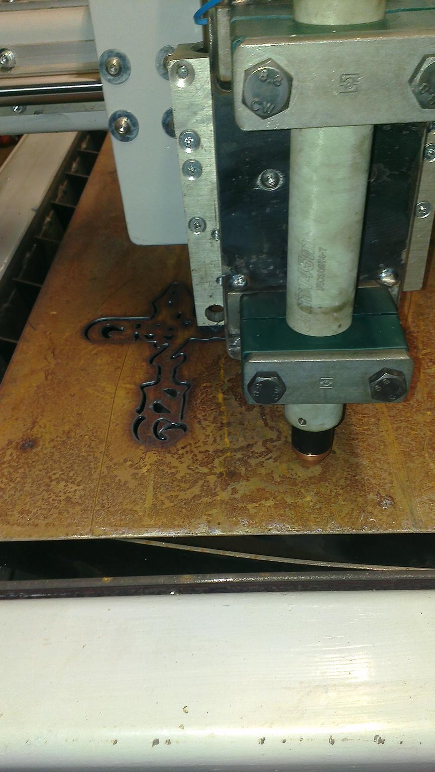

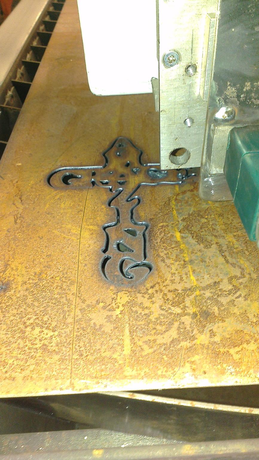

    what a frustrating day!!!!! the dam thing wont recognise the probe for setting the hieght of the material...i did a test cut with no earths connected and to be fare it did cut quite well....heres a few pics of the cutting.........Click image for larger version.

    clive iv tried to upload a video to photobucket and its not having it , i'll try to get a better video......

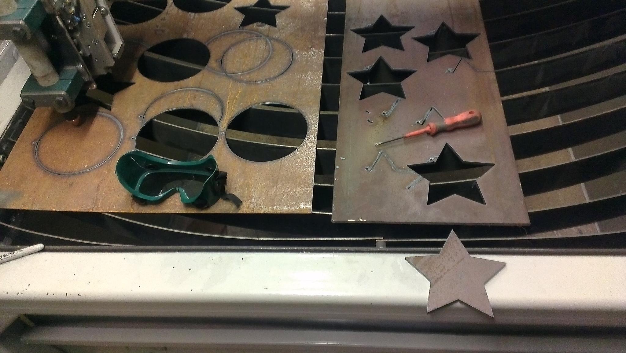

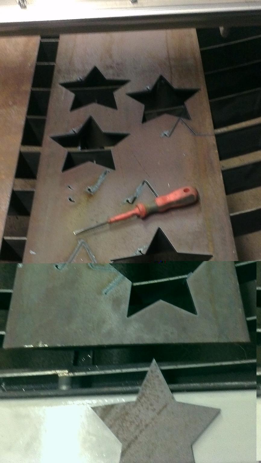

    problems to solve.....
    need macro for g31 touch off probe.........
    mach3 is mega unstable and keeps freezing and not responding to the keyboard?? in plasma set.............works ok in mill set...ish
    proma thc cutting 3mm higher than it should be......

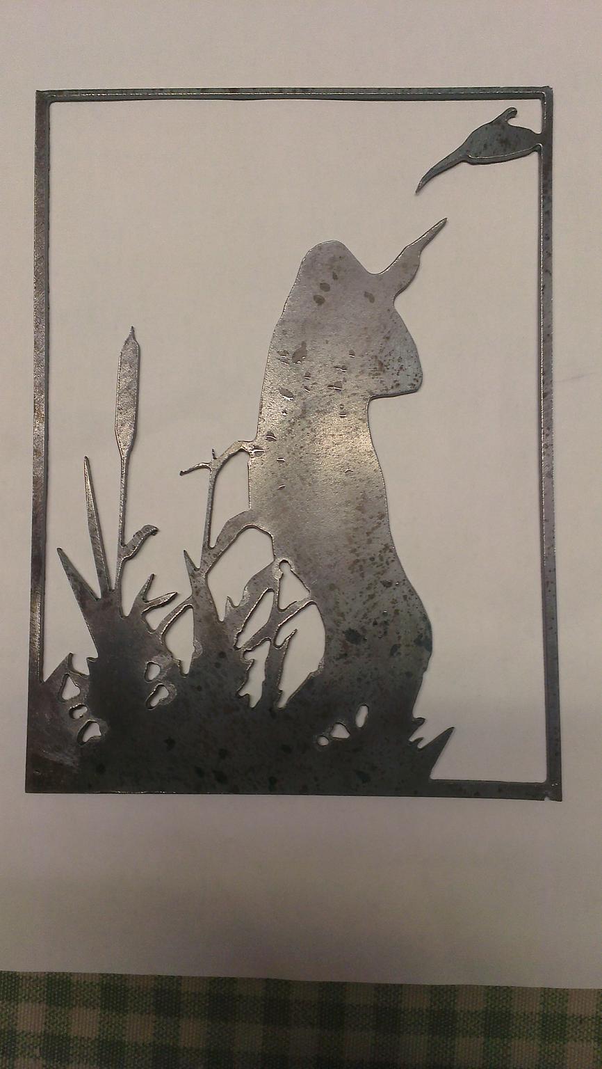

    soft limits stopped working saturday,but has decided to work today....

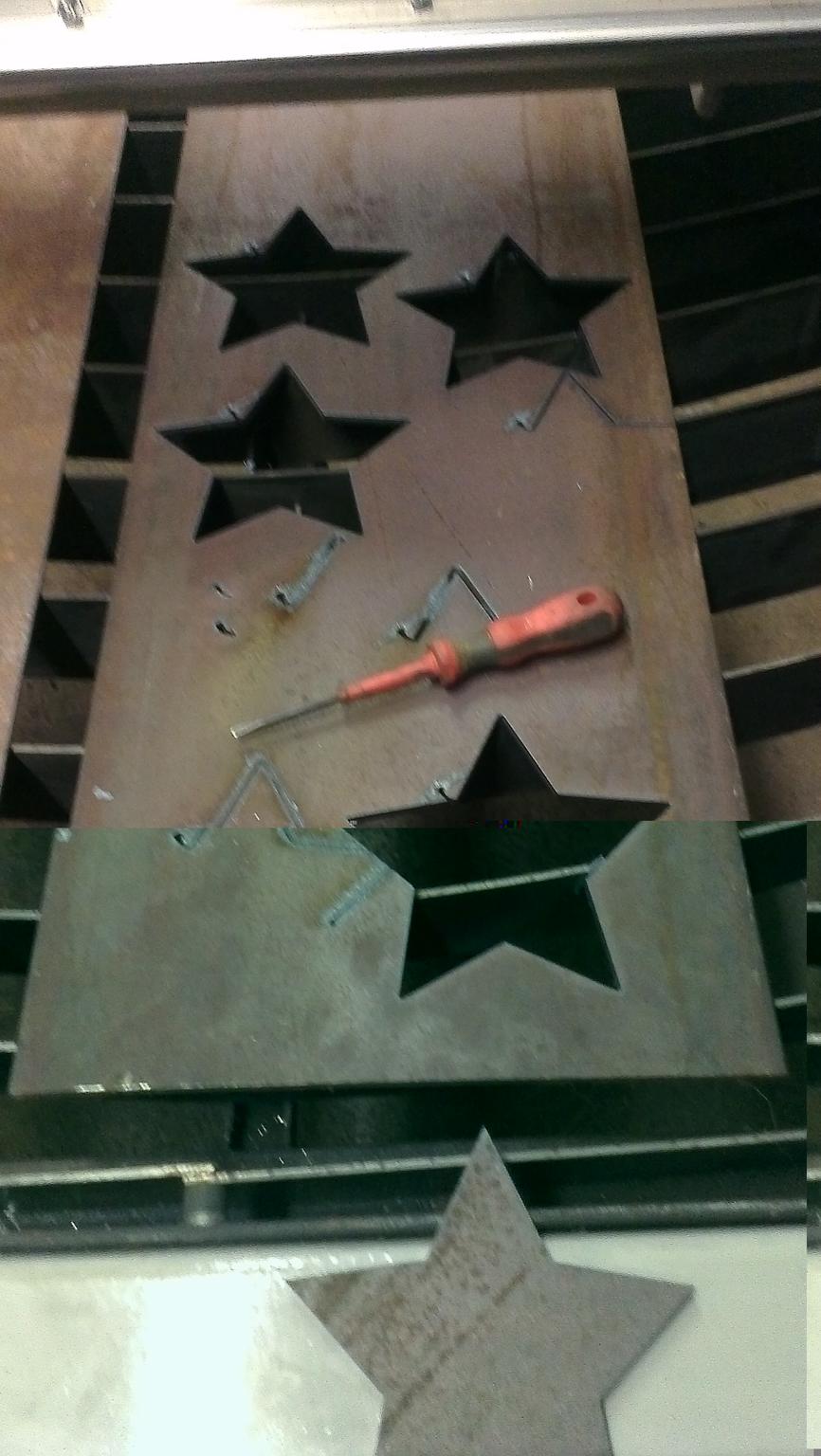

    heres a few pics of some stars in 8mm mild steel..havent cleaned and dross off.......

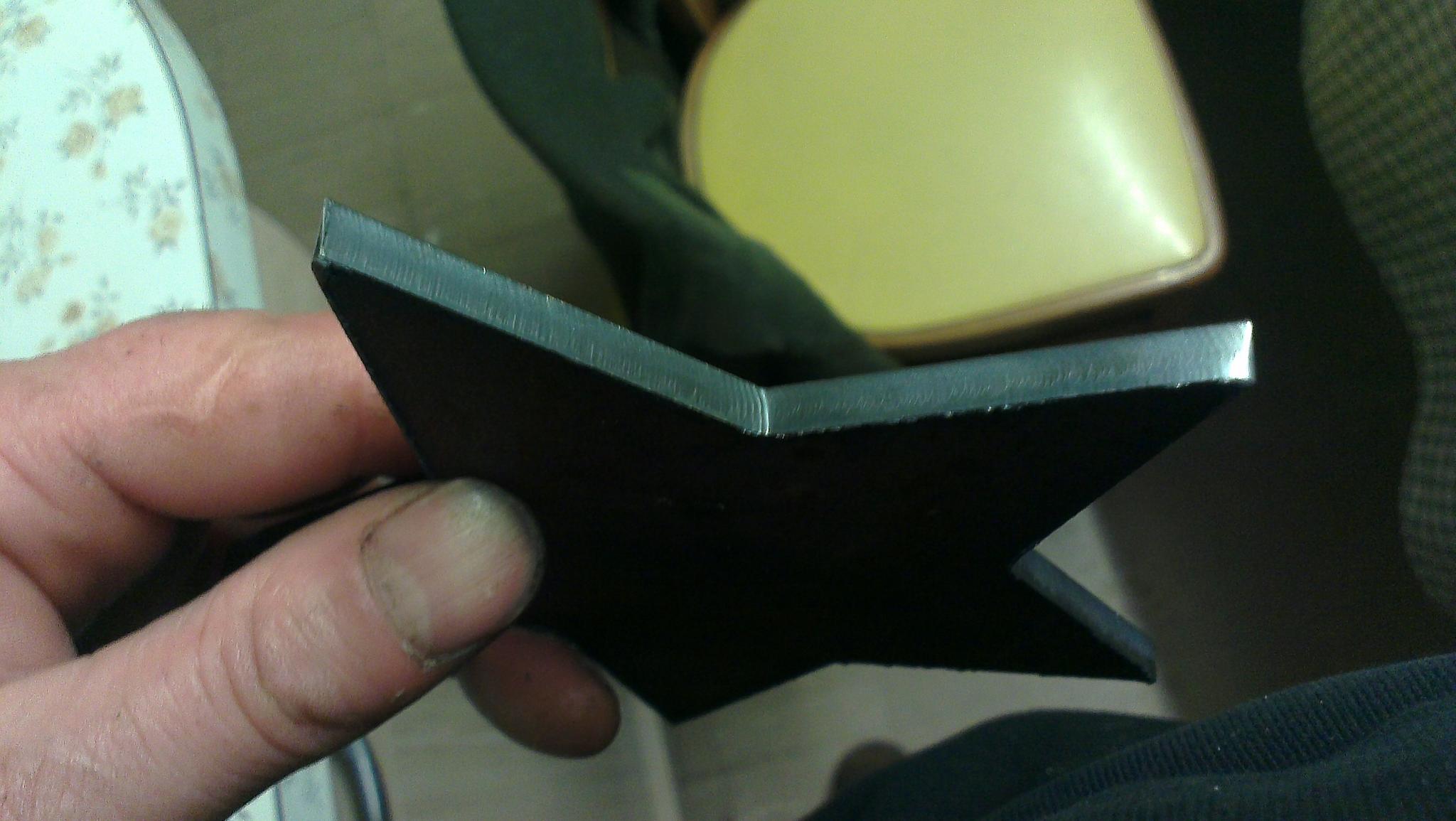

    a pic of getting to know how the machine cuts.....Click image for larger version.
